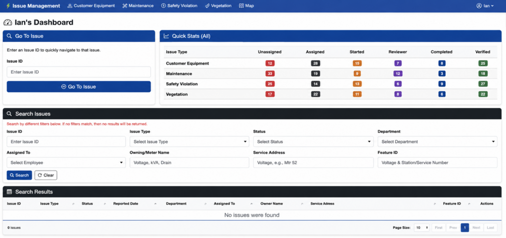

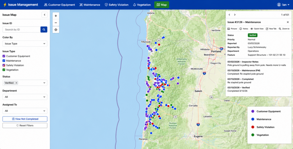

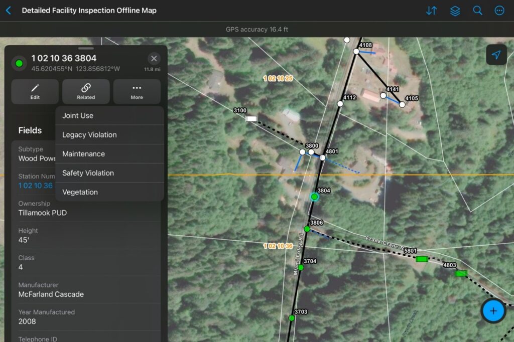

To address these challenges, Tillamook PUD designed and developed the Issue Management System, a custom web application, over a six- to seven-month period. The system integrated ArcGIS Online and ArcGIS Field Maps with related tables into a unified operational platform. The application includes an interactive web map built with the ArcGIS Maps SDK for JavaScript, where staff can filter issues and see them color-coded by type, status, or assignment, open full details and history, and act on them directly. It also connects to the utility’s existing engineering and service order systems. The system organizes issues into four primary categories: customer equipment, maintenance, safety violations, and vegetation management. Using an advanced configuration of ArcGIS Field Maps, the field inspector can capture issues offline, document inspection details, attach photos, and route assignments directly to engineering, operations, or vegetation management teams. Mobile map areas and feature templates are preconfigured in Field Maps Designer, so staff use standardized offline datasets in remote areas and can quickly capture recurring issue types in the field. As issues are identified in the field, integrations built with the ArcGIS API for Python automatically synchronize the information into the centralized web application, where staff review assignments, monitor status, manage workflows, and track issue completion across departments. The application also allows the field inspector to update infrastructure information, verify attachments, and maintain detailed records tied to utility assets and locations.
“The feature templates save me a lot of time. For the issues I document over and over, I can capture a complete, consistent record in the field in just a few taps.” –  Lucy Schiminesky, Field Inspector at Tillamook PUD

The Issue Management web application captures and summarizes issues.

The Field Inspector captures issues using ArcGIS Field Maps.

Issues are filterable and color-coded by type, status, or assignment on the interactive web map.

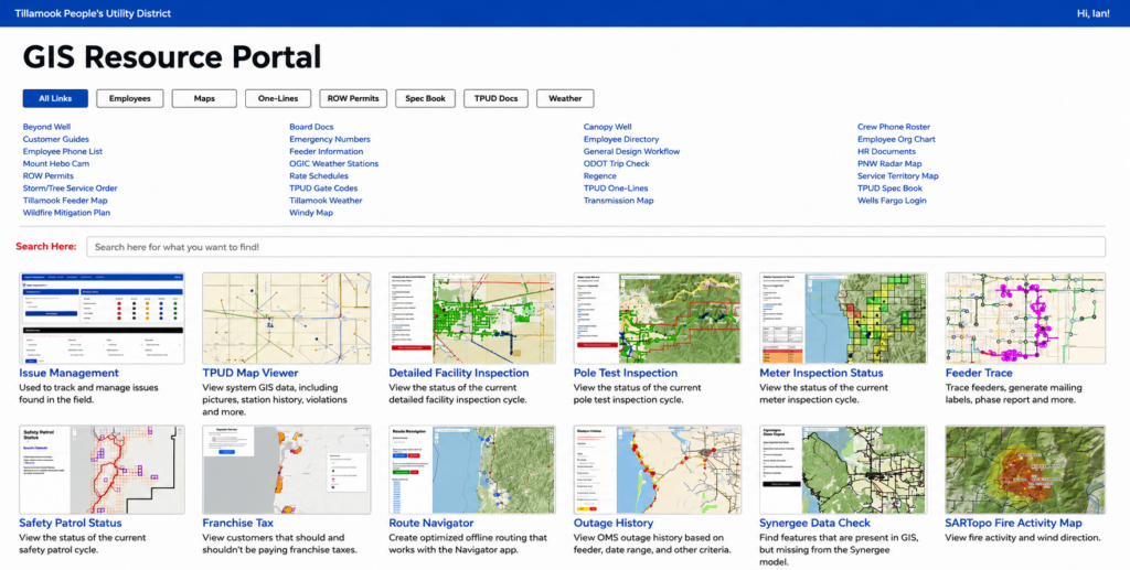

TPUD’s internal GIS Resource Portal facilitates teamwork and transparency.
