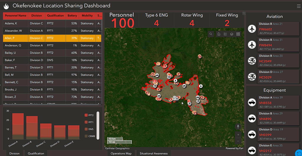

Through ArcGIS Velocity, not only do we get firefighter locations in ArcGIS Online, but we also can enrich the location data, enabling us to set up geofencing and sort firefighters by specific attributes like their qualification level. This means that I can search for a specific division/group supervisor, crew boss, engine boss, or any other qualification level as needed. If I want to visualize the locations of all the resources within a specific division on an incident, there’s a filter for that, too.  As each firefighter, piece of equipment, or aircraft moves across the fire area, their location automatically (through geofencing, not magic) updates with the Division in which they’re located. This increases our situational awareness in traditionally disconnected environments. No longer are we bound by the constraints of cellular networks.
Here is a quick look at what combining firefighter location feeds, other feeds like AVL, ADS-B, firefighter location, etc., data and geofencing by Division could look like within an ArcGIS Dashboard:
