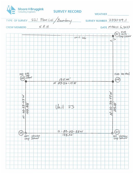

Scanned field notes are added as an attachment to a project feature in GIS

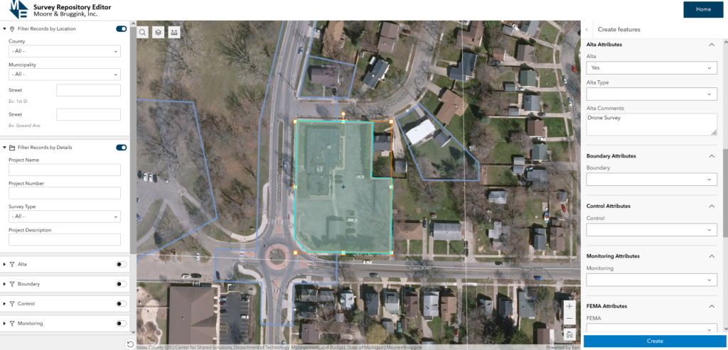

  • ALTA Survey Integration: For American Land Title Association (ALTA) surveys, a specialized process was developed to automate data entry and maintain consistency. Data is automatically populated based on the polygon’s location. This applies to other project types as well. A form was configured in the web map, and conditional display (using ArcGIS Arcade) was applied to each project type for data entry. Once a project type is selected (such as an ALTA survey), then the appropriate fields will display with proper domains in place. This streamlines data entry.

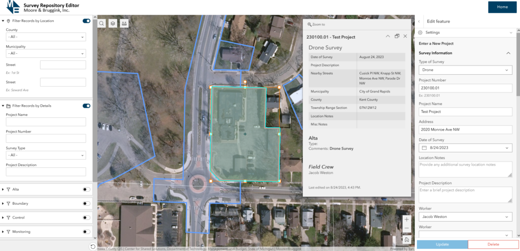

Navigating to project area to enter new project. Left side of screen shows filters possible to narrow down search. Right side shows editing with the option to enter a new Survey Record.

Entering specific project information regarding an ALTA Survey. Conditional field display configured in web map keeps the form tidy and only shows selected project fields.
Demonstration of popup. Project information is visible along with location-based attributes that were automatically populated.
