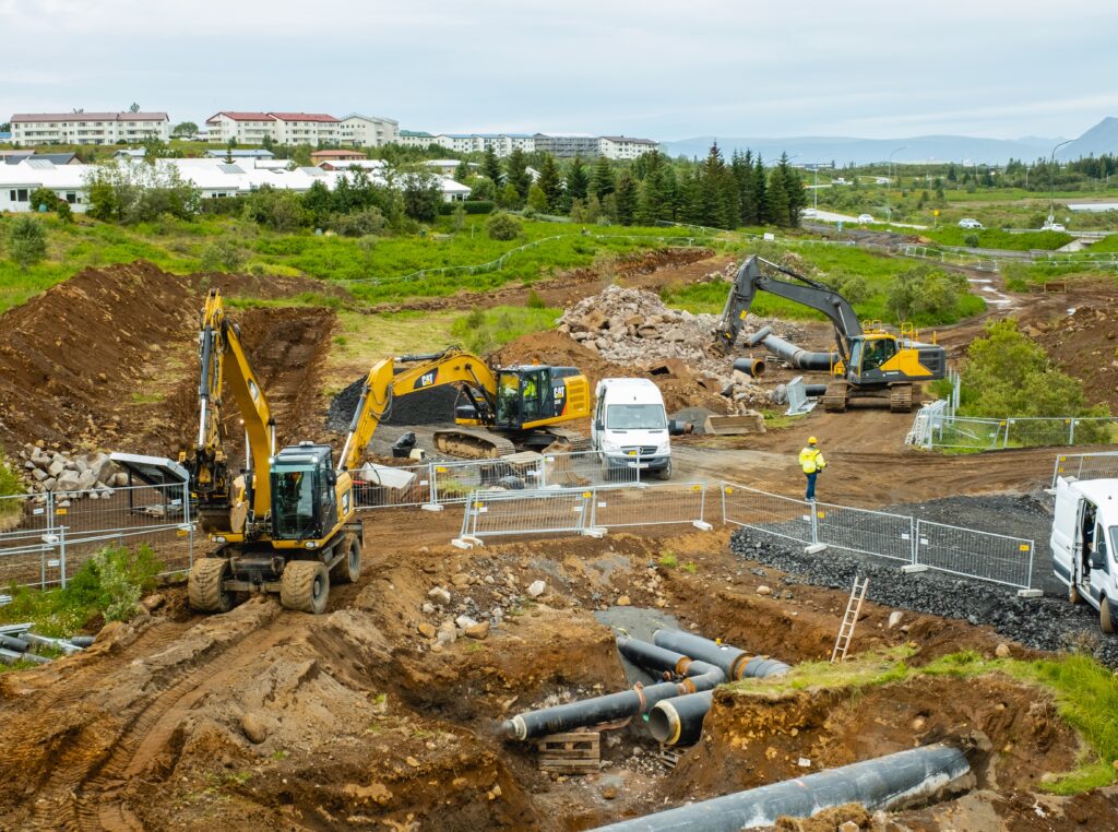

Veitur crews working in the field.

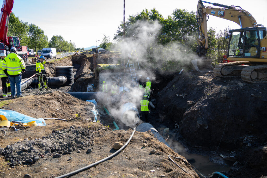

The team used ArcGIS Field Maps to inspect and document 7,700 street cabinets, integrating real-time field data into the GIS database. ArcGIS Dashboards provided live progress tracking, enabling managers to monitor the inspection and redrawing of assets directly within the platform. New substations are now designed natively in GIS, ensuring positional accuracy from the outset.

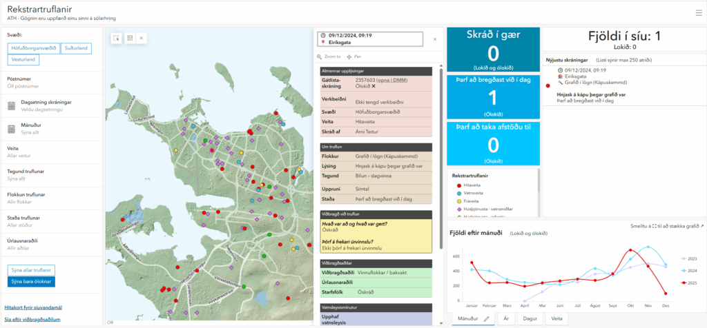

One integration enables users to transition seamlessly between systems. “A broken asset is selected in the GIS, the work order system appears, the form is filled out, and the information is now accessible to the whole organization in a dashboard,” Kjartansson explained. “The user almost doesn’t notice the transition.”
Customer outages and issues are displayed in this dashboard through GIS–work order integration.
Veitur also employs ArcGIS Dashboards and ArcGIS Enterprise Sites for operational oversight and internal communication—displaying valve status, pipe leaks, cable statistics, and project progress in real time. The result is a collaborative digital environment where spatial data drives daily decisions across departments.
