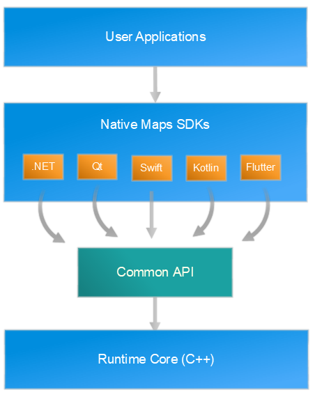

The ArcGIS Maps SDKs for Native Apps share a common core library called runtimecore, which unifies behavior across Software Development Kits (SDKs) and devices. That shared core lets us deliver consistent capabilities, but it also brings distinct testing challenges: ensuring rendering accuracy across GPUs and graphics APIs, validating workflows on diverse devices and DPIs, and catching regressions early in a stack that isn’t itself a user‑facing app.
Native Maps SDKs Architecture
Internal architecture layout of the Native Maps SDKs
Each Native Maps SDK exposes platform‑specific APIs, UI controls, and idioms, but they all call into runtimecore, a shared C++ engine that implements core GIS functionality and rendering. This design helps us test behavior one time at the core instead of multiple times for each SDK. Then we verify integration at each SDK layer.

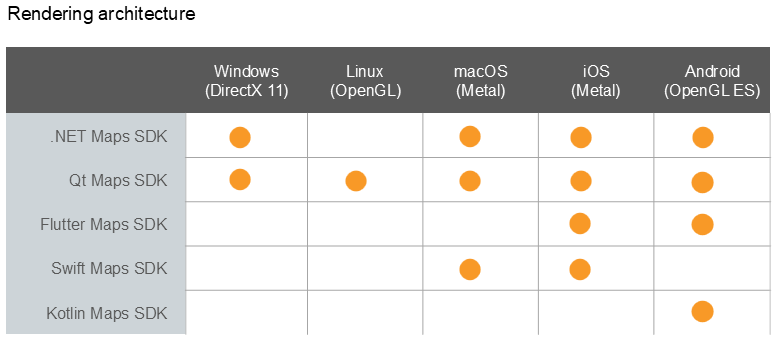

The other key aspect of the various SDKs is that each SDK supports one or many platforms and the rendering architecture on that platform. The table below highlights what platform and rendering architecture each SDK supports.
Platform and rendering architecture support
So, to summarize:
  • SDKs target desktop (Windows, macOS, Linux) and mobile (iOS, Android).
  • Rendering uses the native graphics stack of the platform (e.g., DirectX on Windows, Metal on Apple platforms, OpenGL/ES on some devices).

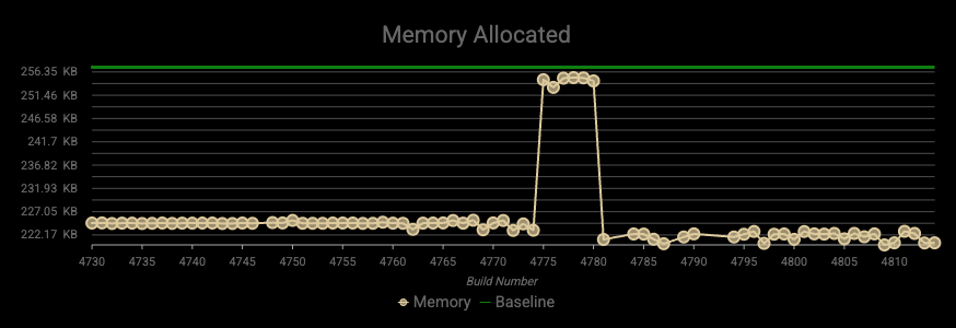

Capturing memory allocation from a performance test. A regression got introduced at around build 4775 but we soon caught and mitigated it as can be seen from the chart above.

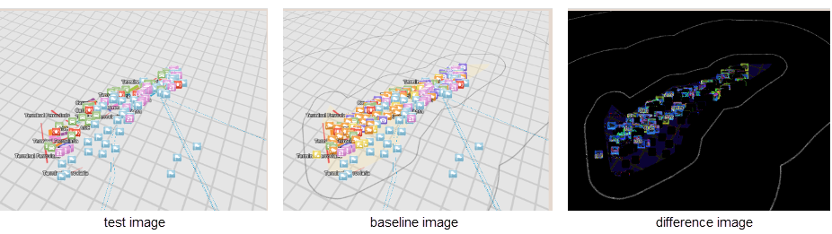

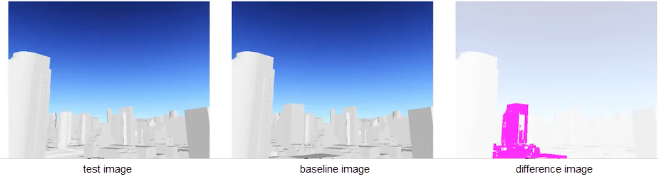

    • Image comparison failures are prioritized because they surface rendering differences (e.g., missing contour lines, color shifts).
Example image comparison failures:
Side‑by‑side baseline vs. test image with a difference highlighting where symbols differ in color or contour lines do not render
Side‑by‑side baseline vs. test image with a difference highlighting where 3D buildings render differently
