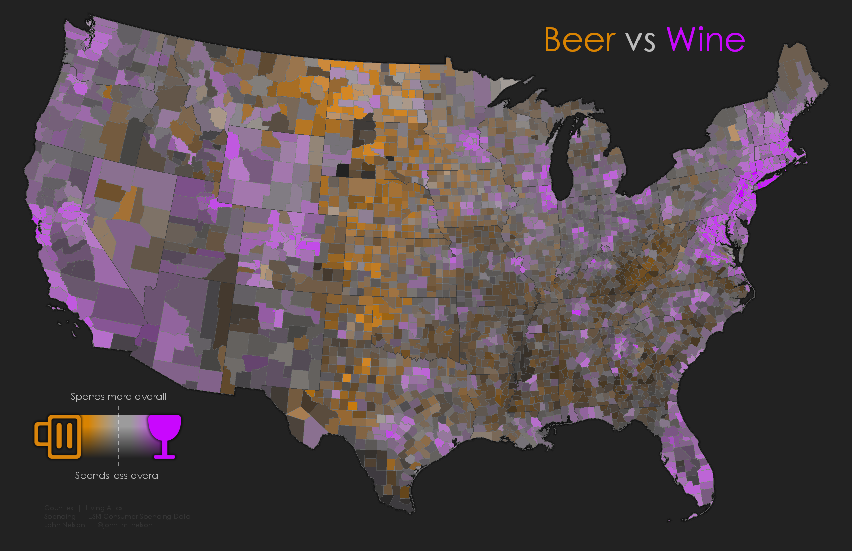

Here is a map of the relative preference of Beer and Wine in US counties. It’s a bivariate map showing 1) a diverging color scheme of orange (strong beer preference) to gray (average comparable preference) to purple (strong wine preference). And atop that is 2) an overlay that suppresses counties that spend less overall, so that higher-booze-spending counties shine through. Here’s how you can make this map, by the way. But I got a lot of questions about the legend…
Now, I’m generally of the opinion that if a map doesn’t need a legend then by all means, don’t give it a legend! But if you must legend a map, there are lots of fun ways to do it. Here is one. It’s a pretty straightforward process, arranging elements in an ArcGIS Pro layout.

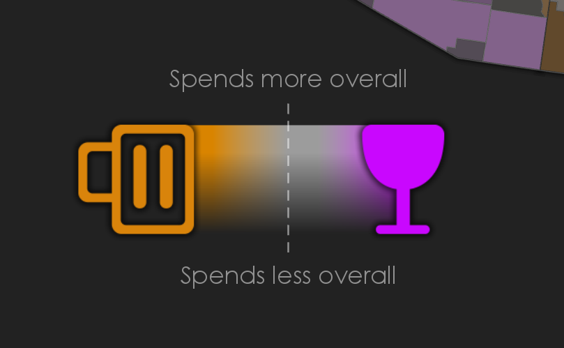

Cool! These two rectangles look like a single three-part gradient spanning image to image (I didn’t use the sneaky saved style trick). Next, I thought it would be nice to add a faint dashed line in the middle, denoting the average. This is just a line, inserted and formatted to be dashed.
The dashed line format looks like this…
But what about the whole “bivariate” nature of this thing? So far, this legend only shows the linear transition from beer preference to wine preference. The map also includes the dimension of overall spending, to help normalize this thing and provide a more nuanced surface of booze spending.
No problem! The map uses a copy of the counties layer that uses the background color and transitions from more opaque in low-spending counties to more transparent in high-spending counties. This way, higher spending colors shine through more while lower spending counties recede. It’s a nice hack -used a lot on election maps to normalize by population.
I just do the same exact thing with the legend. On top of the rectangles that illustrate the color gradient of beer/wine preference, I plop in a rectangle with a vertical (up and down) gradient that transitions from a fully transparent version of the map’s dark gray background color down to fully opaque version of the background color.
Which looks like this…
This, for reference, is what the Layout Contents panel looks like, to provide a sense of the elements and their layering…
So there it is! A hand-crafted fine fine artisanal bespoke legend. Ready to inform and delight your map readers of the rich intricacies of your maps.
