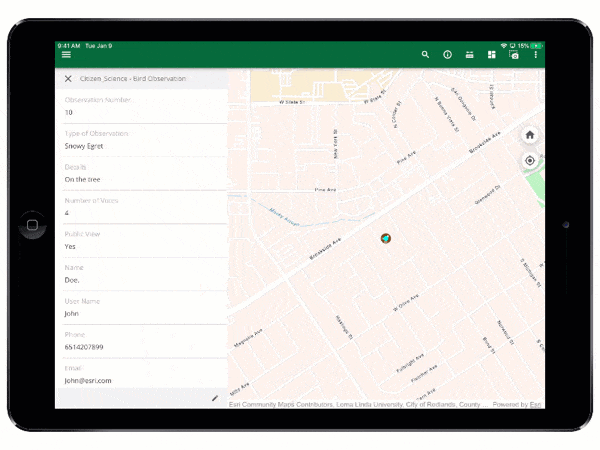

If the editing capability is enabled for the Map Viewer template, you would see a new edit icon on the Identify panel’s bottom-right. Click/Tap on the edit icon to enter the editing mode. From here, you can edit and save changes for feature attributes and add or remove feature attachments.
Map Viewer template editing feature attributes

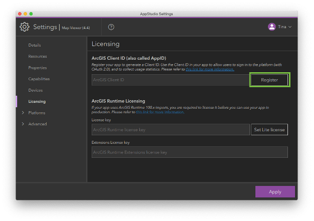

  3. Go to Settings > Licensing and click on Register to register an ArcGIS Client ID that allows users to sign in to your Map Viewer template app.
Register a Client ID in AppStudio Desktop

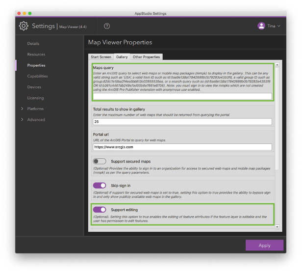

  1. First, enter your web maps in the Settings > Properties > Gallery > Maps query
  2. Scroll down and enable the Support editing
Enter maps query in AppStudio Desktop
