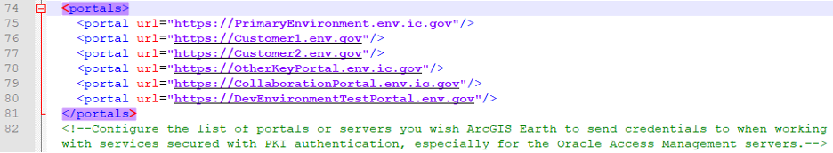

As an Admin, look at the config file (C:\Program Files\ArcGIS\Earth\bin\config.xml) and open it in a text editor. If doing this for the first time, your config.xml will be the vanilla COTS software install. By first creating of copy of the config.xml, and then customizing the interface, administrators can deploy specific portal instances,
Custom Configuration Settings in ArcGIS Earth

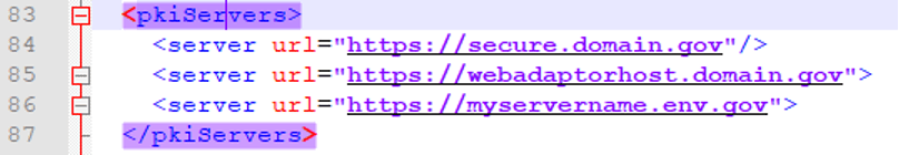

PKI Servers (if using a PKI environment),

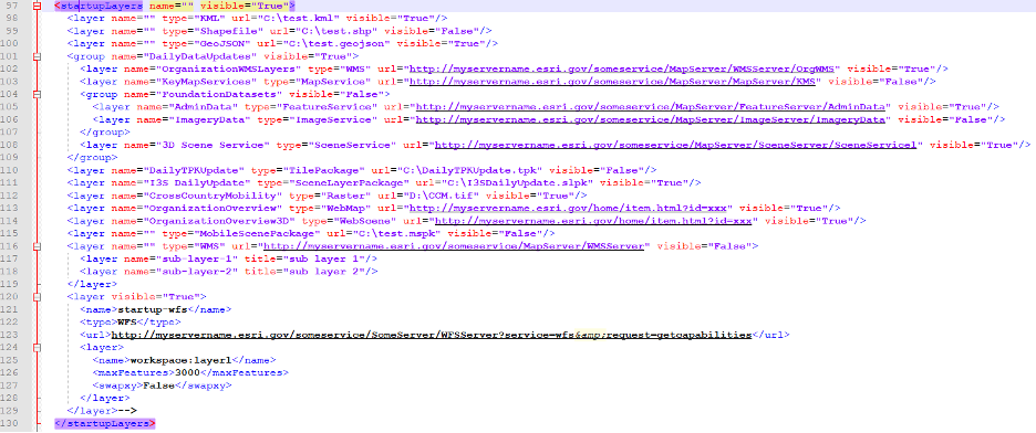

GIS Services,

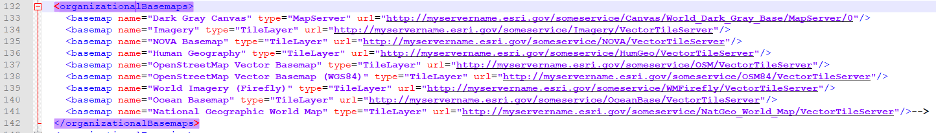

And even specific basemaps for users to have at their fingertips
