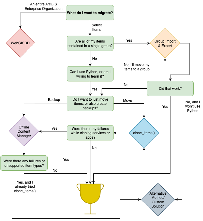

Migration options at a glance
To help illustrate these options a bit more, the flowchart provided below steps through different scenarios and recommendations to migrate your content across ArcGIS Enterprise organizations. For migrations involving an ArcGIS Online organization, the ArcGIS API for Python must be used. To follow the options available for ArcGIS Online, start near the center of the flowchart, in the box that says “Do I want to just move items, or also create backups?” Note that collaborations aren’t included as a workflow in the flowchart as it is intended to highlight migration options (recreating content) as opposed to sharing content.
