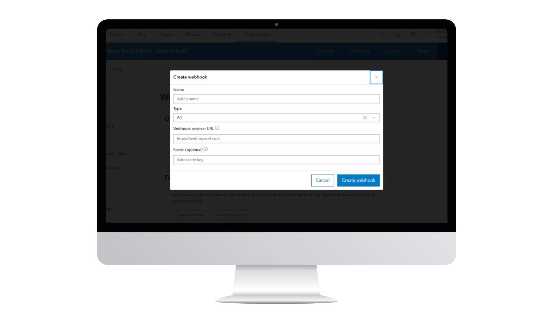

Integration is about making GIS part of enterprise-wide processes. Organizations today depend on event-driven systems, automation pipelines, and interconnected applications. One of the primary ways this can be done in ArcGIS Enterprise is with webhooks. With webhooks, ArcGIS Enterprise can connect with external business systems in real time—triggering workflows, notifying downstream systems, and responding to change as it happens.
In ArcGIS Enterprise, there are two types of webhooks: organization webhooks and service webhooks.
Organization webhooks can be configured to listen for events on items, users, groups, and roles. An example of this is a webhook being configured to trigger when a specific user signs in to the Enterprise portal or any content has been shared to a group.
Service webhooks can be configured to listen to specific interactions associated with feature services and geoprocessing services.  Feature service webhooks can be created for both hosted and by-reference feature services. The webhook can be configured to send a message when edit operations, such as create, update and delete events occur. Geoprocessing service webhooks can be triggered whenever a job ends – whether that job is successful, it was stopped, or it failed.

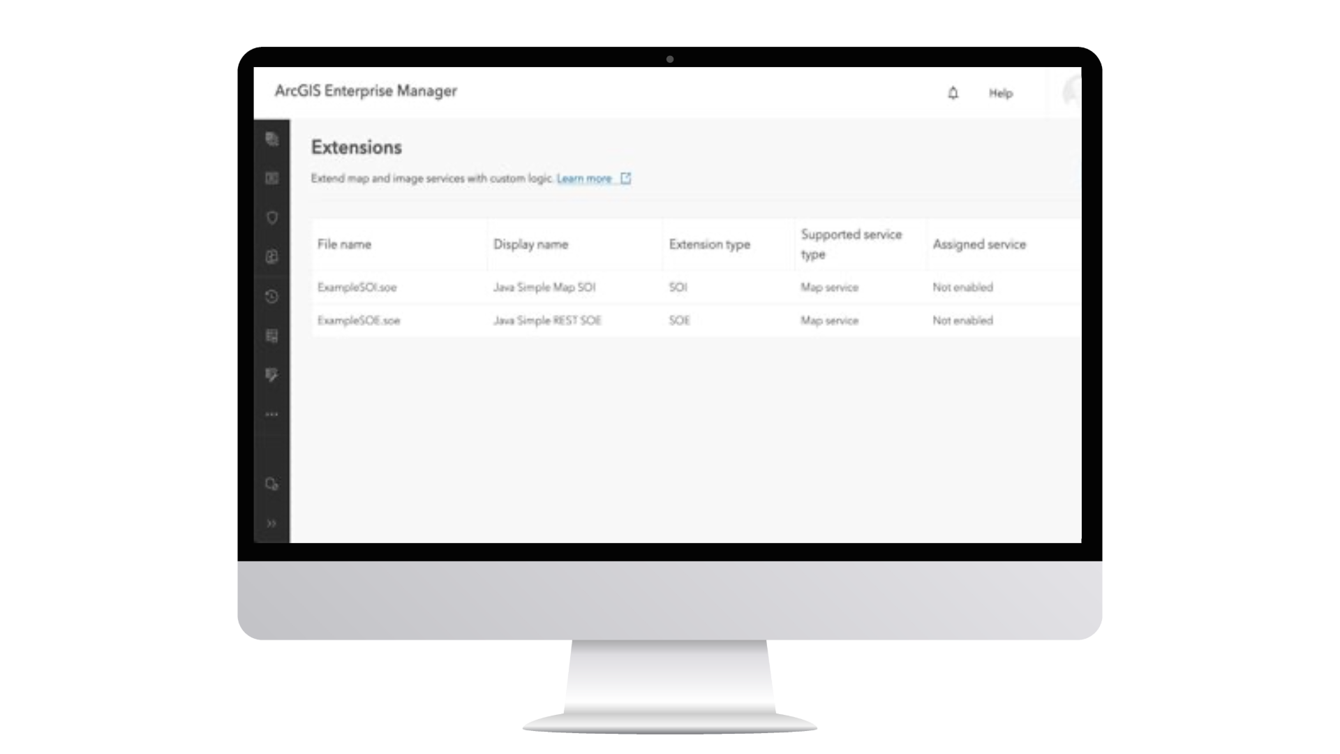

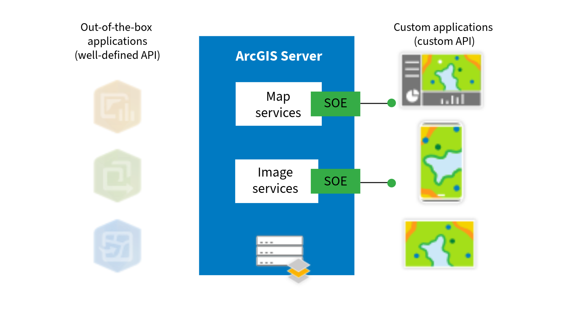

SOEs allow organizations to add new business logic to referenced map and image services. Built using Java or .NET, SOEs introduce new REST operations, enabling services to perform tasks they otherwise would not be able to do.
For example, an SOE can support on-the-fly calculations, enforce specialized transformations, or embed proprietary business logic directly into a service. Once deployed, that logic is exposed through the ArcGIS Server REST API for use by custom applications. These are nonstandard APIs designed for custom applications, so will not work with out of the box apps like ArcGIS Pro or Map Viewer but can be configured to work with custom applications, such as those built with the ArcGIS Maps SDK for JavaScript. They allow organizations to build highly tailored solutions that reflect their unique business needs and help services do more than they were originally designed to do.
Read more about SOEs in the Overview of developing SOEs product documentation.

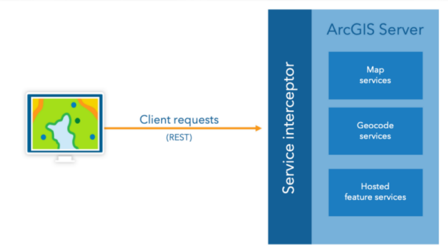

Released in ArcGIS Enterprise 12.0 on Windows and Linux, service interceptors operate at the web services tier and expand standard REST requests and responses through pre- and post-processing.
Written in Java, they allow organizations to use high-level APIs to intercept web service traffic without necessarily requiring knowledge of the underlying service runtime. They are not tied to individual services and are not limited to map or image services; they can be configured to be applied to all web services published to ArcGIS Enterprise. Common use cases include auditing and logging, enforcing security compliance, access control, and applying customer-specific business logic.
One of the most powerful aspects of service interceptors is their ability to enable custom workflows at the request and response level without changing client applications or fortifying backend services. This allows organizations to implement enterprise-wide logic in a centralized, scalable way.
Read more about service interceptors in our New in ArcGIS Enterprise 12.0: service interceptors blog.

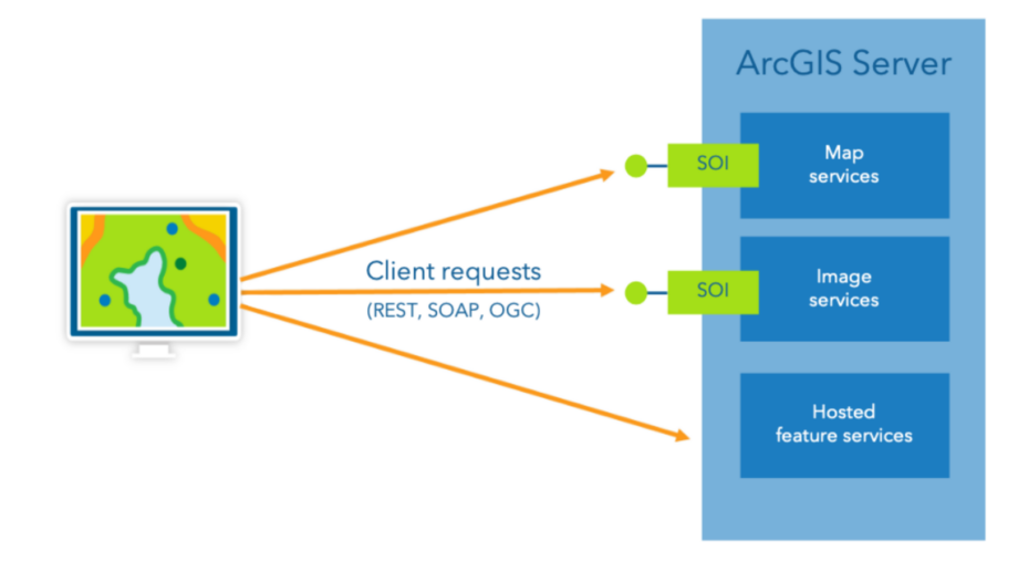

SOIs operate at a finer level of control and add business logic that expands existing, standard Esri REST APIs through pre- or post- processing of requests.
Written in Java or .NET, SOIs work at the data tier and enable pre- or post-processing of requests to individual referenced map and image services. They expand standard Esri REST APIs and can be invoked by any client, whether custom-built or out-of-the-box Esri applications – such as ArcGIS Pro, Map Viewer, and more.
Unlike service interceptors, SOIs require some knowledge of the underlying service runtime. They are ideal for use cases such as watermarking, detailed data validation, or applying logic specific to a single service.
Read more about SOIs in the Overview of developing SOIs product documentation.
Together, service interceptors and SOIs give organizations flexibility in where and how they apply business logic, at the web tier or the data tier.
