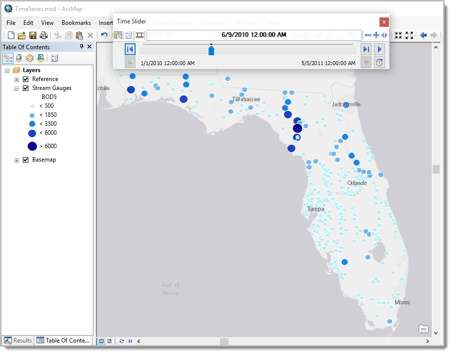

Since the introduction of time-aware layers in ArcGIS 10.0, you can display features with time-series data from a separate table, collected at regular intervals with one additional step. This allows you, using the time slider, to go back in time and draw features with the observed or measured values for a given time instance.
That is great, but sometimes for various analytical reasons, you need to display features using some summary statistics – instead of raw observed data – for a given time duration. For example, you may want to map weather stations with monthly average temperatures for January 2016 from an observation table where daily data was stored. Another reason you may want to display features with summary statistics is to discover patterns — especially from a time-series data observed at irregular intervals which otherwise would not be possible.

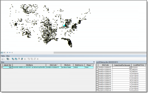

To make matters more complicated, there are cases where the asset and observation tables are stored in a single database and in other cases they are stored in separate databases. For the best performance, it is always recommended to keep asset and observation tables in the same database.

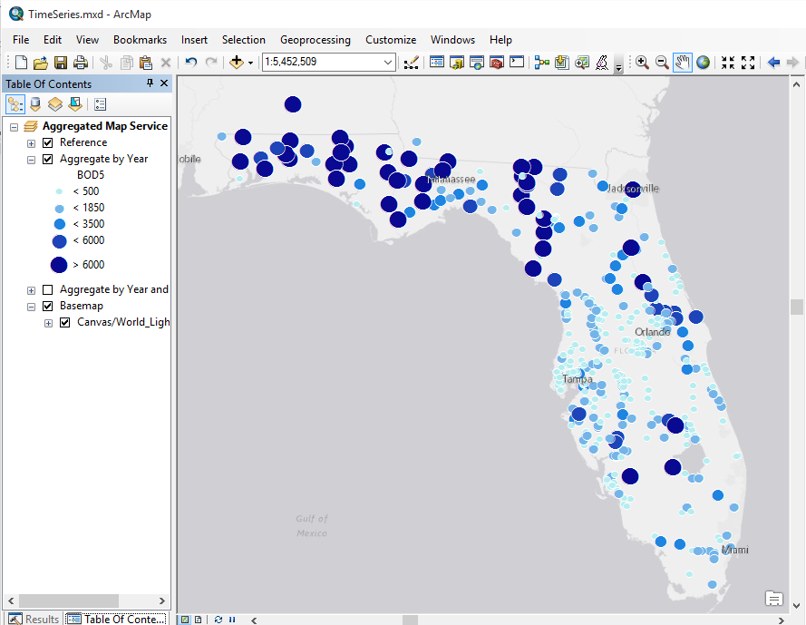

Setting layer properties
Both of these layers are showing multiple points for the same location, since the aggregated result is grouped by year and joined to the asset table. Use the definition query to show results for only one year or one month.
  1. Open the first layer’s property page and click the Definition Query tab.
  2. Add a query (e.g., COMPYEAR = 2015) to show only results for 2015.
  3. Click the Apply button.
  4. Click Symbology tab.
  5. Select Graduated Colors or Graduated Symbols.
  6. Select one of those aggregated fields (e.g., Max_MeasuredValue, Min_MeasuredValue or Avg_MeasuredValue).
  7. Classify and symbolize as you prefer.
  8. Click OK to draw.
  9. Repeat these steps for the second layer but with a minor difference: you need to use two fields in the definition query (i.e., COMPYEAR = 2015 AND COMPMONTH = 1) to show results for January 2015. If you want to have a third layer to show daily aggregated result, use three fields (i.e. COMPYEAR, COMPMONTH, and COMPDAY) in the definition query.

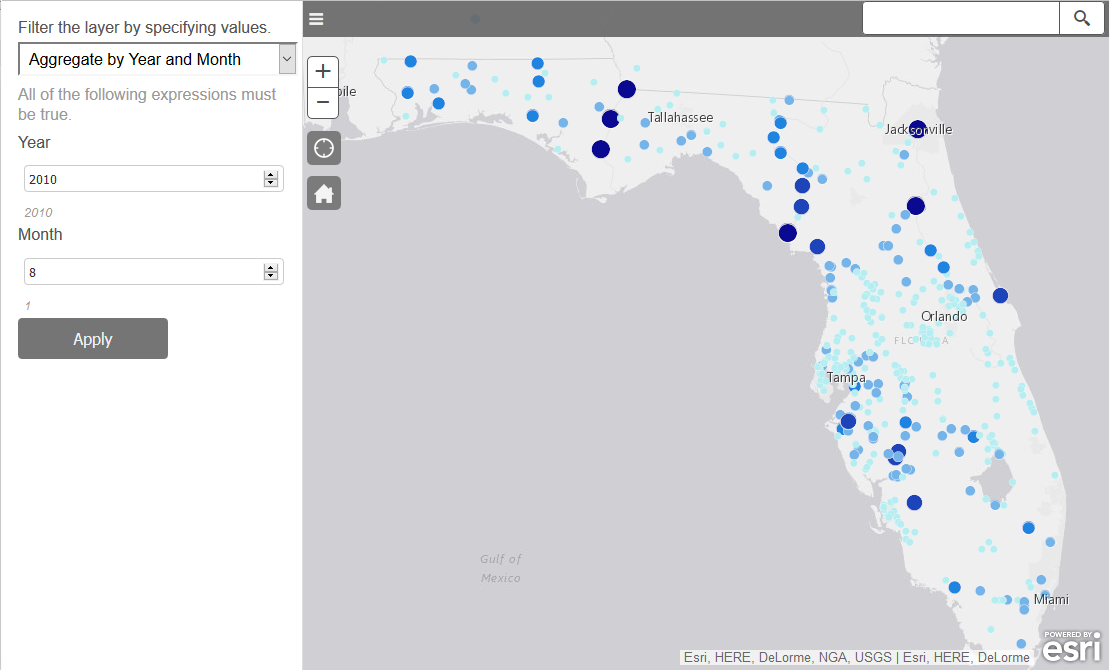

Since viewing aggregated results for any given time window requires the end users to set filter or definition query from the web application, we need do some extra steps to make sure that there is always a default filter or definition query set to each sublayer within the map service layer.
Create a web map and set default filter
  1. Open ArcGIS Online or Portal Map Viewer on a web browser.
  2. Add the map service you published earlier to the Map Viewer.
  3. Expand the layer on the map’s Contents pane to show its sublayers.
  4. Point to the first sublayer and click the Filter button.
  5. Set the filter to COMPYEAR = 2015.
  6. Make sure to check the Ask for values check box and fill up the Prompt and Hint textboxes so that your end users can’t view the map service without the definition query and won’t overload the database.
  7. Click Apply Filter.
  8. Make the sublayer visible from the Contents pane.
    Now you are seeing features drawn with the type of aggregation you chose while preparing the layer for the year 2015 in ArcMap.
  9. Alternatively, if you want to change the symbol styles or view using a different aggregation method, point to the sublayer and click the Style button.
  10. Choose one of the fields with aggregated results (e.g., Max_MeasuredValue, Min_MeasuredValue, or Avg_MeasuredValue).
  11. Select a drawing style and click Done.
  12. Following the above steps, set a filter for the second sublayer. Please note: You need to use both COMPYEAR and COMPMONTH in the filter – you need to add two expressions in the Filter dialog and make sure Ask for values is checked for both expressions.
  13. Save the map.
Create a web application using an existing application template
  1. Still on the Map Viewer, click the Share button.
  2. On the Share dialog box, click the Create a Web App option.
  3. Search for application templates with the “filter” keyword.
  4. From the search result choose the template named Filter.
  5. Click Create App and fill in the necessary boxes in the next dialog box.
  6. Click Done which brings up the Configure Web App page.
  7. Select Filter Options and check Display dropdown.
  8. Click the Save and View button close the configuration pane and open the web application.
You can share this web application with your end users. While using this application, to view the aggregated result for a given period, select the layer from the drop-down menu, modify the filter, and click Apply.

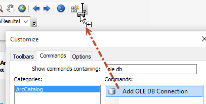

Create an OLE DB connection in ArcCatalog
  1. Open ArcCatalog.
  2. Click Customize Mode from the Customize menu.
  3. Click the Commands tab on the Customize dialog box.
  4. Type OLE DB in the Show commands containing box.
  5. Drag the Add OLE DB Connection command onto any toolbar.
  6. Close the Customize dialog box.
  7. Click the newly added Add OLE DB Connection button to bring up the Data Link Properties dialog.
  8. Fill in the dialog to create a connection to your database.
  9. The newly created connection will show up under the Database Connections node in the Catalog window in both ArcCatalog and ArcMap.
