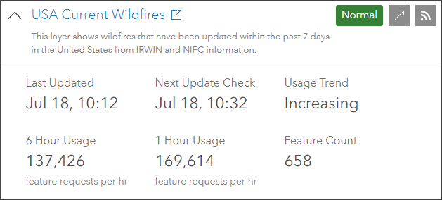

How often are Living Atlas live feeds updated?
ArcGIS Living Atlas live feeds are updated regularly, the update frequency depends on the source and available data. You can learn about the update frequency by viewing the item overview for the live feed. For example, viewing Active Hurricanes, Cyclones and Typhoons we learn that the source is checked for updates every 15 minutes. Viewing Satellite (MODIS) Thermal Hotspots and Fire Activity we learn that the update frequency is every 30 minutes. The National Weather Service Smoke Forecast is updated every 24 hours by NWS.
The Live Feeds Status dashboard also shows the update frequency. Open the drop-down to see when the feed was last updated, when the next update check will occur, and other usage statistics.
For more information, see Introducing ArcGIS Living Atlas Live Feeds Status.

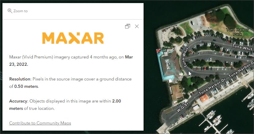

How can I find the resolution and vintage of Living Atlas imagery?
Living Atlas world imagery is published in several different ways, as tile layers and ready-to-use basemaps with and without reference layers. World imagery uses Maxar as a primary commercial source, which is complemented by contributions via the Community Maps Program. These sources deliver 1 meter or better satellite and aerial imagery in many parts of the world, with higher resolution in many urban areas. The recency and resolution of the imagery depends upon the scale at which it is viewed and also the geographic location.
To learn more about the imagery, use the Imagery with Metadata map and zoom to your area of interest. Click the map to see the resolution, collection date, and source of the imagery. You can also add the World Imagery layer to any map to obtain the same information.
Use the World Imagery Updates app to learn more about recent updates and map coverage. The link to the app is included in the World Imagery item details.

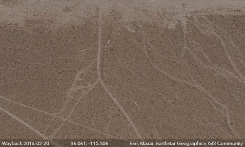

Is there an archive of older imagery?
Wayback imagery is a digital archive of the World Imagery basemap, enabling users to access more than 100 different versions of World Imagery archived over the past 6 years. Each record in the archive represents a version of World Imagery as it existed on the date it was published. See the Wayback Imagery group to view the archive.
Using the World Imagery Wayback app you can browse and discover previous versions of the World Imagery basemap. The app also includes swipe and time animation tools, and can be used to create and share maps and animations from the imagery archives. Shown below is an animated GIF created using the Wayback app.
For more information, see Explore imagery archives using World Imagery Wayback.
