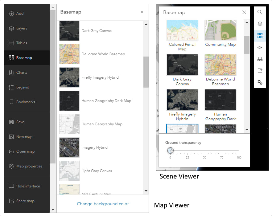

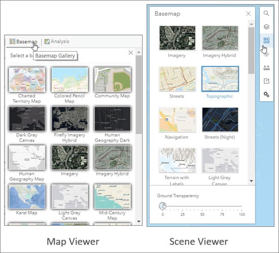

A basemap provides the geographic context for the layers you want to display in a map. When you create a new map or scene, you can choose which basemap you want using the basemap gallery.
Basemap gallery
View larger image
By default, the gallery contains a pre-defined set of basemaps from Esri, and is based upon the region you have set for your organization. With administrator privileges in your organization, you can change which basemaps your organization uses by creating a custom basemap gallery. The custom basemap gallery can include a combination of your own basemaps and Esri basemaps. The steps to create a custom basemap gallery are:

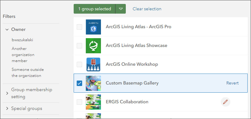

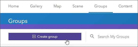

Step 1 – From the Groups tab, click Create group.
Create Group

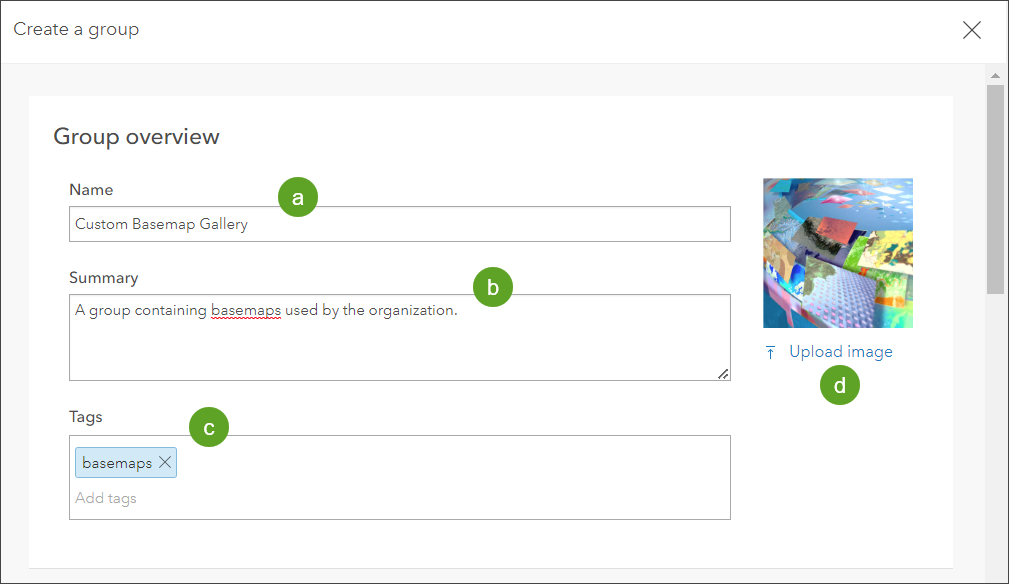

Step 2 – Complete the Group Details.
a – Add a group name.
b – Add a Summary description for the group.
c – Add one or more tags.
d – Add a thumbnail for the group (optional, but recommended).

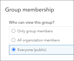

Consider the other group settings, although in this case the rest of the default settings are fine. Ensure that the group is viewable by Everyone (Public) or by All organization members. Note that all maps in the group should be public.
View settings
Click Save when finished.
Save

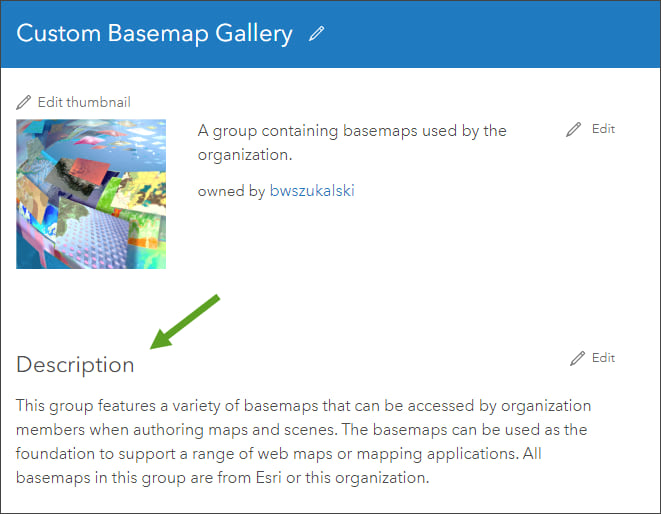

Tip: After the group has been created, it’s a good idea and a best practice to complete the group description.
Group description

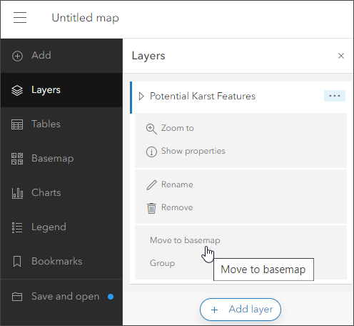

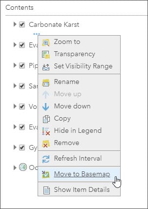

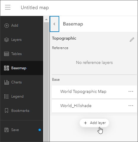

You can author maps specifically for use as basemaps. Note that operational layers (anything above the basemap layer group in Content) will not display when used as a basemap. To move a layer to your basemap group, in the Layers pane click the layer options (…) and choose Move to Basemap.
Move to basemap
In the basemaps pane you can also Add Layer.
Add basemap layer

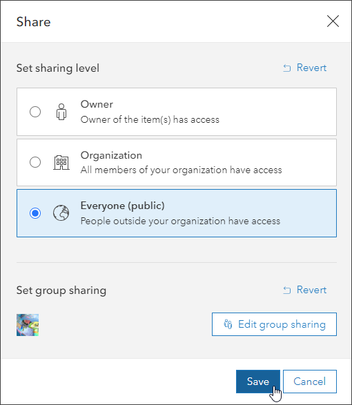

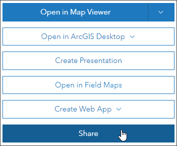

Step 1 – Open the item page for the web map you want to add to your basemap group.
Step 2 – Click Share.
Share
Step 3 – Click Edit group sharing.
Edit group sharing

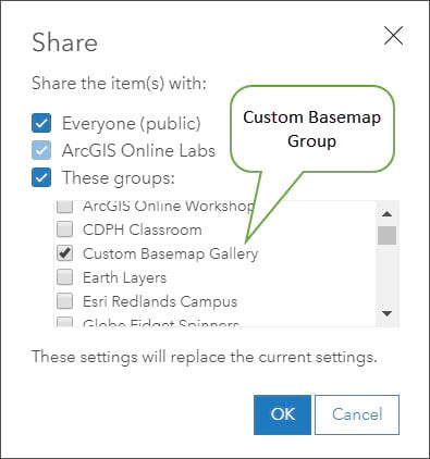

Step 4 – Select your organization’s custom basemap group from the list of available groups. Click OK when finished.
Share to group
Step 5 – Click Save when finished. The map has been shared to your basemap gallery group.
Save sharing

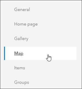

Step 1 – Go to your organizations Settings, and open the Map tab.
Setting Map tab

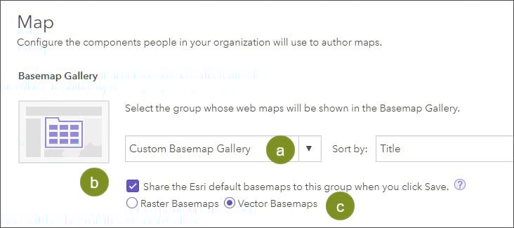

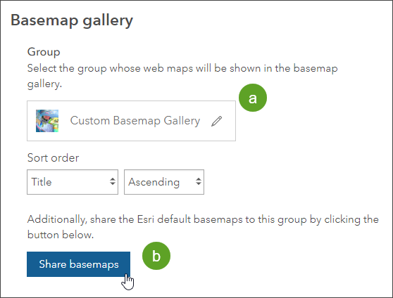

Step 2 – In the Basemap Gallery section, do the following.
a – Select your custom basemap gallery group from the dropdown list.
b – Choose Share basemaps to add the default Esri basemaps to the group. This is optional, but if you only have a few custom basemaps in your custom gallery group adding these will complete your gallery.
Basemap gallery settings
You’ve successfully created a custom basemap gallery, which will appear in all apps.
