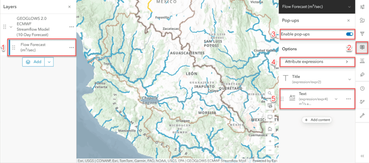

Pop-up Configuration
In the map viewer, we (1) select the GEOGLOWS layer, (2) open the pop-up panel, (3) make sure pop-ups are enabled, and (4) create a custom attribute expression. This attribute expression can be used within the (5) pop-up text.

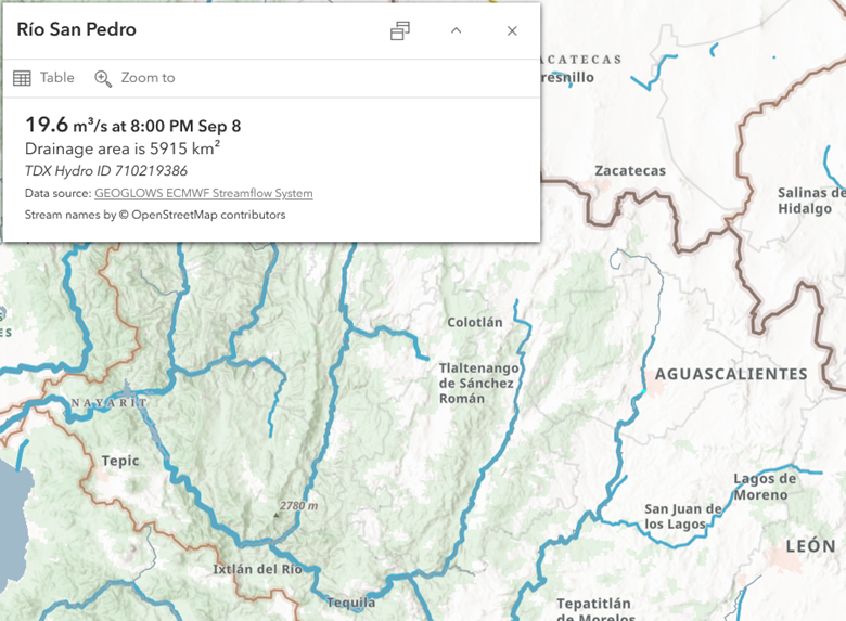

Finally, we (1) handle empty responses (!IsEmpty(rivers)) , (2) discard null names using a When statement (When(!IsEmpty(river.name_en), river.name_en, !IsEmpty(river.name), river.name, "Name not available")), and (3) select the first feature (!First(rivers)) on the list.

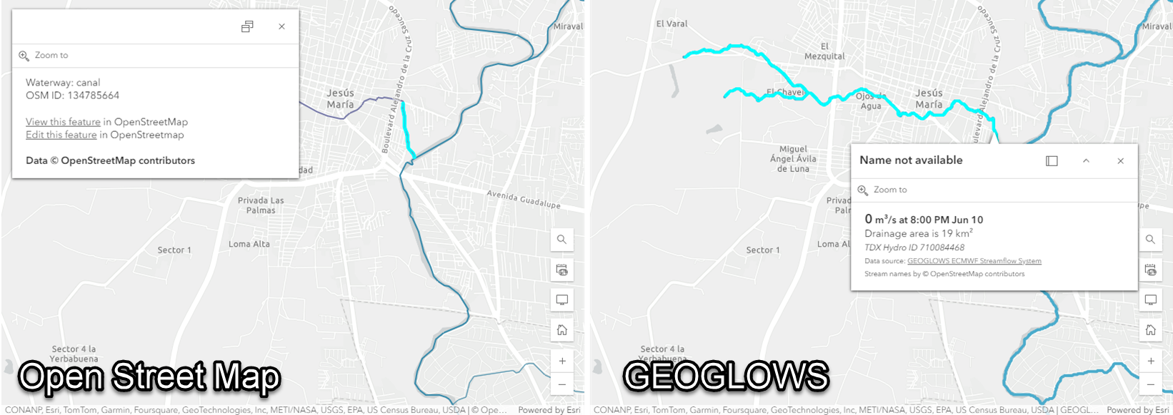

Missing River Names in OSM

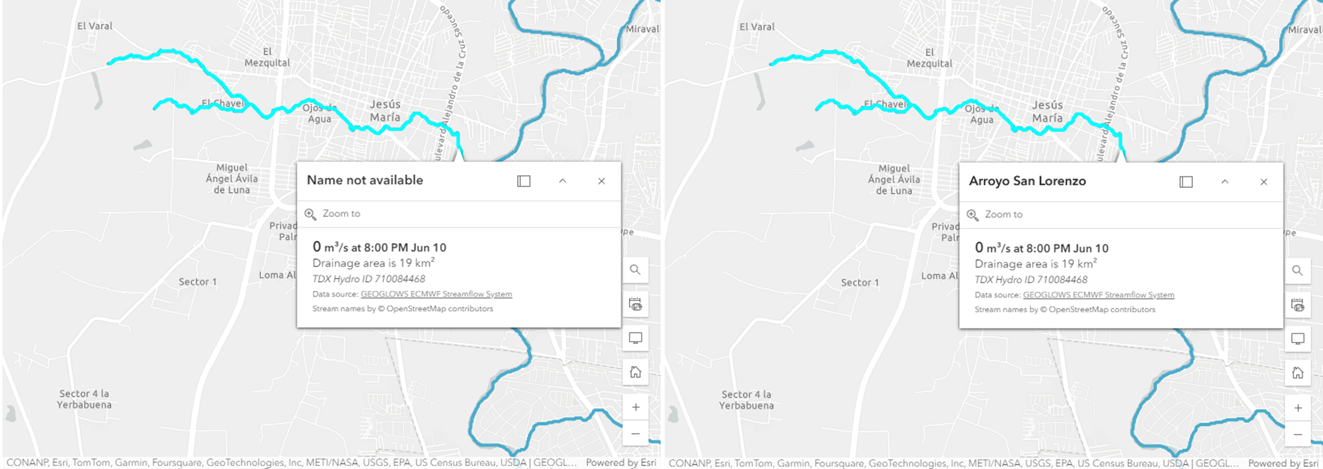

OpenStreetMap is an extensive dataset. Nevertheless, there are a few areas that are missing stream names. Those streams will display “Name not available” in GEOGLOWS.

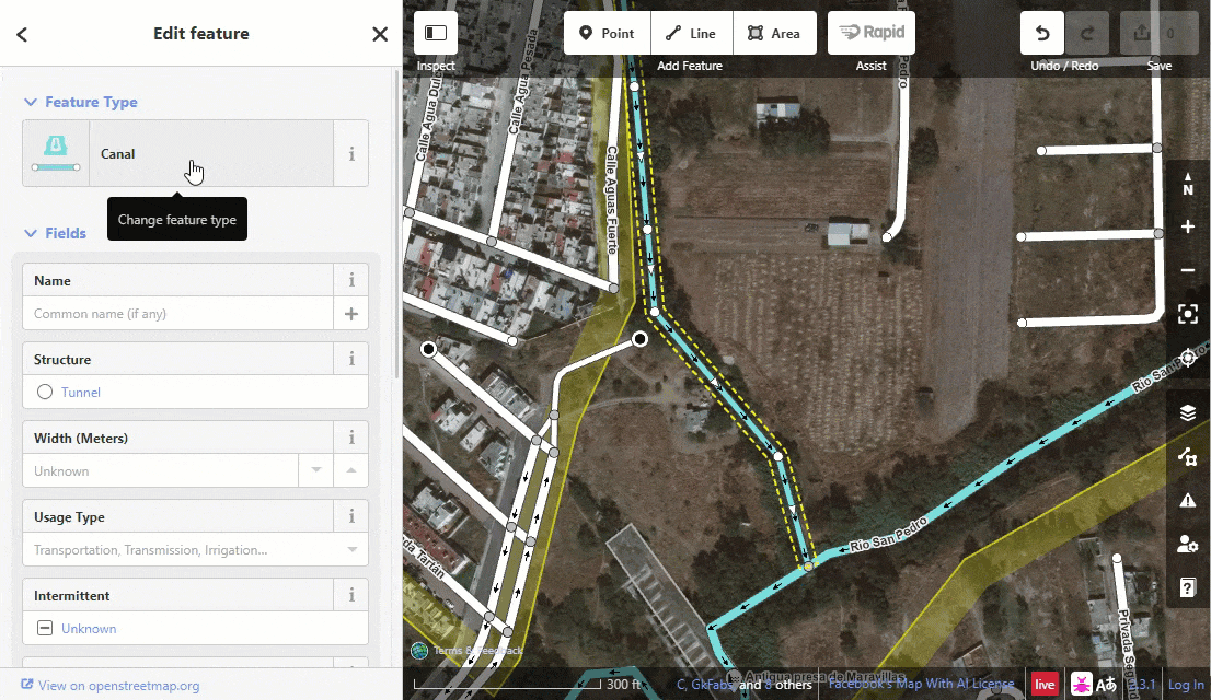

We can take this opportunity to become an OpenStreetMap contributor. River names contributions to OSM will sync to the Live OpenStreetMap layers in Living Atlas within minutes.
We can contribute to OSM, for example using the Rapid editor.
In the course of time, the OSM river name contributions are shown in GEOGLOWS.
