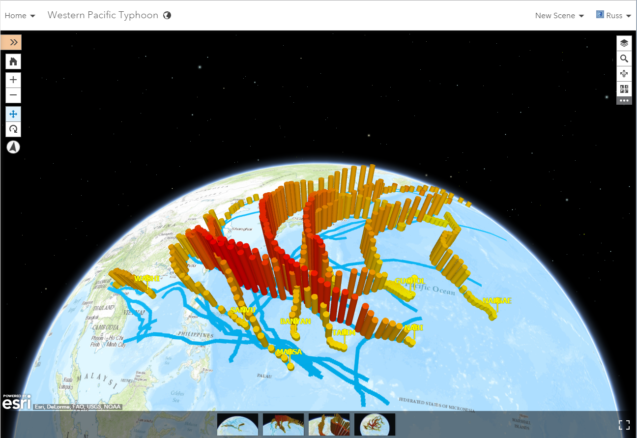

In previous releases of the scene viewer you could only display content on a globe. Global scenes show your content and layers in a sphere based on a Web Mercator (Auxiliary Sphere) coordinate system. Having the global scene fixed to a Web Mercator coordinate system restricted cached data (tiled image services, tiled map services and elevation image services) to the Web Mercator projection and to match the AGOL tiling scheme.

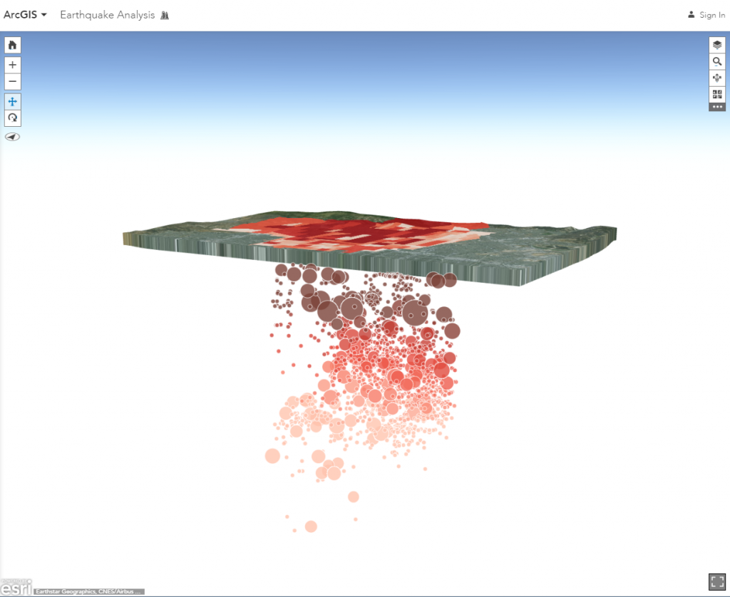

In this release we have brought in the capability to create local scenes. You can use local scenes to view data that is in a different projected coordinate system or is cached with a custom tiling scheme. Local scenes allow you also to set a clipped extent that the layers being displayed in the scene are constrained to. These local scenes are great for viewing buildings on a campus or for viewing subsurface data like earthquake depths, utility networks or pipelines. In this sample below, I am using subsurface earthquake data that is located below my basemap. The local scene makes it very easy to navigate under the surface and look at the recorded earthquake data and how it corresponds to damage at the surface.

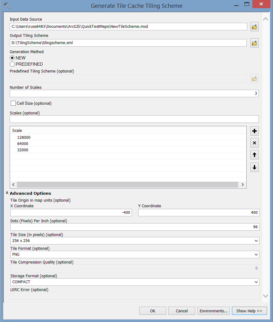

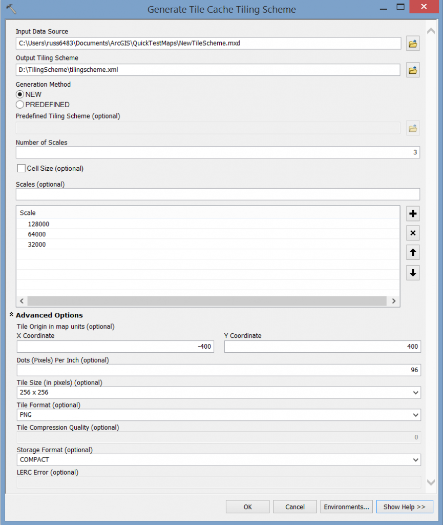

You can create your own tiling scheme file by using the GP tool Generate Tile Cache Tiling Scheme. The tiling scheme includes information on the scale levels, tile dimensions and the tile origin for the cache. The Scene Viewer will support a tiling scheme that has been configured to use 256 x 256 pixel tiles. The scale levels you define within your tiling scheme must increase or decrease by a power of 2. For example if you start your scale at 1:128,000 the next levels should be 1:64,000 and 1:32,000. Note that all decimal values are important and they should be kept without rounding. There are no restrictions on the tiling format or DPI settings.

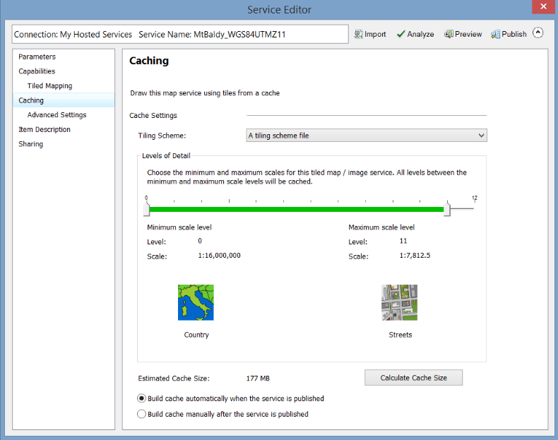

When you are going to generate your cache at the time of publishing your cached service you still have the option to pick a range of Levels of Detail (LOD) within your tiling scheme. Remember to use the same tiling scheme file you generated with the GP tool when publishing your cached map services, cached image services and elevation image services in the Service Editor. When you are cache settings you will choose the “From a tiling scheme” option when you are setting the scales being used. You can then pick the scale range you wish to use for your service and then share the service up to ArcGIS Online or to your ArcGIS Server. Using the same tiling scheme file for all of the cached layers you will use in your web scene is recommend and will help reduce any chance of layers not working with one another. Feature layers you use within the scene viewer do not have to be in the same projection as the cached data. They can be re-projected into the same projection as the cached data.
