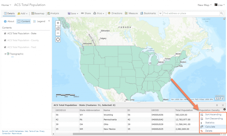

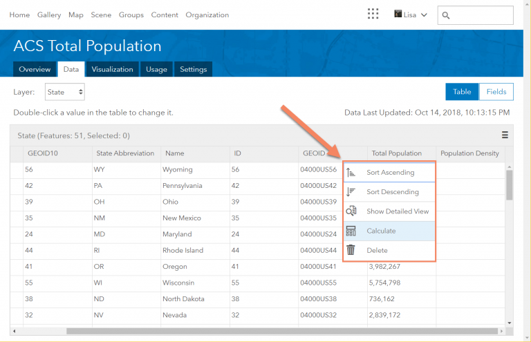

1) To start, choose to add a new field, or choose the field you want to calculate values for. This can be done from either the table view in Map Viewer or from the Data tab from your item description page. Choose Calculate from the field options
Tip: Using Calculate on existing fields with either SQL or Arcade will overwrite the existing data values. If you are worried about losing your original data, create a new field and calculate to that field instead.

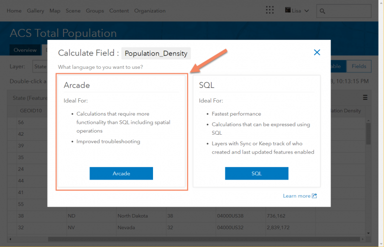

2) Choose the Arcade option

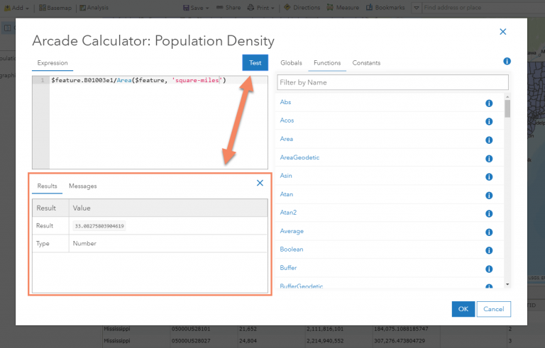

3) Write your arcade expression. This example uses the Area geometry function to calculate population density.
Tip: Try your arcade expression within smart mapping to test the expression results first. This also allows you to see how well the attribute looks on a map. To learn the basics of mapping with Arcade, visit this blog or this Story Map tutorial.
4) Test your expression. If the test value looks correct, click OK to calculate your new field values.

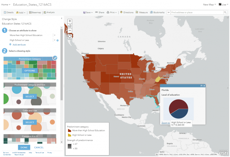

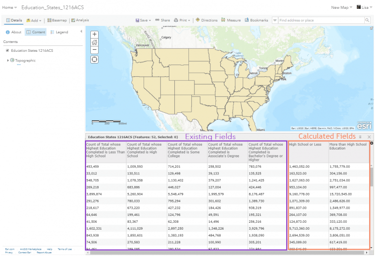

With the data below, I wanted to compare the number of people with a high school level degree or less to the population with above a high school education. To use the predominance mapping tool, and to show the values within a chart, I needed to use Arcade to combine multiple fields into two fields:

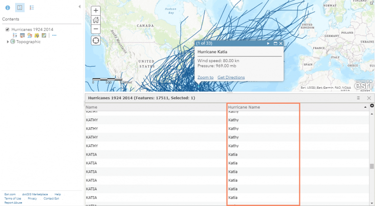

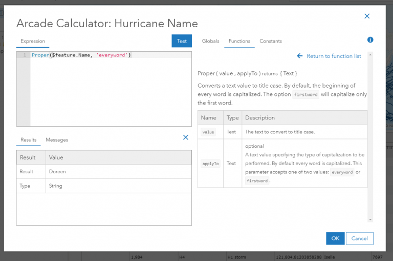

In this next example, I needed to fix text values that were in all caps by using the text function, Proper. With this change, I can easily use the new value within popups and labeling:

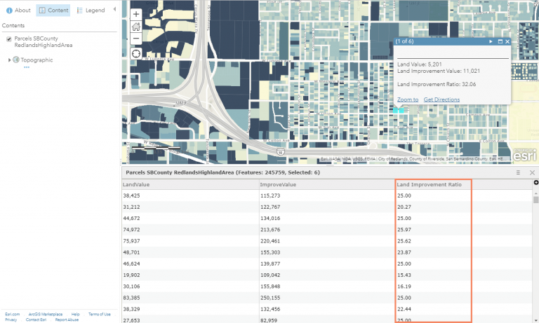

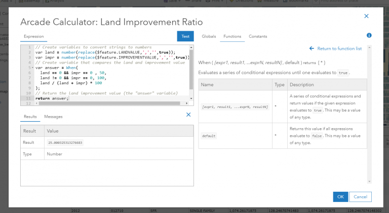

This example, inspired by this blog, calculates the ratio of land value and the improved value as a ratio. The input fields are text, and converted into numbers. This example uses multiple conversion functions as well as variables. By creating a new field, this value now be used within additional analysis, and also will allow me to filter my map by different values:
