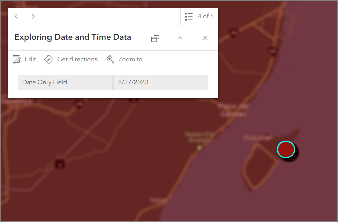

 - The Date only field is ideal for tracking events, recording historical data, and conducting date-based queries where the time of the event is irrelevant.

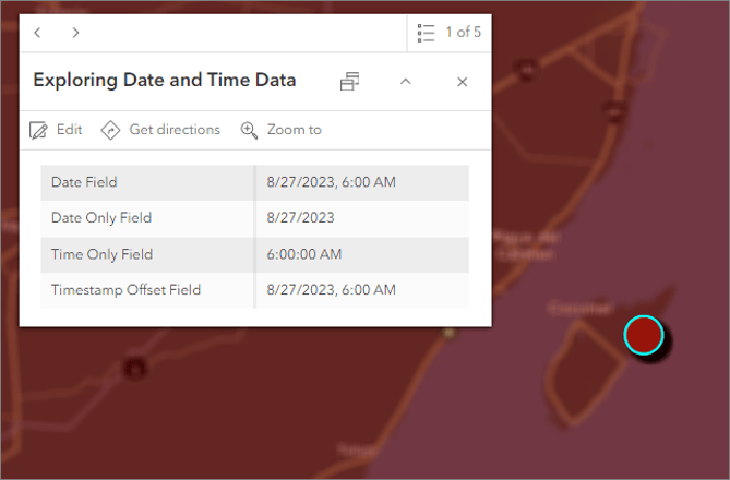

 - The Timestamp offset field stores date and time values and the time zone (stored as an offset from UTC). This is really useful for records that occur across different time zones.

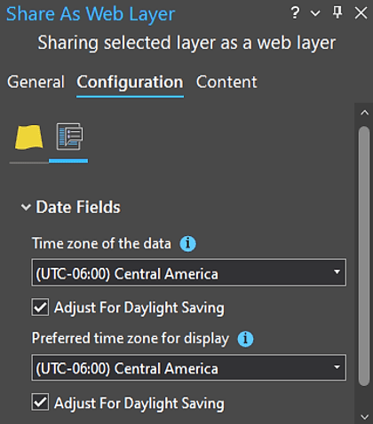

When you publish a layer with temporal information, from either ArcGIS Pro or from a file, you can set a time zone for the layer. This is handy when A) all of the data was collected in the same time zone, and B) you want to preserve the time zone information with the layer.
Note: If you don’t specify a time zone for your data, the time zone defaults to UTC. That can affect how the date and time values are displayed online. We’ll talk about that in more detail later.

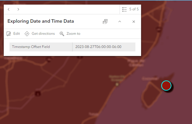

Selecting different time zones for different features is possible with the Timestamp offset field. This is especially useful when you’ve got a data with locations that span different time zones. Using a Timestamp offset field, editors can set the date, the time, and the time zone the feature was collected in, preserving time zone information for each feature in the layer. Pretty cool, huh?
In this field, the time zone is stored as an offset from UTC (in hours and minutes). For example, when the time zone is 6 hours behind UTC, let’s call that UTC-06:00, the timestamp offset would be stored as -06:00. Visit ArcGIS Online help for more information on Timestamp offset fields.

When publishing a layer from ArcGIS Pro, you have the option to adjust for daylight savings time (DST). When its enabled, the date and time values are automatically adjusted, forward or back, based on when daylight savings time starts or ends in the region.

Imagine you have a dataset that uses the OG Date field type. You enter dates in this field, but no time. When you view the values, you notice that a time was added to the date. That’s because the Date field stores both date and time, always…so if you don’t enter a time value, a default time of 12:00 am (midnight) is automatically added.
Level Up Recommendation: When you’re working with dates that don’t require a time value, use the Date only field. Using the date only field eliminates the time component all together, making it easier to store and manage date-only data.

We already touched on how time values are stored and displayed in ArcGIS- in UTC. Then, the display is adjusted based on the device time. Usually this provides an accurate, user-friendly experience. But that’s not always the case. Imagine you enter the following date:
1/1/2023 12:00 am
When viewed on a device in a time zone 1 hour behind yours, this value is displayed as:
12/31/2022 11:00 pm
The time, the date, and even the year changed, or rather, the way they display was adjusted. How can you prevent such adjustments? You’ve got options. Some possibliities include:
- Use a different field type, such as date only, which remains constant (no adjustments), or
 - Set the time zone on the web map so that the values are consistent regardless of the device time.
