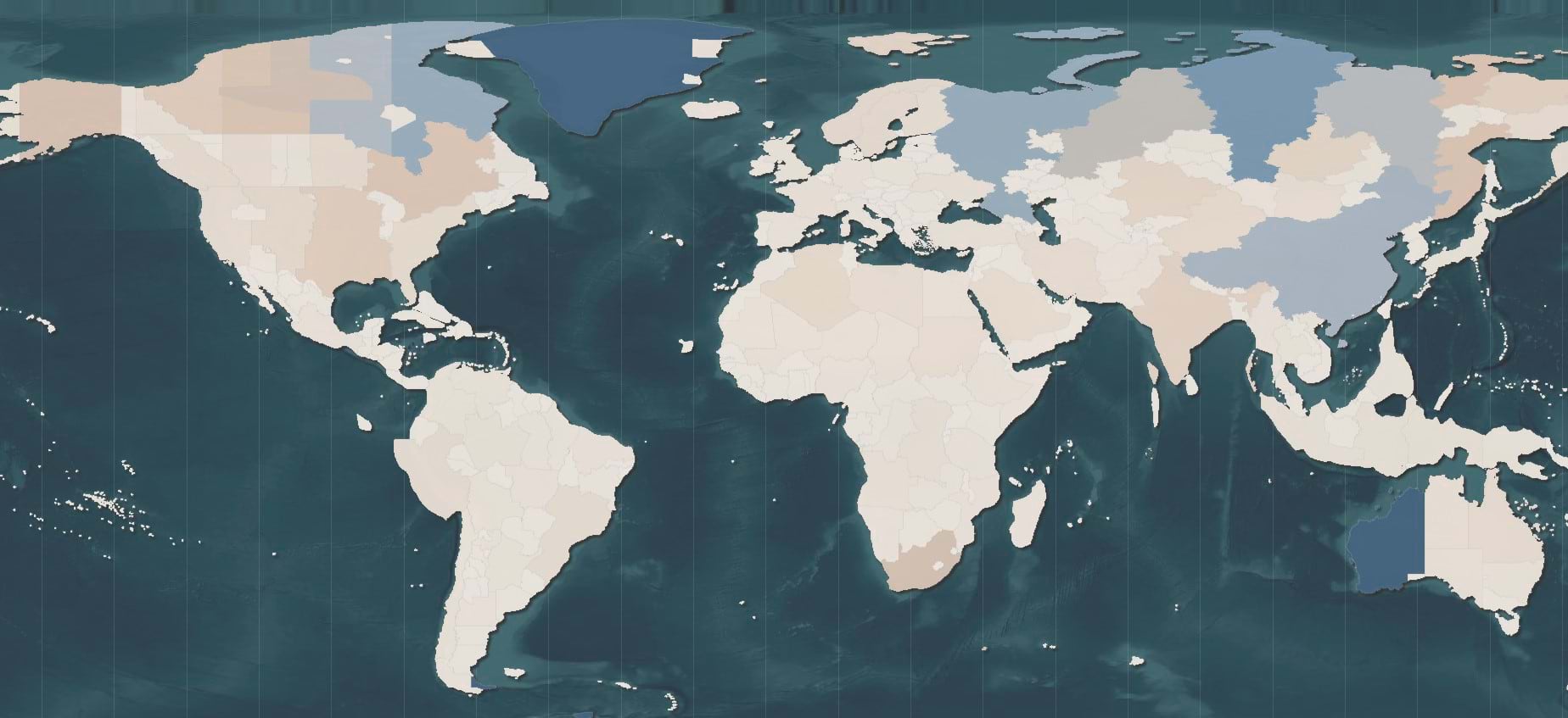

Map showing time zone boundaries

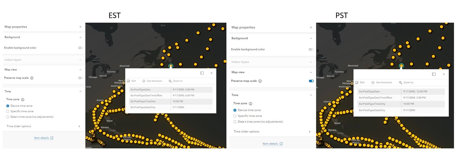

Device time zone
By default, web maps will use the option Device time zone. This matches the behavior for web maps before the October 2023 release. This means you won’t see a change in behavior with date field display compared to your previous experiences and won’t alter maps once resaved. Below is a web map showing the hurricanes web map showing how the popup displays for viewers in EST and PST. This would be the same experience as well for other areas where date-time values are displayed like tables and time slider.

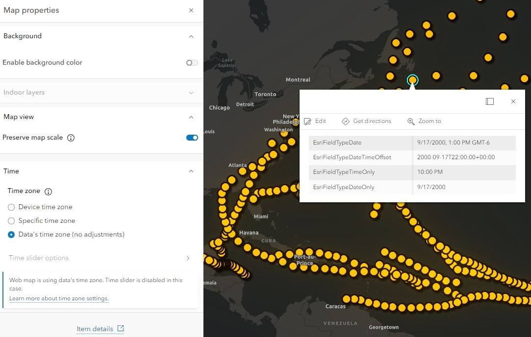

Data’s time zone (no adjustments)
If you are familiar with ArcGIS Pro’s experience with displaying date time you will see that no adjustments are made to the time. If the layer is published with a preferred time zone, Pro will display the values following that time zone set on the layer. When you set the web map to Data’s time zone you will see that the map will now honor the preferred time zone and no adjustments are made in the display of the date values. In the case where no preferred time zone is set the date fields will be displayed in UTC. If you have a case where multiple layers have different preferred time zones they will honor what has been set in the service. Currently some experiences will be limited when using the Data’s time zone. Specifically you will see time slider disabled at this release but we are working towards supporting this in a future update.
