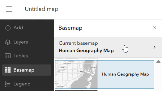

To view a basemap’s component layers in Map Viewer, choose Basemap from the Contents (dark) toolbar, select a basemap from the basemap pane, then click Current basemap at the top.
Open current basemap

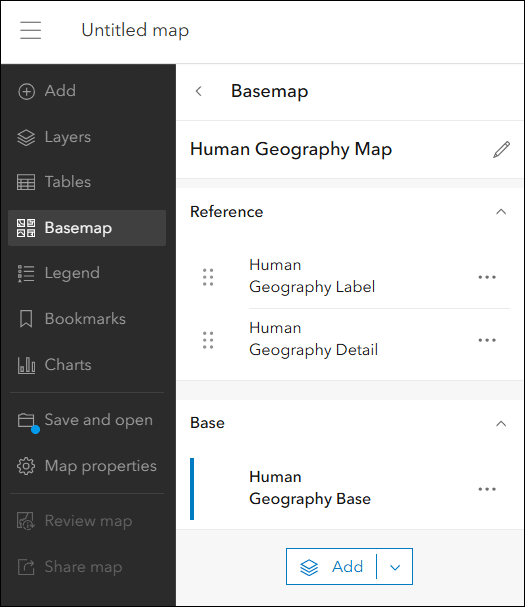

The next pane displays the component layers used in the basemap. In the case of the Human Geography basemap, there are two Reference layers (always drawn atop operational layers) and one Base layer (always under operational layers).
Bsemap component layers

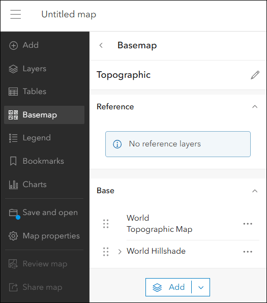

The Topographic basemap, which is the default for organizations, has no reference layers, only base layers.
Topographic basemap components

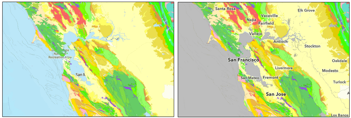

When choosing a basemap, a consideration is that different basemaps may be better suited for your operational layers. For example, because the Topographic basemap only has a single base layer, polygons added to that basemap will obscure labels. The Human Geography basemap has labels on a separate reference layer; they will always draw atop operational layers.
Basemap labels
California geology viewed with Topographic basemap (left) and Human Geography basemap (right). Click to view larger image.

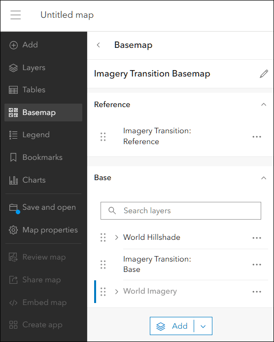

The Imagery Transition Basemap has one reference layer and three base layers.
Imagery Transition basemap
Select a base layer and view the layer properties on the Settings (light) toolbar; World Hillshade uses Multiply blending, Imagery Transition: Base has been customized using the Vector Tile Style Editor (VTSE) to enable a smooth transition to imagery, and World Imagery uses visibility scale ranges. For more information about how this basemap was constructed, see Imagery Fade-in (Blog).

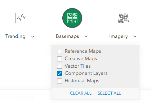

Find component layers at the Living Atlas website
At the Living Atlas home, click the Browse tab and under Basemaps, filter for Component Layers.
Component Layers filter

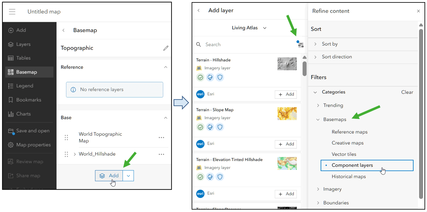

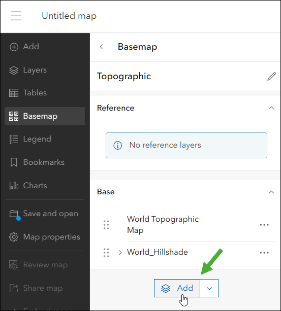

Find component layers via Add
From the basemap component layers pane, click Add and select Living Atlas (or another source). When searching Living Atlas you can apply filters to search for component layers.
Add to basemap layers

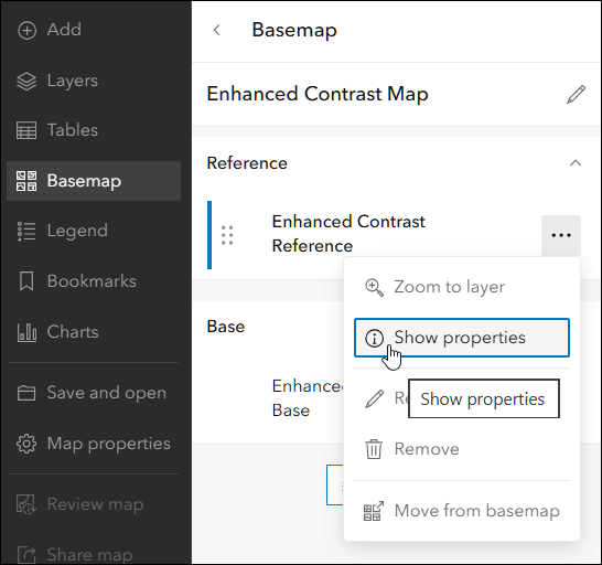

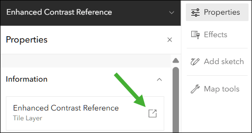

If you like a base or reference layer in an existing basemap, you can discover its source and use it in your custom basemap. For example, in the Enhanced Contrast Map you might want to take its reference layer and use it in one of your maps. From the basemap component layers pane, select Enhanced Contrast Reference, click Options (…), then Show properties.
Show layer properties
Open the Information section in the layer properties on the Settings (light) toolbar, then click the layer link. The link opens the item overview for the layer, where you can add it to a map and then move it to the basemap, or favorite the layer and add it to your basemap from your favorites.
Open layer item

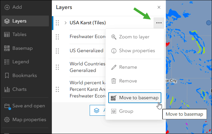

Move a map layer to the basemap
You can move layers in your map to the basemap by clicking Options (…) then Move to basemap.
Move to basemap
Note: Not all layer types can be moved to the basemap. For example, feature layers cannot be added to basemaps. If the layer type cannot be added, the option will not be available.

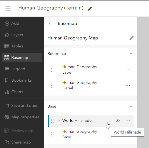

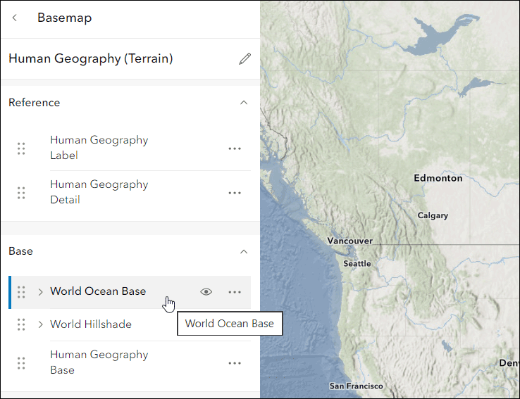

Human Geography plus terrain
To add additional context to the default Human Geography basemap, you can add World Hillshade to the base layers to create a custom Human Geography (Terrain) basemap.
World Hillshade added to base layers

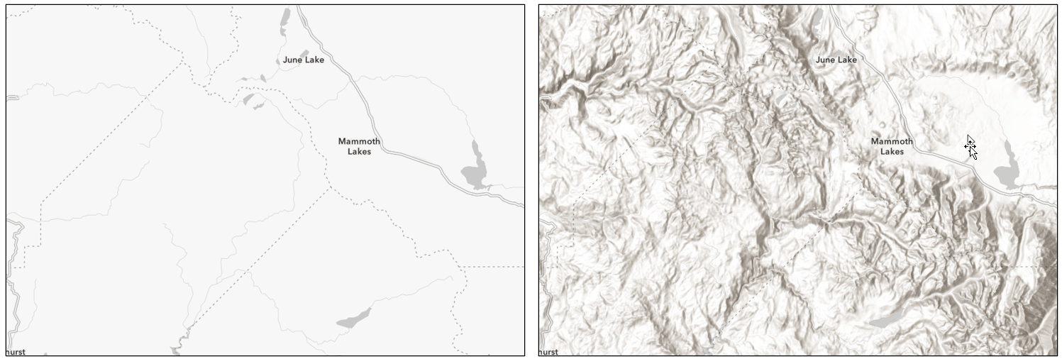

The addition of World Hillshade substantially alters the appearance of the Human Geography basemap, providing additional context to the map.
Human Geography
Left: Default Human Geography Map. Right: Custom Human Geography Map with World Hillshade. Click to view larger image.

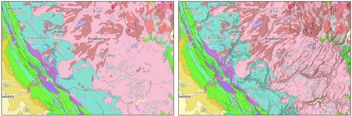

Because the basemap now includes terrain, Multiply blending can be used to enhance operational layers in the map. Shown below, California Geology has been added to the map. On the left is the default Human Geography basemap, on the right is the custom Human Geography (Terrain) basemap using Multiply blending on the geology layer.
View larger image

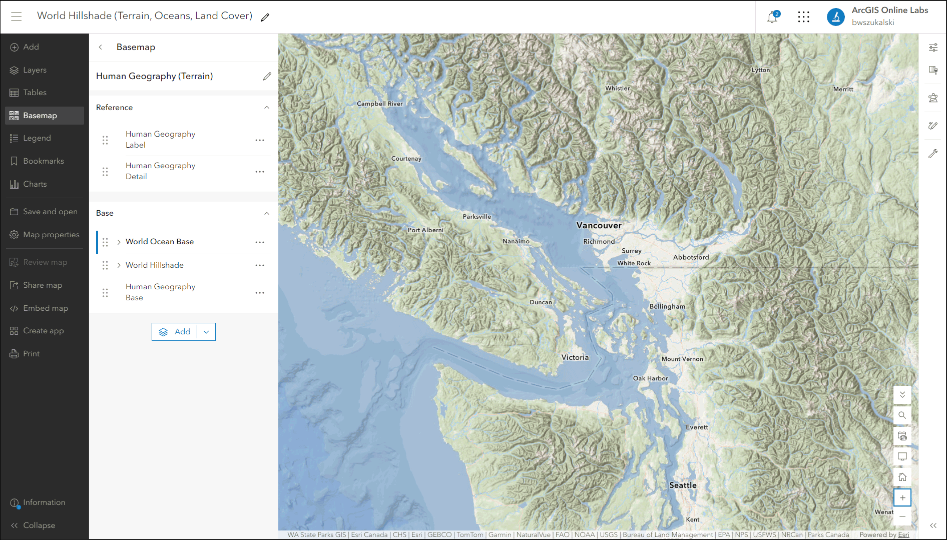

Human Geography plus terrain, oceans, water, and land cover
Water features are gray in the default Human Geography basemap. Building upon the Human Geography (Terrain) basemap above, you can add ocean and water features along with land cover shading to create an enhanced basemap.
The Oceans basemap applies focus on ocean areas, minimizing terrestrial features, however it omits boundaries and other features found in the Human Geography basemap. To combine the best of both, you can add the World Oceans base layer to the Human Geography (Terrain) basemap to create blue lakes and oceans with bathymetry along with land cover shading, plus still keeping the Human Geography details with terrain.
To create the final basemap, the World Oceans Base layer blending was changed to Multiply to preserve the hillshaded effect. View the map.
