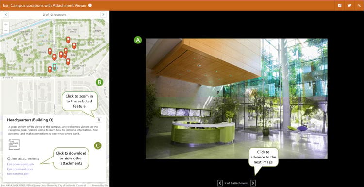

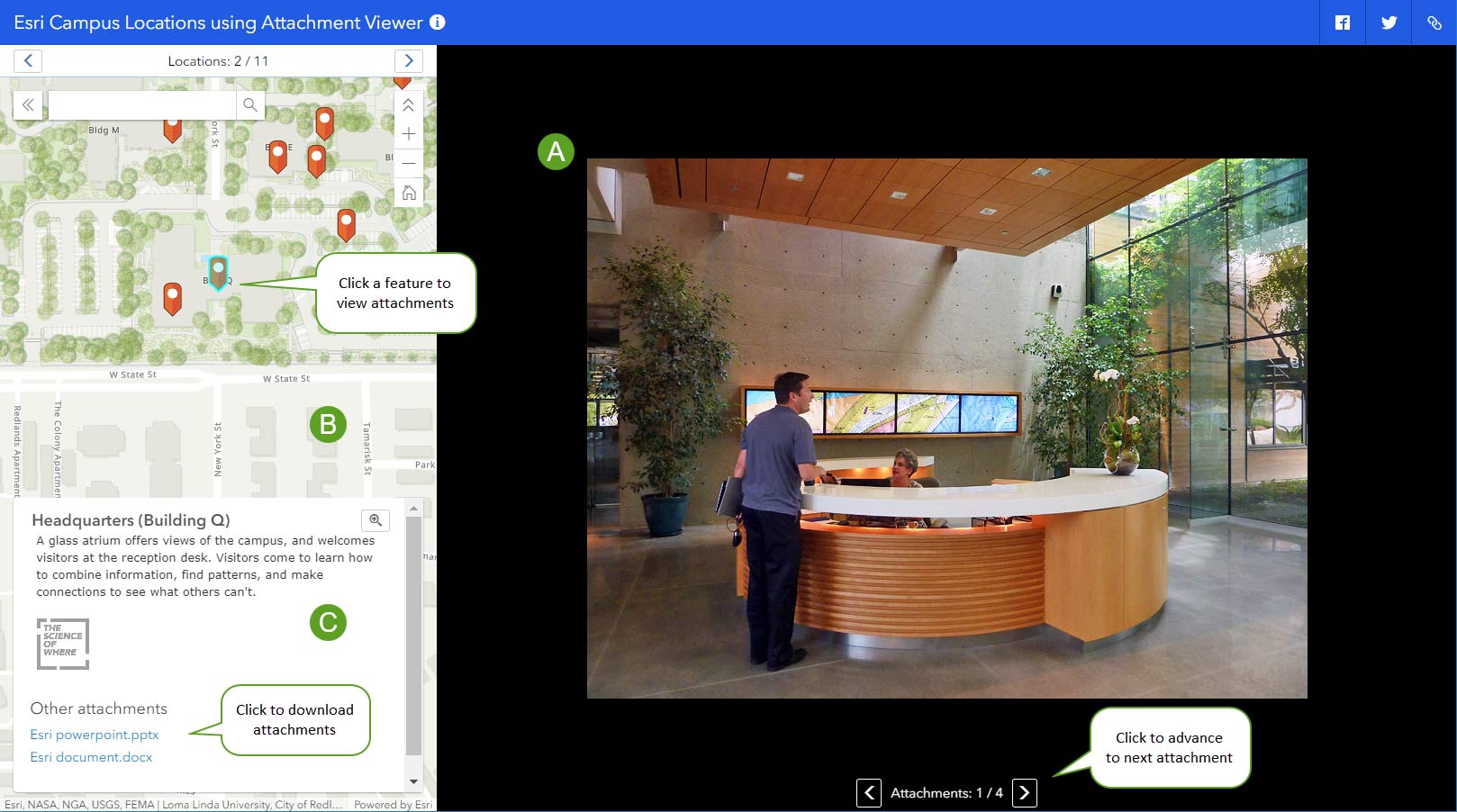

Attachment Viewer is a configurable app template that allows you to view photos and other feature attachments. Attachment Viewer has three main sections, and two layout options; Attachment, and Map. Shown below is the Attachment layout.
A – Main stage. This is where photos and other images are displayed, as well as videos, animated GIF files, and PDF files. Arrows at the bottom of the main stage allow viewers to browse multiple attachments.
B – Map. This is where the map is displayed. Pan and zoom to click other features to view their attachments.
C – Info panel. Displays the contents of the layer pop-up, including additional attachments if present.

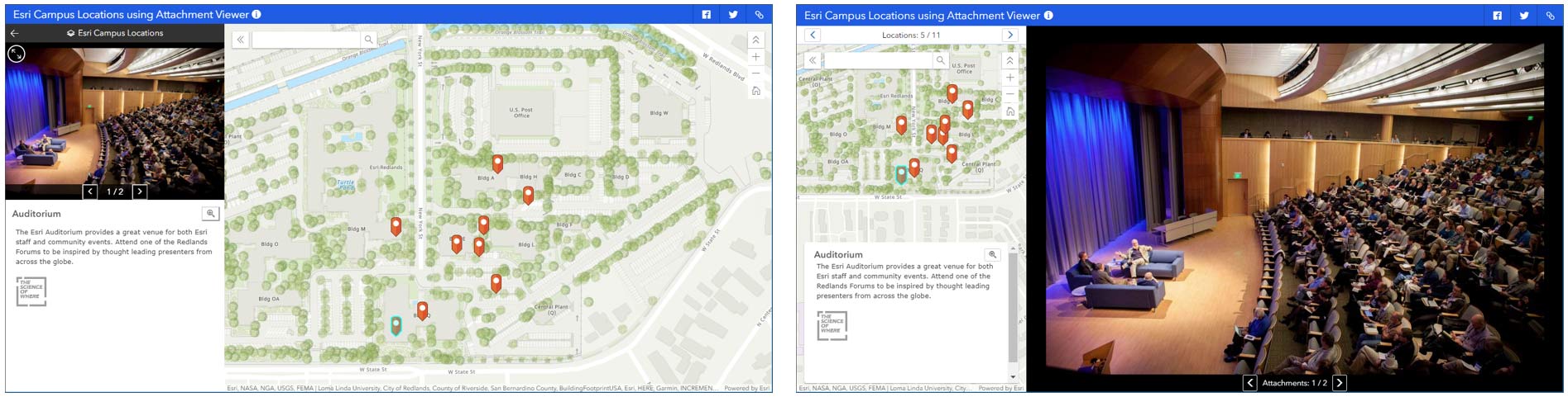

Attachment Viewer Map Layout
View larger image
With the Attachment layout, the attachments are featured in the main stage, with the map and pop-up contents displayed in the side panel. With the Map layout, the map is displayed in the main stage, with the attachments and pop-up contents in the side panel. Shown below is a comparison of both layout options.
Layout comparison
View larger image

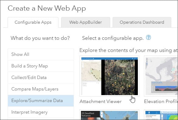

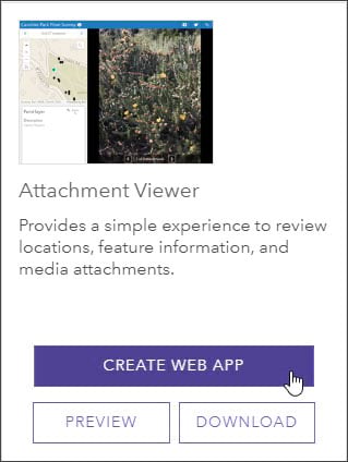

Step 2– Select Attachment Viewer, then click Create Web App.
In the Create a New Web App gallery, select Attachment Viewer. Click the Explore/Summarize Data tab to locate it, or use Search. After selecting it, click Create Web App.
Create Web App

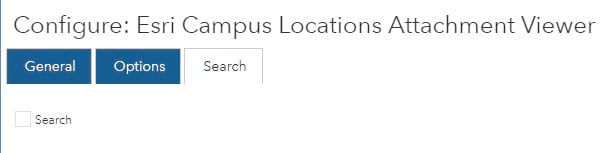

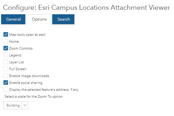

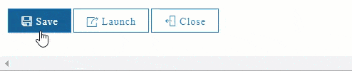

The configuration panel provides three tabs used to configure the app; General, Options, and Search. Make changes in each tab as desired. Click Save to accept changes and preview the app, click Launch to open the configured app in a new browser or tab, and click Close when finished configuring the app.

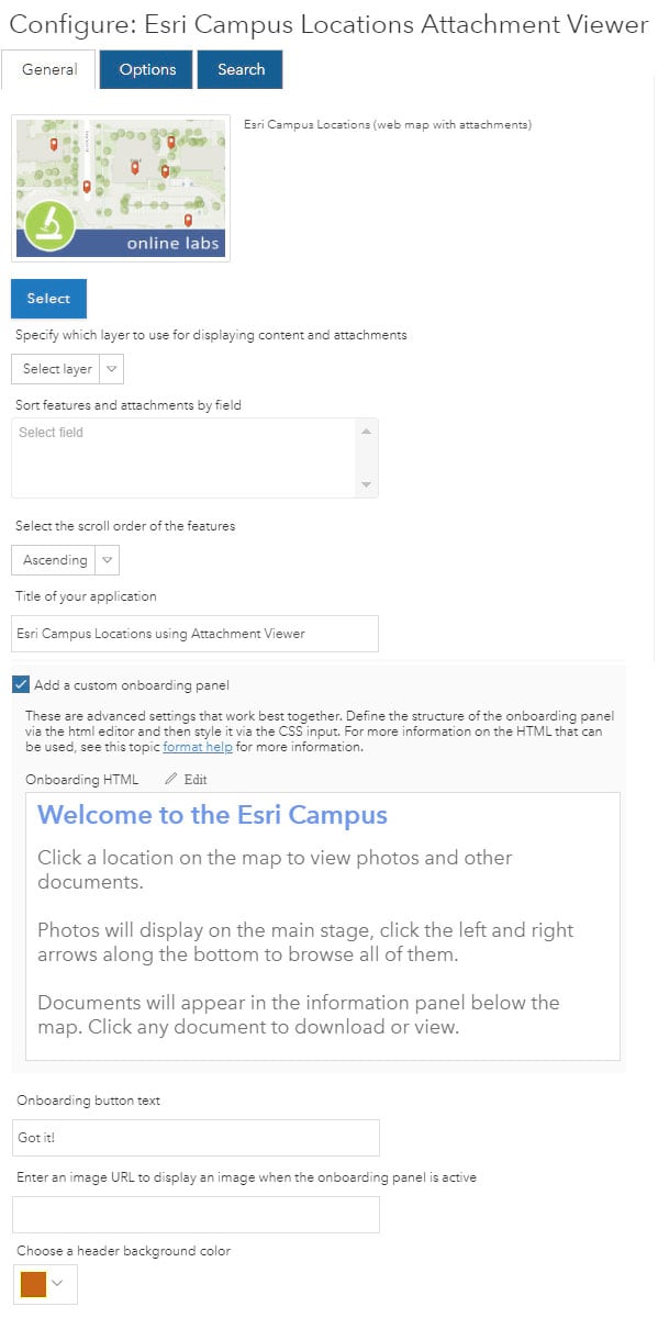

For our configured Attachment Viewer example app the following settings were made. Click the tab image to view the entire tab.
General tab
General tab
Options tab
Options tab
Search tab
Search tab
