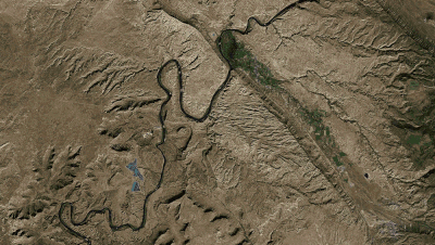

In ArcGIS Pro, I’ve set my basemap to Aerial and navigated to an especially topographically interesting part of the United States around Moab, Utah.

Here, I’ve settled on a gradient that is full black all through the shadows, transitioning into a transparent slate blue in the mid ranges (areas of flat topography). Then the transparent slate blue transitions to the magentas and golds on the steepest sunrise-facing slopes, right into full white. The resulting hillshade layer, when drawn on top of the aerial imagery, looks like this…
That is a really big difference from the raw aerial imagery we were looking at a moment ago. Now, the hillshade layer is painting in the long deep blue shadows and splashing the vibrant golds of sunrise against the steep sunny-side faces of the terrain. I like it.
