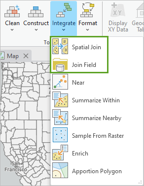

These videos have showcased how you can use Data Engineering to join fields using the Add Join tool. However, ArcGIS Pro has a few other ways to join layers. The Integrate group of tools contains the Spatial Join and Join Field tools. The Spatial Join tool enables you to join fields based on their spatial relationship to the input features. The Join Field tool lets you transfer one or more fields to the input table permanently. You can access these tools from the Data Engineering ribbon, in the Tools groups and the Integrate menu, or by right clicking fields in the fields panel or rows in the statistics table.
Tools Integrate menu
