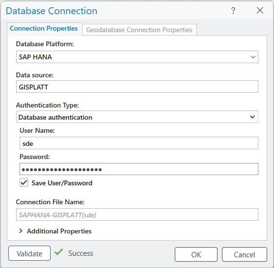

Make a database connection in ArcGIS Pro as the sde user. The connection file is the input to the Enable Enterprise Geodatabase tool, so you must save the username and password with the connection.
- In the Catalog pane, right-click Databases or a folder under Folders, and choose New Database Connection.
- In the Database Connection pane, add the following parameters:
- For Database Platform, choose SAP HANA.
- For Data source, enter the configured SAP HANA ODBC data source name or the supported server-and-port connection value for your configuration.
- For Authentication Type, choose Database authentication.
- For User Name and Password, type the login credentials of the sde user.
- Click Validate to confirm ArcGIS can reach the database.
- Click OK.
The new connection file appears in the Catalog pane under Databases.

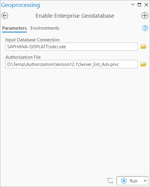

To use the Enable Enterprise Geodatabase geoprocessing tool in ArcGIS Pro to create the geodatabase in SAP HANA, you must provide the following:
- The sde database connection file you created earlier (.sde)
- The ArcGIS Server keycodes authorization file
The tool creates the geodatabase system tables, views, functions, and procedures in SAP HANA.

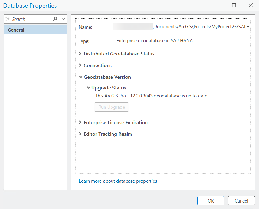

After enabling the geodatabase, verify core functionality first and then move into routine administration practices. To verify the deployment, complete the following steps:
- Right-click the geodatabase administrator database connection and select Properties.
- Review the General tab of the Database Properties pane for properties such as Type and Geodatabase Version.

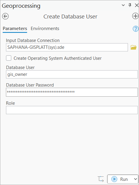

You can create a standard database user using either the database tools or in ArcGIS Pro using the Create Database User geoprocessing tool. By default, this tool creates a standard user that can create data in their own schema and read system tables.

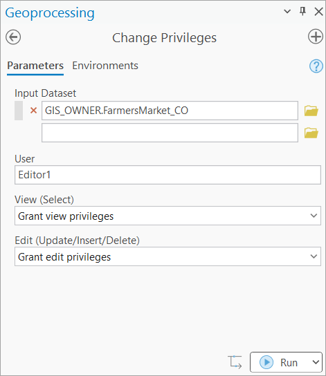

As the data owner, use ArcGIS to grant or revoke privileges on geodatabase datasets. Use the Change Privileges geoprocessing tool to grant or revoke view or edit access on datasets, feature classes, and tables to other users.

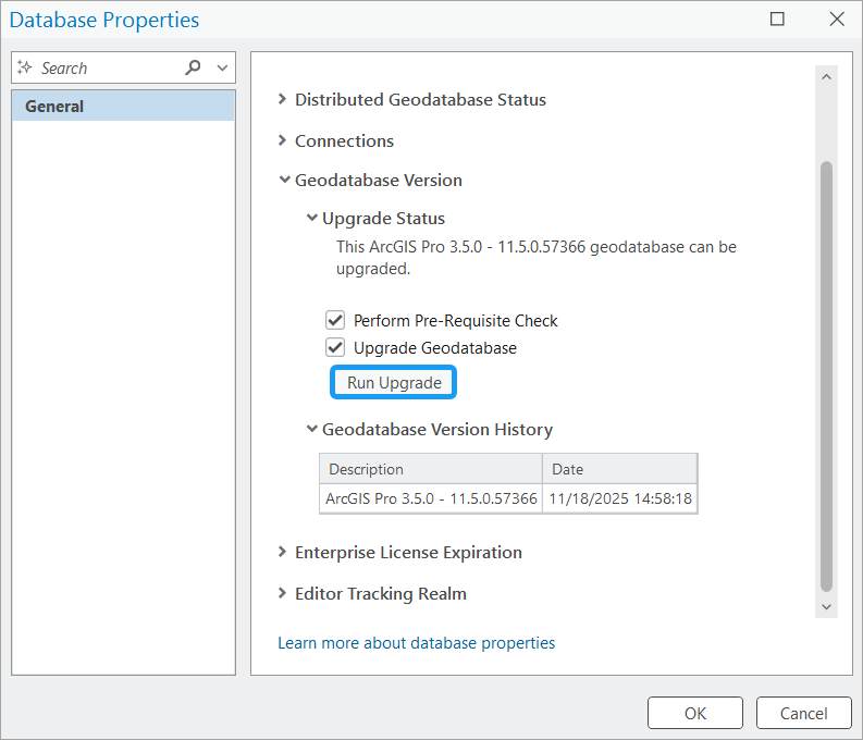

Upgrade planning should include the SAP HANA database, SAP HANA client, ArcGIS clients, geodatabase, custom applications, and published services. Before upgrading the production environment, test the full combination in a nonproduction setting, verify a recoverable backup, stop edits, remove active connections, and ensure the sde user has the documented temporary schema privileges required for upgrade.
Geodatabase upgrade checklist
Use the following checklist to prepare for and initiate upgrading:
- Review current ArcGIS requirements for the target SAP HANA version and confirm client and geodatabase compatibility.
- Confirm the geodatabase is eligible for upgrade through the Database Properties pane in ArcGIS Pro.
- Backup the database and verify the recovery procedure.
- Temporarily grant the sde user the documented privileges on every schema containing data registered with the geodatabase.
- Run the Upgrade Geodatabase tool with the prerequisite check enabled.
- Validate dependent applications and services, and revoke temporary elevated privileges.
