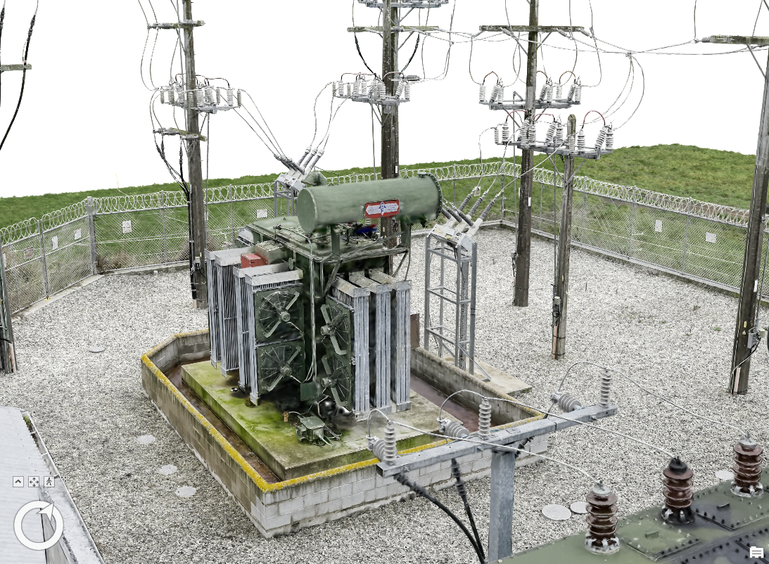

Gaussian Splats – A New Era of High-Fidelity 3D
This release introduces Gaussian splats, a new 3D layer generated from drone or aerial imagery. Gaussian splats excel at capturing fine-grained details of infrastructure, vegetation, and urban environments with exceptional fidelity, creating a more immersive GIS experience. Plus, you can generate Gaussian splats layers in your desired spatial reference, ensuring seamless integration into existing GIS workflows.
Imagery provided by Network Waitaki Limited. Gaussian Splats layer of Pukeuri substation in New Zealand

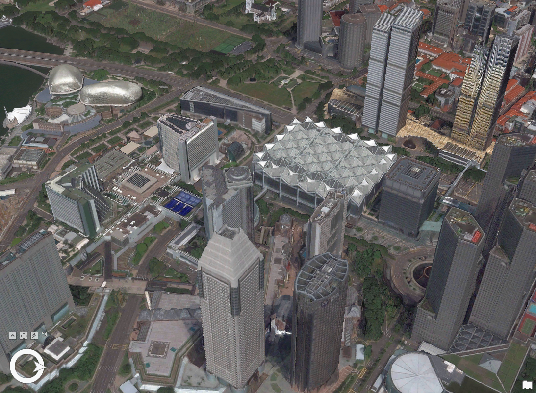

Expanded Satellite Support
ArcGIS Reality for ArcGIS Pro now supports the full constellation of Vantor’s WorldView Legion satellites, giving users access to the next generation of very-high-resolution imagery—including up to 15 cm HD quality—directly within their workflows.
With this added support, organizations can seamlessly ingest, process, and analyze Legion imagery to generate high-fidelity 3D meshes, DSMs, and True Orthos for rapid situational awareness and global monitoring.
Imagery courtesy of Vantor – Singapore DSM Mesh generated from 30cm Worldview Legion, Worldview 3 and Worldview 2 imagery

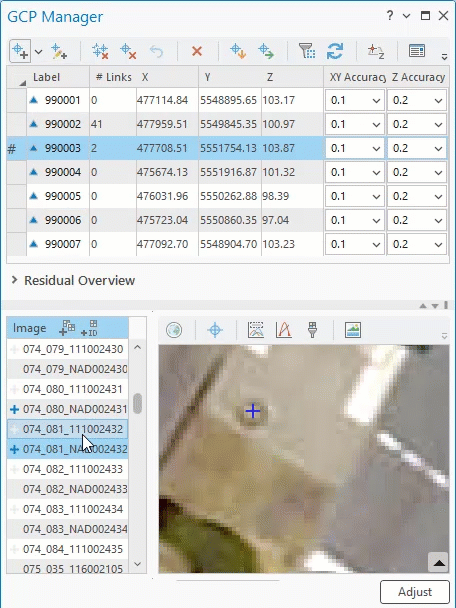

GCP Manager: Precision Made Easier
Ground Control Points (GCP) are central to producing accurate Reality Mapping outputs. This release delivers significant workflow improvements that streamline GCP management and boost precision.
  • Improved Auto-Correlation Accuracy
    Improved algorithms deliver more reliable GCP matches, reducing mis-correlations and improving overall alignment quality.
  • Manual GCP Tagging
    Users can now manually tag GCPs on multiple images before running auto-correlation.  This reduces blunders, improves matching confidence, and improves alignment accuracy.
  • Quality-Based Sorting of Tagged GCPs
    After tagging, images can be sorted based on a calculated quality score—ascending or descending. This makes it easier to spot outliers, detect issues, and correct errors faster.
GCP Sorting
GCP Sorting
