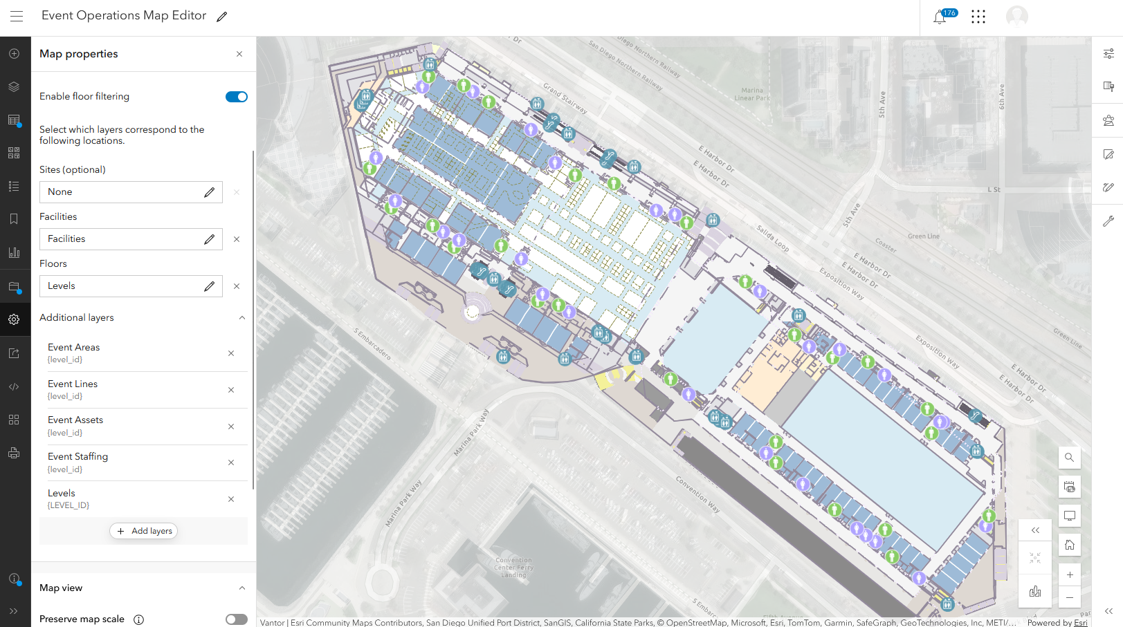

Enable floor filtering on solution maps
To begin extending the Special Event Operations with indoor mapping, your indoor event venue layers must be added to three of the solution’s web maps and floor filtering must be enabled on selected layers in each web map.
To enable floor filtering on the Event Operations Map Editor map, follow these steps:
  • Open the web map in Map Viewer, and add the indoor hosted feature layers of your event venue. In the Layers widget, move the layers to the bottom of the layer list.
  • Click Map properties, and then click Enable floor filtering.
  • In the Facilities field, select Facilities.
  • In the Floors field, select Levels.
  • Under Additional layers, click the Add layers button. Select Event Areas, and then click Next.
  • Select Floor level, and then click Add.
  • Repeat these steps for Event Lines, Event Assets, and Event Staffing layers. For each layer, the corresponding floor field is named Floor level. If the indoor feature layer of your event venue includes additional sublayers, select those as well and for the corresponding floor field, select Floor ID.

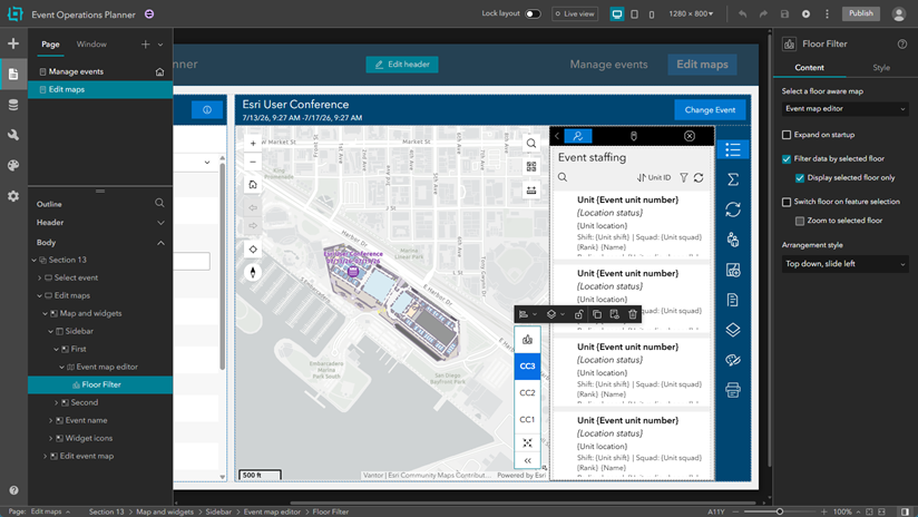

Add Floor Filter widget to Event Operations Planner app
After you enable floor filtering for the web maps used in the solution, you must add the ArcGIS Experience Builder Floor Filter widget to all three of the ArcGIS Experience Builder apps in the solution (Event Operations Planner, Event Operations Maps, Special Event Maps). Because these apps all have custom designs for small-screen devices, you must add the widget twice for each app—once for the large-screen device view, and once for the small-screen device view.
Event coordinators use the solution’s Event Operations Planner app to manage events and prepare operational maps. To add the Floor Filter widget to the Event Operations Planner app, follow these steps:
  • From your Contents tab, click on the Event Operations Planner web experience, and then on the next page, click Edit.
  • In the left side panel, click the Page button, and then click the Edit maps page.
  • Under Body, click to open Section 13, and then click Edit maps.
  • In the left side panel, click the Insert button, and then drag the Floor Filter widget onto the bottom-right corner of the map.
Note: Whenever you add a widget to a map, avoid placing the widget over other map tools.
  • Ensure that the widget is selected, then on the right-side widget properties panel, click Filter data by selected floor, Display selected floor only, and then under Arrangement style, select Top down, slide left.
  • In the top panel, click the Edit your page for small-screen devices button.
  • Repeat the preceding steps to add and configure the Floor Filter widget for small-screen mode.
  • Click Save, then click Publish.
