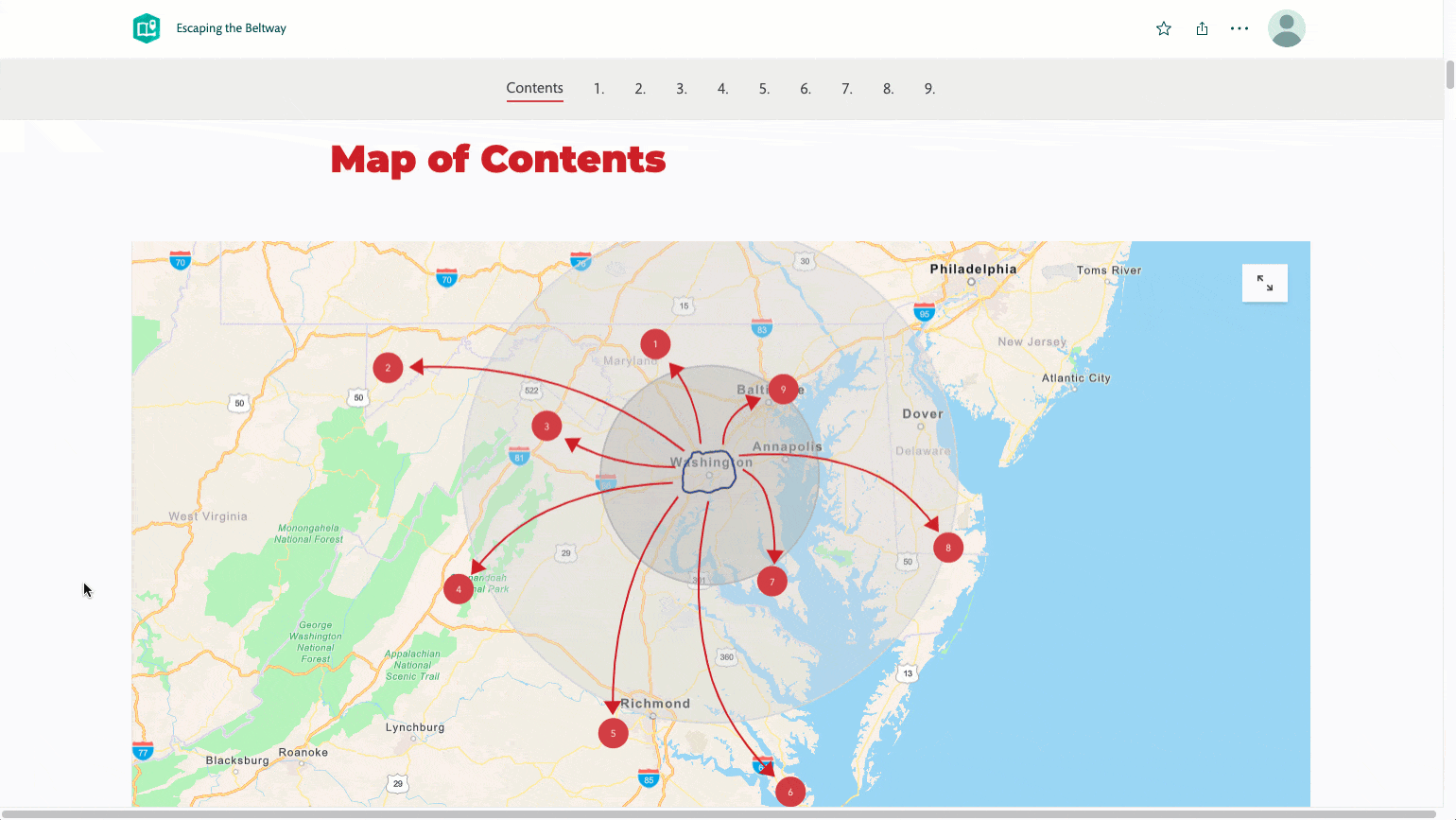

An animation of an express map in StoryMaps with a bunch of numbered pins; each pin contains a link to another section of the story that it represents
In the story “Escaping the Beltway,” the author put together an express map with numbered points that reveal a pop-up when clicked. Those pop-ups each contain a link to the part of the story covering a particular travel itinerary. The heading text was used verbatim—”Blue Ridge special” in the animated example—to indicate to the reader that they can jump to that section.

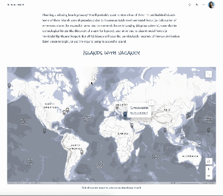

An animated image depicting how the table of contents map in the story "Abandoned Islands" works
In “Abandoned Islands,” we see the author added the text, “Scroll to this island,” below the title of the island, and at the bottom of that section, a “Back to map” link was added so the reader could easily jump back up to the table of contents.

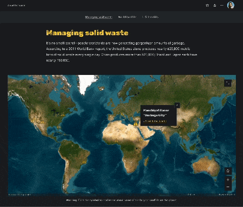

An animated image depicting how heading links are used to create a table of contents map in the story "World of Waste"
Finally, in “A World of Waste,” the author added a down arrow along with the text, “Scroll to this landfill,” which is then partnered with an up arrow and “Go back to world map” at the bottom of each section.

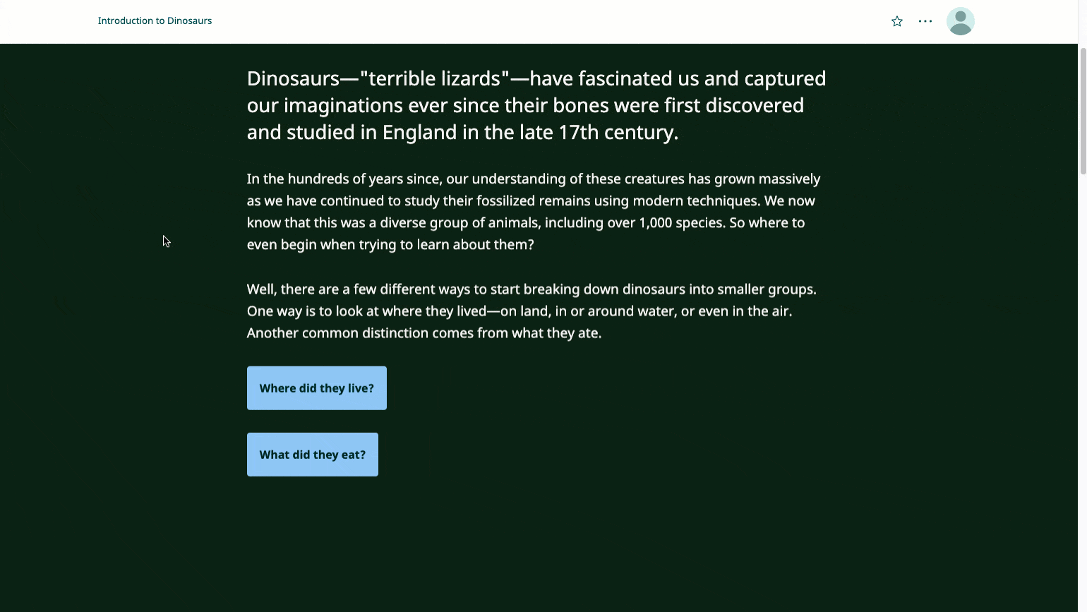

Heading links make that kind of nonlinear storytelling easily achievable with ArcGIS StoryMaps, allowing for an innovative, interactive, “choose-your-own-adventure” type of experience. Multiple buttons at the end of a section can lead elsewhere in the story, either backwards or forwards. This approach could be especially fun for content that’s geared towards a K-8 educational audience.
An animation of a reader navigating through a story about dinosaurs with buttons providing choices about which part of the story to read next
In this hypothetical story about dinosaurs, buttons give the reader a choice regarding what to learn about next.
