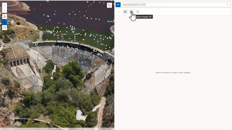

More precise searches in 3D scenes
Searching for the right image is especially challenging when assets aren’t on the ground. With 3D‑aware oriented imagery search, image queries can now take elevation into account.
GIF showing oriented imagery 3D search
When you click a location in a 3D scene, the viewer captures the full (X, Y, Z) coordinate and uses that height to filter and rank results. Instead of defaulting to ground‑level imagery behind an asset, the viewer returns images that reflect the actual elevation and viewing angle of what you selected, like rooftops, bridge decks, tower tops, or upper stories of a building.
This results in more relevant image matches for faster, more efficient workflows.
3D‑aware search is now supported in Experience Builder apps, Instant Apps, and the Oriented Imagery Viewer component in the ArcGIS Maps SDK for JavaScript.

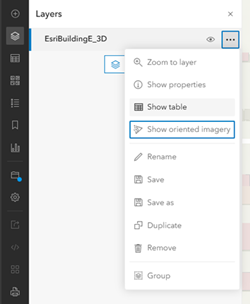

A more natural integration with Map Viewer
The oriented imagery viewer is now launched directly from the oriented imagery layer in Map Viewer. With a layer selected, the viewer opens from the layer’s options menu (consistent with how other ArcGIS layer tools are accessed).
Screenshot of the layer menu in Map Viewer with the new option to show oriented imagery
Because the viewer is now associated with the source layer rather than the web map, it opens in the center panel, providing more space for imagery and greater flexibility when working with maps that include multiple layers or views. Users can also open and switch between viewers for multiple oriented imagery layers as needed (only one viewer is active at a time), and use map tools without closing the oriented imagery viewer.
