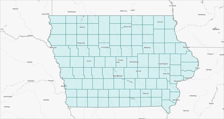

So let’s start by drawing all the counties in Iowa on the map in their own layer. Might sound hard to do, but the Generate Standard Geography Trade Areas tool makes it pretty snappy. We’ll name that layer Iowa_counties so it’s easy to identify. For good measure, let’s enrich the layer with the psychographic variable Vote in National Elections: Always, and use this layer, Iowa_counties_EnrichLayer, in the analysis. Using this variable provides data on the amount of likely voters in each county.
Counties in Iowa mapped as trade areas

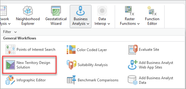

Designing territories requires that you take lots of factors into account: geographic information (such as facility locations and travel barriers) as well as business information (such as work capacity and personal preferences). You feed these constraints into the tool and then “solve” the complex problem you’ve set up. So let’s go ahead and set up your problem, starting by opening the Business Analysis menu and clicking New Territory Design Solution:
New Territory Design Solution button

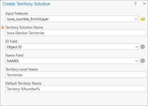

The Create Territory Solution tool opens as a free-floating window. It looks like a ton of parameters to fill out, but it’s actually only a couple. For Input Features, you’ll grab your Iowa_counties_EnrichLayer layer, name the territory solution Iowa Election Territories, and specify ID Field as Object ID.
Once your pane looks like this, click OK:
Territory solution parameters

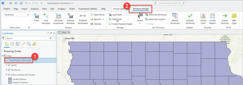

Now that we have the skeleton of a territory solution in place, if we click the Iowa Election Territories group layer, a Territory Design tab appears on the top ribbon in Pro. Go ahead and click it to see the territory design tools at your disposal:
Territory Design ribbon in ArcGIS Pro

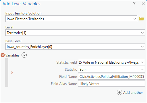

First we’ll add the variable to the Territories layer, then we’ll use it to balance the territories and distribute work evenly. Let’s click Add Variables, and in the Add Level Variables geoprocessing tool that opens, the Variables drop-down menu allows us to choose the voting variable from the enriched layer:
Adding variables
After setting Statistic to Sum and giving the variable the alias Likely Voters, click OK.

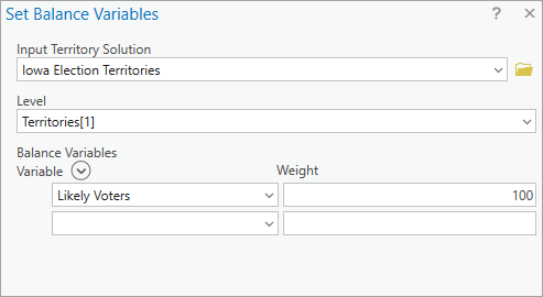

Now that the variable is part of the equation, let’s actually tell the tool to balance the territories based on this variable by clicking Balance Variables on the ribbon. In the Set Balance Variables tool that opens, we’ll pick the voting variable (given the convenient alias “Likely Voters”) and set the weight to 100. Since this is a simple version of territory design, that’s all we’ll add! But in more complex design sessions, you could add many variables and weight them according to their importance.

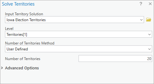

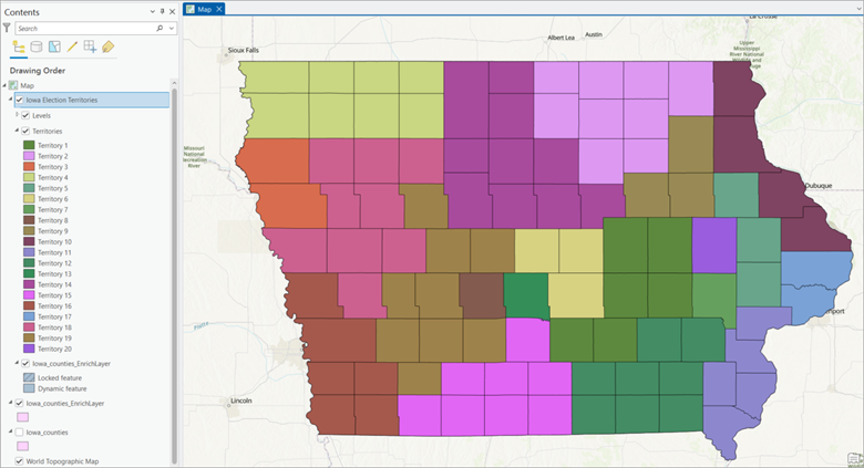

Finally, on the Territory Design ribbon, we get to click Solve. The tool that opens, Solve Territories, is pretty simple: we tell the tool that we (the user) will define the number of territories we need, and enter that number. To divide up the 99 counties into territories that are evenly distributed based on the number of voters in each county, we’ll enter the number of election workers: 20.
Solving the territories

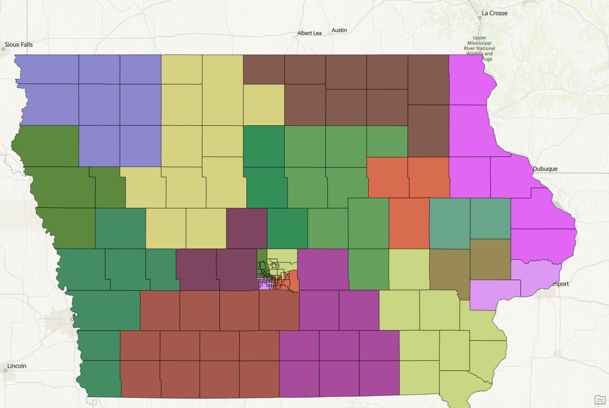

Once we click OK, the magic happens. The counties are grouped into territories, visible on the map by color-coding.
Iowa election worker territories
Taking a look at the territories, a few things become apparent:
  • There are several single-county territories concentrated around population centers (Des Moines, Cedar Rapids, Iowa City).
  • Less populated regions tend to be grouped together.
  • There are a handful of awkwardly shaped territories that could possibly be improved.

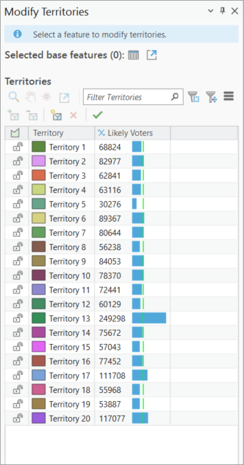

When we open the Modify Territories pane, we also add this to our observation list:
  • Territory 13 is comprised solely of Polk County, which contains Des Moines, and has a much larger number of likely voters than any other territory.

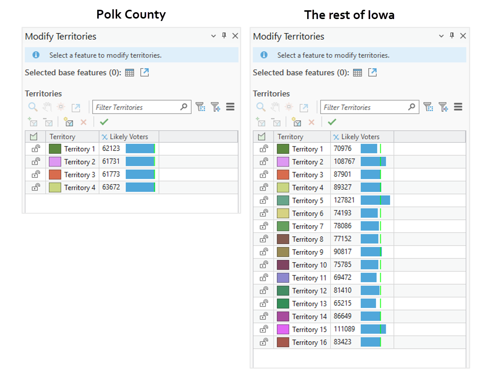

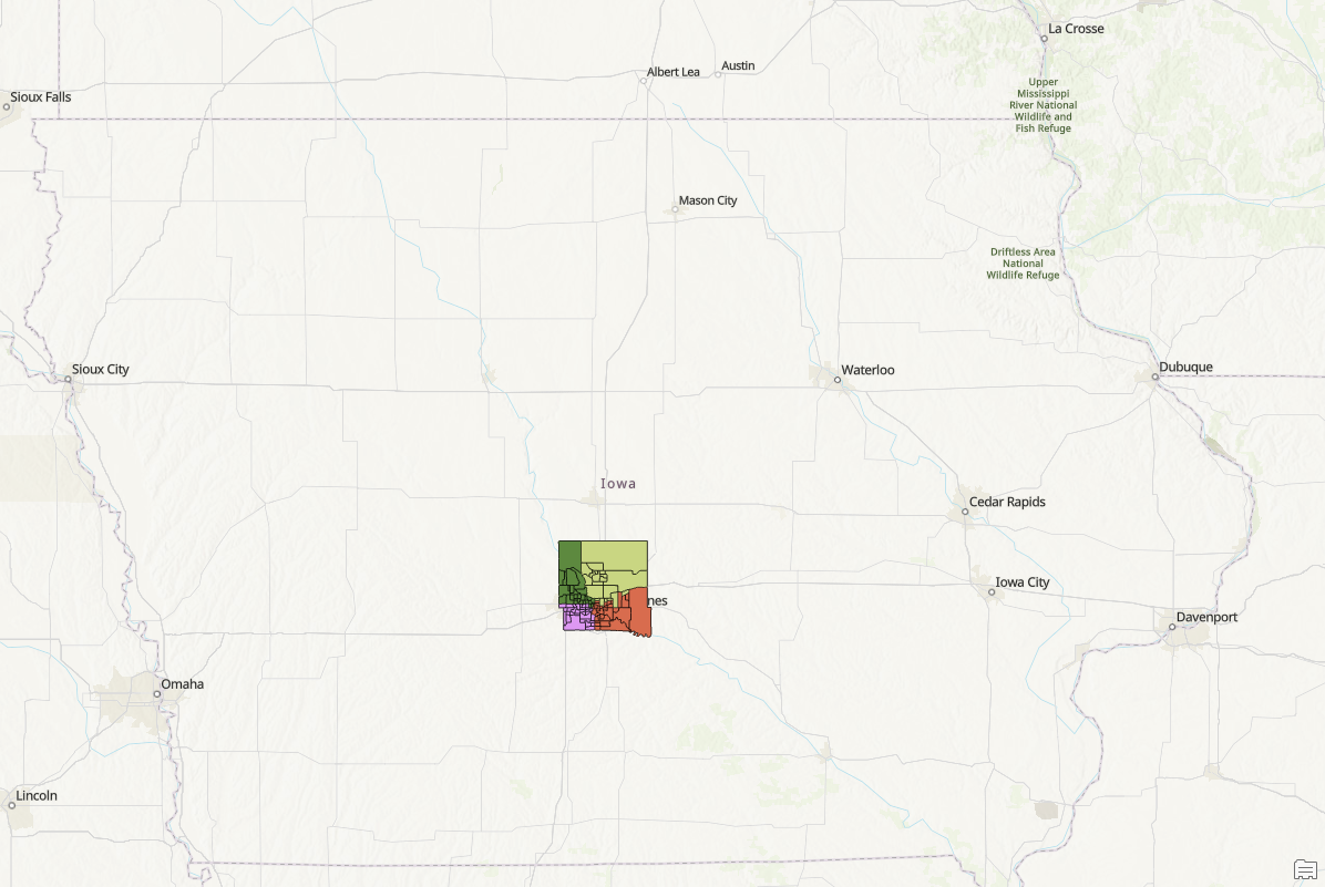

Half the fun of territory design is fiddling with the geographies and parameters to find the best solution for your use case. It’s not uncommon to solve and re-solve the territories multiple times as you zero in on the best design! For example, to deal with the disproportionate amount of people living in Polk County in our Iowa example, we could create a new territory solution for just that county, using census tracts and allotting four of our twenty election workers to that county. (If you’re interested in reading up on this type of geography conundrum, see Modifiable areal unit problem in Esri’s GIS Dictionary.)
Polk County territories

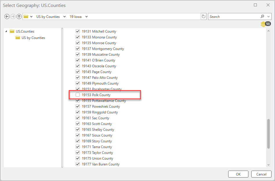

Of course, that does mean going back and redoing the state-wide territories to exclude Polk County:
Omitting Polk County from statewide territory solution

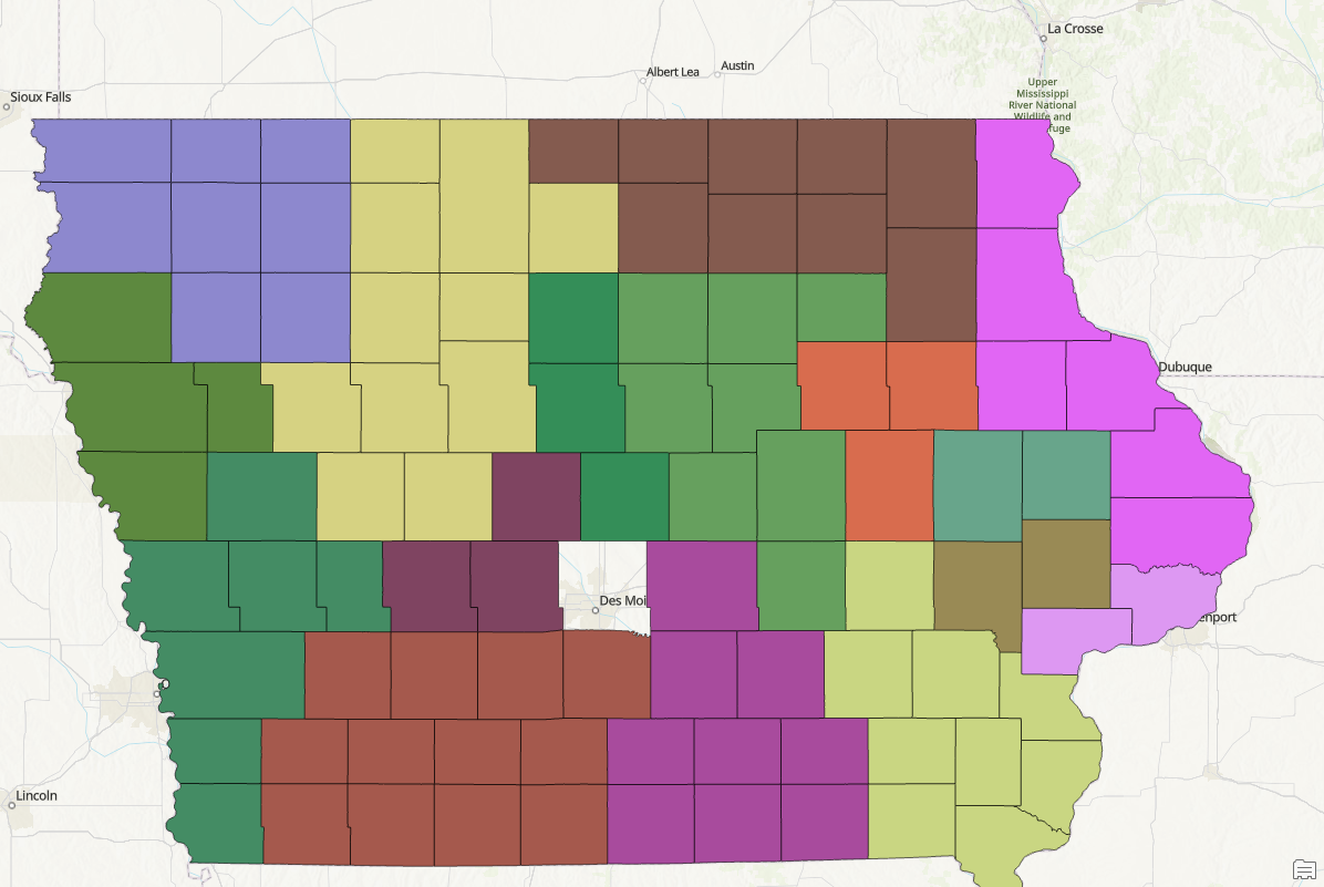

When we rerun the solution omitting Polk County, adjusting our available election workers to sixteen rather than twenty, we get this neat little Polk-hole in the state’s territories:
Iowa territories without Polk County
Then we toggle on our Polk County territories, and we’ve got a more balanced map.
New Iowa territories
The territories aren’t perfectly balanced, but the disparity across territories is much better than before, when some territories had 55,000 likely voters and others had over 200,000:

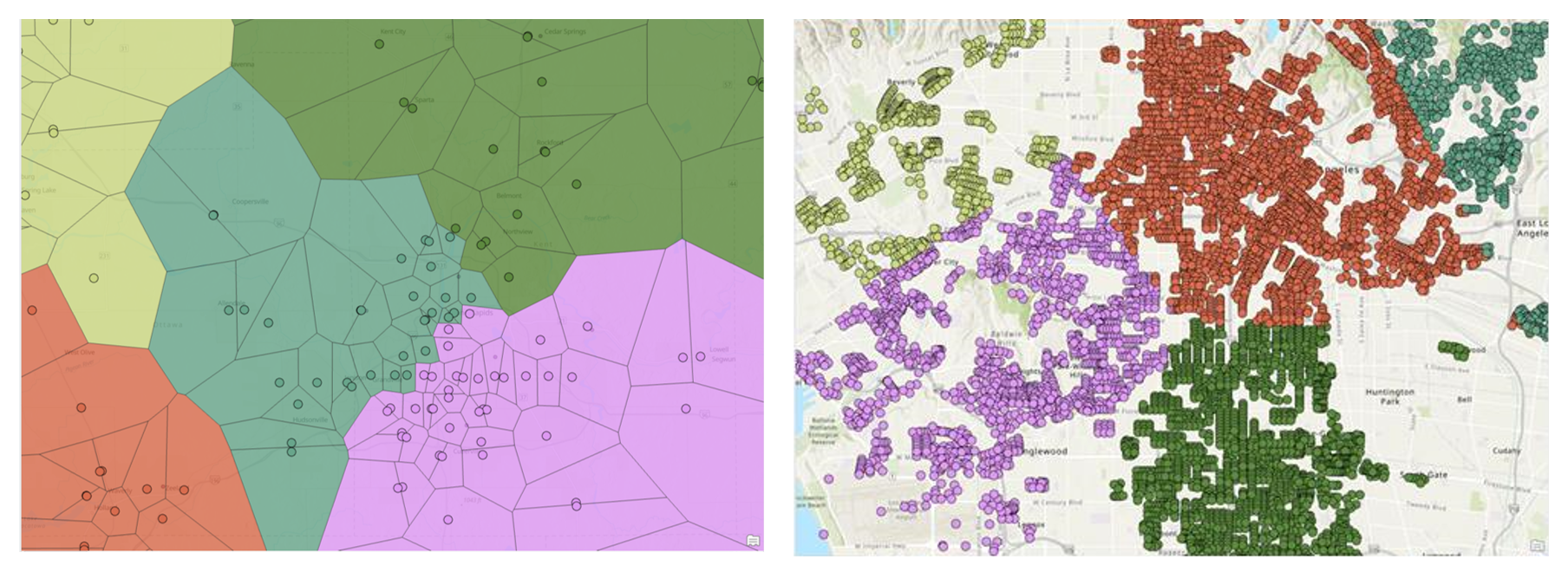

There are tons of ways to keep exploring territory design, working with things like barriers and seed points. You might continue your territory design journey by taking the Design territories for college recruiting tutorial or checking out territory design videos on the Business Analyst Pro video channel.
