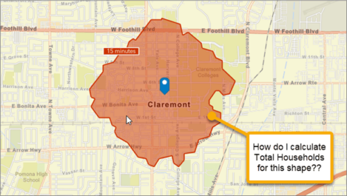

As an example, say you create a 15-minute walk-time around your grocery store. You could use the Enrich Layer tool to add the number of households inside the area, or their average spending per year on groceries. Those are just two of the more than 15,000 Esri data variables available to enrich with, and data enrichment can be performed in 170+ countries.
Map of 15-minute walk time around downtown Claremont, CA

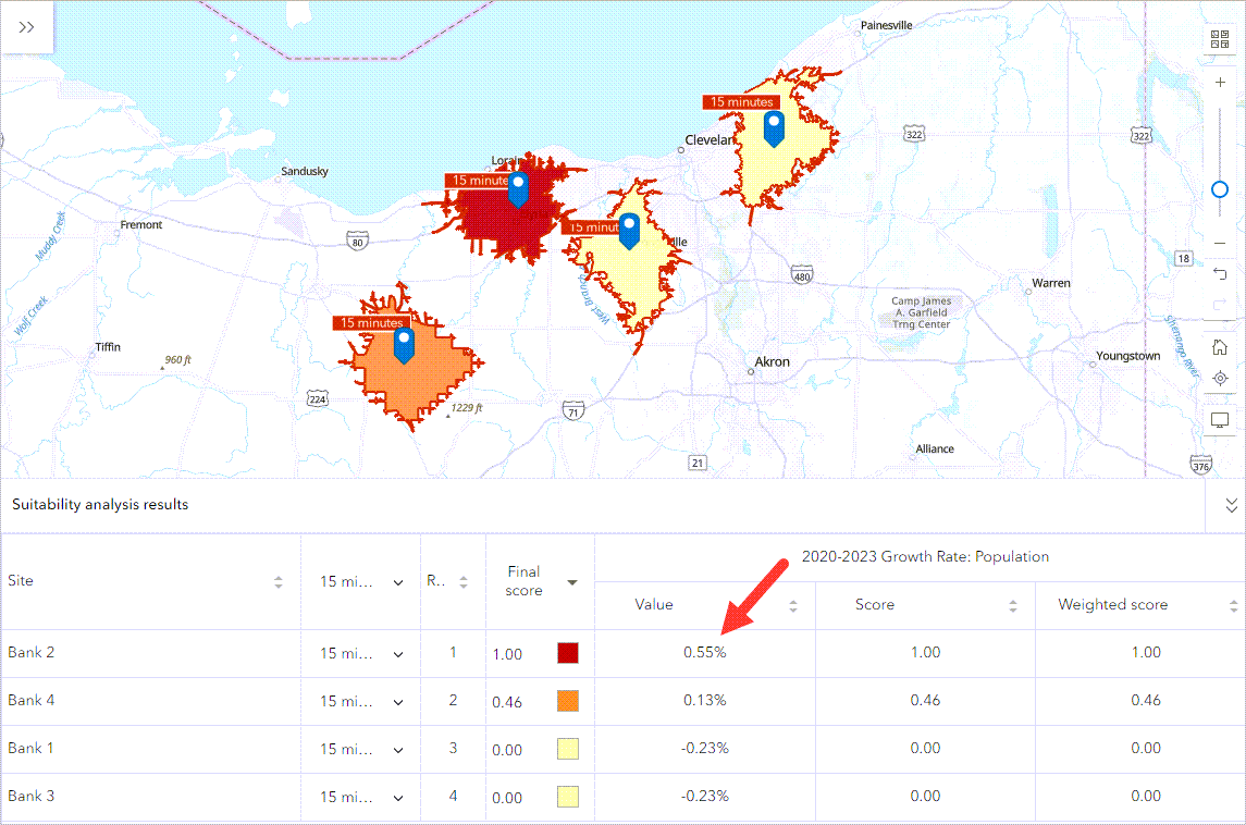

Fortunately, you can data enrich your bank territories with the Esri 2020-2023 Population Compound Annual Growth Rate variable to quickly see which areas are gaining (or maybe losing) population. Importantly, you are able to data enrich just your areas of interest like the bank territories. No need to spend time extracting only what you need from larger county or state datasets.
Map of enriched territories

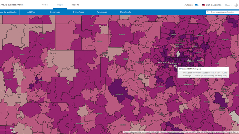

You can access ArcGIS GeoEnrichment Service in a number of ArcGIS products, including ArcGIS Online, ArcGIS Business Analyst Web App, ArcGIS for Microsoft 365, and more. GeoEnrichment Service is also available as a REST service for the developer community and is accessible through a number of APIs.

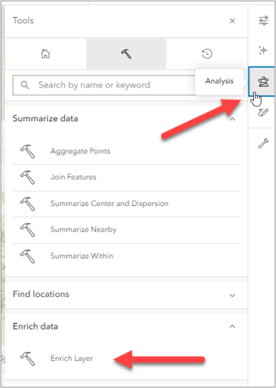

Once logged into ArcGIS Online, the Enrich Layer tool will be found by clicking the Analysis button on the right side of the interface, and then selecting the Enrich Layer tool.
Picture of enrich tool in ArcGIS Online.

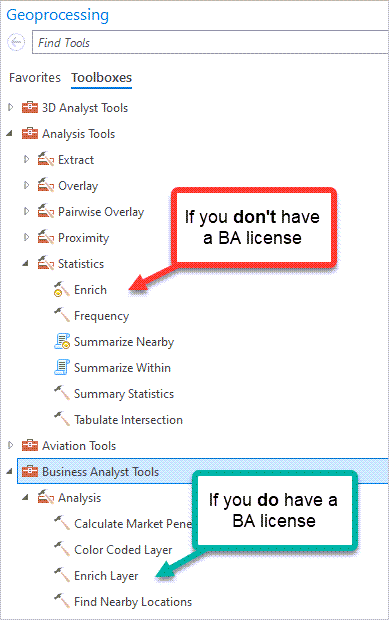

You can perform data enrichment in ArcGIS Pro in a couple of ways: by accessing ArcGIS GeoEnrichment Service (aka connecting to online data or a portal), or by using demographic data you downloaded from Esri (aka Business Analyst local data).
The first option doesn’t require any Business Analyst licensing; you can just use the Enrich tool in the Analysis toolbox > Statistics toolset. This tool uses the online data source to perform data enrichment. You do need an ArcGIS Online organizational account with at least a Publisher role.
The second option requires an ArcGIS Business Analyst software license or subscription and locally stored Business Analyst data. With those, you can then use the Enrich Layer tool in the Business Analyst toolbox > Analysis toolset to perform data enrichment.
ArcGIS Pro toolboxes with enrichment tools

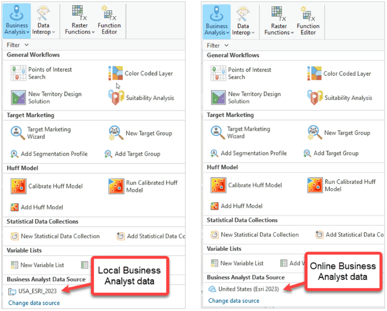

If you want to enrich using locally stored Esri Business Analyst data be sure to set your local data as the data source. Note that you can still use online data as your data source if preferred.
Image of Business Analyst data sources

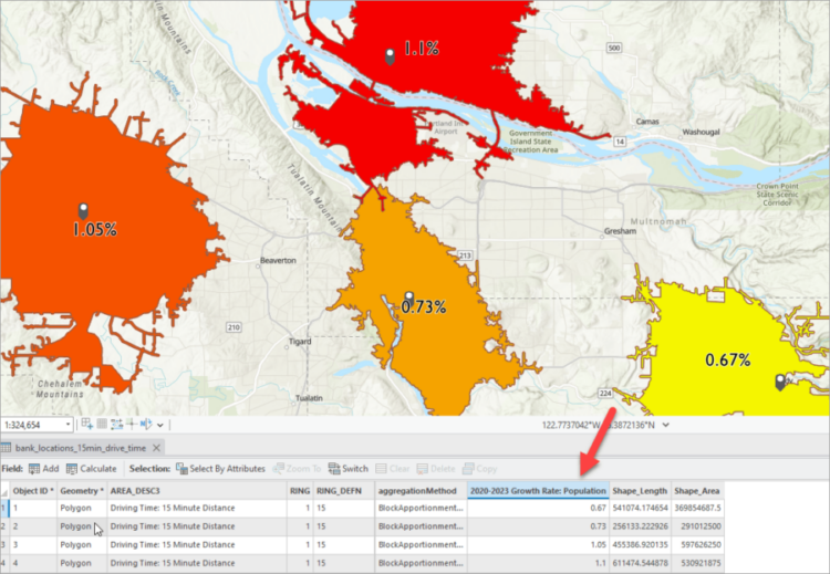

Once you specify an area and what data you’d like to enrich with, the tool runs the calculation and appends the information to your feature class. The figure below shows Esri 2020-2023 Population Compound Annual Growth Rate, enriched in ArcGIS Business Analyst Pro:
Map image of enriched territories

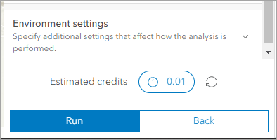

If you are using online data as your source for data enrichment—essentially pulling the data over the internet into your system via ArcGIS GeoEnrichment Service—this costs credits to your organization. To understand the credit usage, see the Enrich section of the Geoprocessing tools that use credits page. Many tools will provide an estimated credit usage before you run them.
Image of credit usage in AGOL

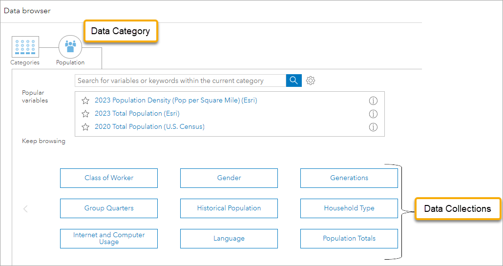

There is a large catalog of data enrichment variables you can use. The main hub for exploring the variables is the data browser.
Within the data browser, data enrichment variables are organized using a two-tier system of data categories and data collections. Data categories are broad data groupings, such as Population or Housing. Within each category, variables are further organized within finer data collections, such as the Generations collection within the Population category, shown in the image below. The number of data categories and collections varies by country.
For developers, there is also a Data Collection Finder tool to help locate variables.
Picture of data categories and collections
