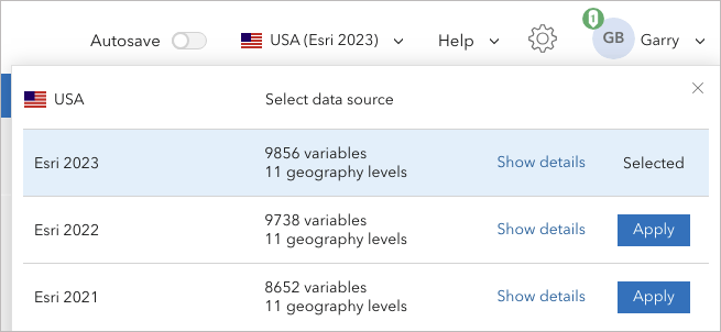

By default, when you log in to Business Analyst and you are using data in the United States, the application is set to use the most recently available content.  You can use the country switcher in the application to access data from 2021, 2022, and 2023:
Country switcher showing data sources

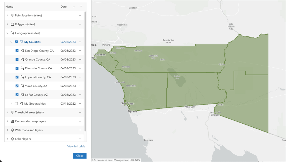

For example, I have a set of counties that I previously created in 2022 to perform analysis in the southwestern United States. When I switch between accessing the 2023 and 2022 U.S. data sources, these counties are still available.
Previously created county sites

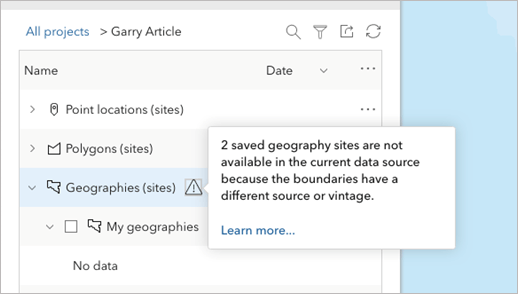

If you have saved standard geography sites for these four levels, you will see a warning message like this in the project pane:
Warning message

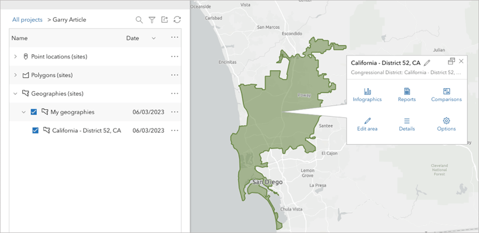

Let’s dig into what this means in practice. I previously created a project in Business Analyst Web App that contained my congressional district in the Esri 2022 data source:
Congressional district in Esri 2022 data source

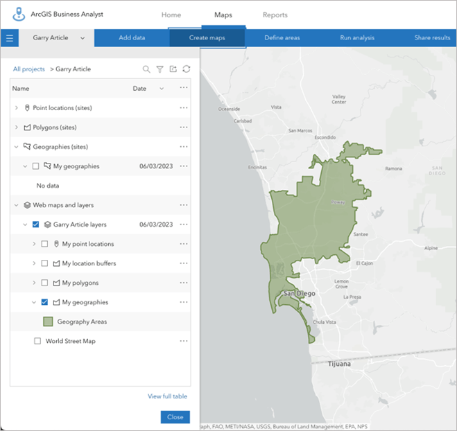

As long as I am working in the Esri 2022 data source, I can continue to work with this geography-based site to create reports, infographics, and run analyses. However, if I switch to the latest Esri 2023 data source using the country switcher, I see that “No data” is listed under this folder, where I’d expected to see my geography sites:
Missing geography sites
To be clear, this standard geography site is not gone – I just need to switch back to the Esri 2022 data source to access the congressional district I created. Because this congressional district was based on a different vintage of data, its borders are incompatible with the new boundaries contained in the Esri 2023 data source.

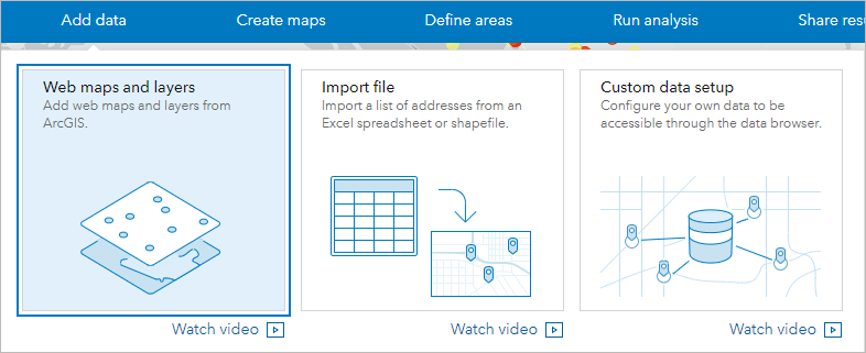

On the Maps tab, start by clicking Add data and select the Web maps and layers option.
Add web maps and layers

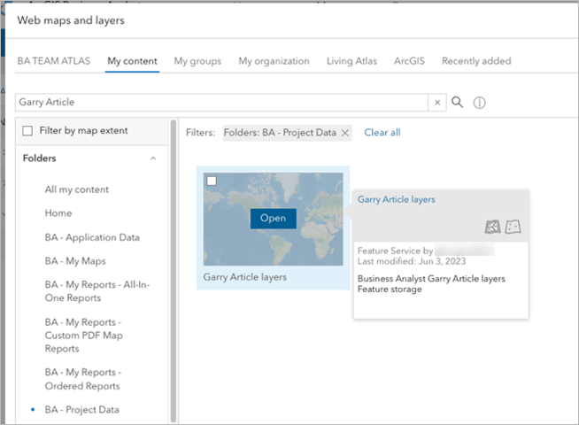

In the Web maps and layers window, select the My content tab at the top and select the BA – Project Data folder on the left panel.
All the map layers from your project are contained in the feature service with your project name. For example, all the content for my “Garry Article” project can be added by selecting this card and clicking the Open button.
Opening layer
All the sites and content for this project are automatically added to the map.

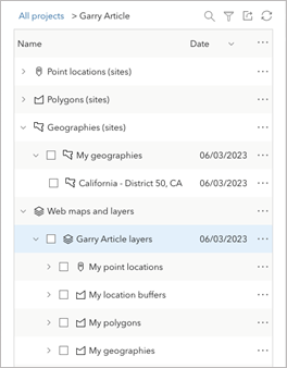

Here you can see that I’ve added the geography site with the old congressional district I previously created with the 2022 data.
Previous geography added to the map
Site added to map

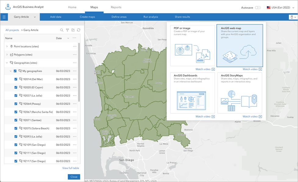

If you have lots of standard geography areas in your project, there may be too many analysis areas to add using the method described above. An alternative approach is to add the individual standard geography sites to the map that you want to migrate from the Esri 2022 data source. Then choose the option to Share results as a new ArcGIS web map. For example, I have a collection of ZIP Codes that I created with the 2022 data here:
Collection of ZIP Codes
Share as web map
Once the web map is created, you can add it to your project while using the Esri 2023 data source by clicking Add data and select the Web maps and layers option. On the My content tab, select the web map you just created to add the areas to the map. Then you can use these areas to help recreate new standard geography sites with the latest boundaries.
