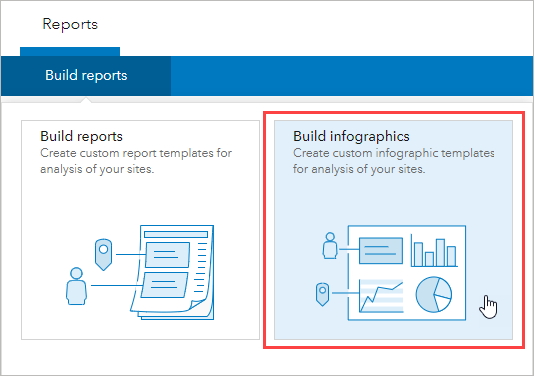

  1. An Advanced user builds a custom template.
Creating a custom infographic template

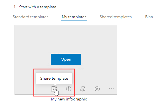

  1. An Advanced user shares the template with their organization.
Sharing a custom infographic template

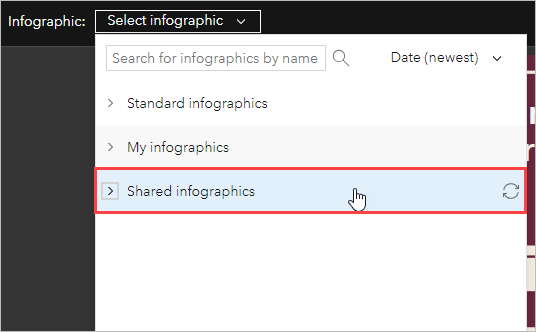

  1. A Standard user can then access and run the custom template.
Running a shared infographic template

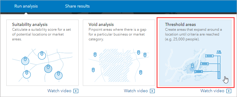

Currently, Standard license users can access only one of these analyses when shared by an Advanced license user: threshold areas. To share the threshold areas they have created, an Advanced user can share the whole project containing the analysis, which can then be accessed by other users regardless of license level.
  1. An Advanced user creates threshold areas.
Creating threshold areas

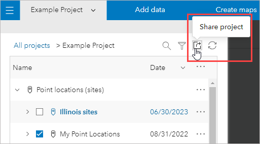

  1. An Advanced user shares the project containing the threshold areas with their organization.
Sharing a project

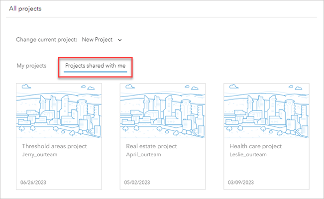

  1. A Standard user can then open the shared project and view the analysis.
Accessing projects shared with me
