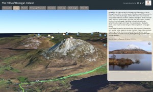

You may remember this post on using 3D web scenes in Story Maps from a few months ago. Since then there have been several Story Maps with 3D content (…Story Scenes?) published like this one from the Trust for Public Land and this one from Donegal, Ireland’s GIS department.
