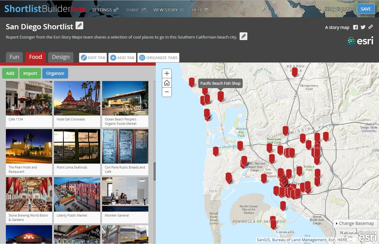

The Story Map Shortlist (beta) app lets you present places of interest organized into tabs, making it fun and easy for people to explore what’s in an area. Shortlist was previously only available as a code download that you needed to host on your own server. With this release Shortlist is available in ArcGIS Online and features an interactive builder that makes it easy to author. The app also has a refreshed look with support for larger images. You can see an example here.
In the Shortlist builder you can add places individually or import them in bulk. This beta release supports photos in Flickr, Picasa/Google+, and referenced via URLs. When you create a Shortlist, the builder creates a web map in which your places are stored (similar to Story Map Tour and Story Map Crowdsource).
You can also use point data in an existing web map to create a Shortlist. For example, if you have a point layer containing places of interest you can use those as places in your Shortlist and optionally choose fields from the layer to appear as descriptive text. You can assign photos to your places in the Shortlist builder, or use photos referenced via URLs from existing fields in your layer.
If you have created a Shortlist using the previous, non-hosted version of the app, your existing Shortlist will continue to work unchanged. You can also migrate your existing Shortlist into the new hosted beta version so you can take advantage of easy interactive place editing and management and support for larger images. When you migrate a Shortlist, the builder automatically creates a copy of your web map so your existing Shortlist app is unaffected. While the new Shortlist does support the smaller photos typically used in existing Shortlists, after migrating you will most likely want to assign larger images to your places in the builder.
To create a Shortlist using existing point data in a web map, or to migrate a Shortlist, simply open the web map in ArcGIS Online and share it using the Shortlist app in the Web App gallery. A wizard will step you through the process.

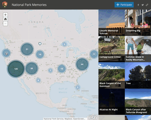

Story Map Crowdsource (beta) has been updated with many fixes and several key enhancements for contributors, readers, and authors.
Contributors have easier and better ways to specify a location. An exact location can now be specified by clicking on the map or by dragging the pin to a new place. Also, when a geotagged photo is uploaded its location will be added to the map.
Readers will enjoy Crowdsource stories even more since there is more interactivity between the photo collage and the map. Hovering over a photo thumbnail highlights that location on the map, and when viewing a single contribution readers can use the new arrow buttons to easily flip through contributions one by one.
To help authors create high quality stories contributors are notified if they try to upload an image that’s too small and they can use this advanced configuration to collect high-quality photos.

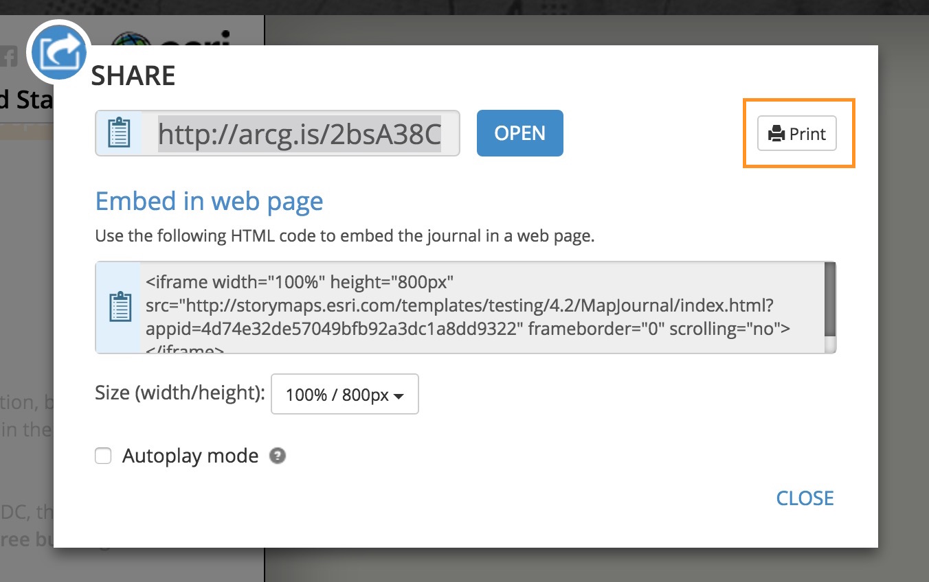

You can now print a Story Map Journal!
Printing is available from the Share panel. Note that content like videos and interactive web apps cannot be printed. This is a first release of this feature and we want to hear your feedback about how it works for you, so please share your reactions and suggestions about printing with us on GeoNet.

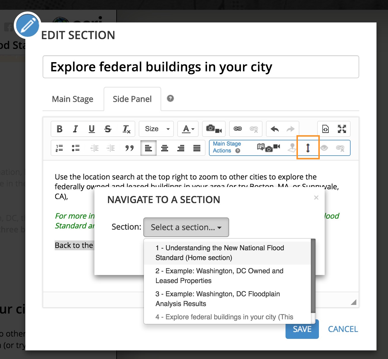

You can create a link to another section. To do this, 1) highlight the text that you want to convert to a link, 2) click the Navigate to a section button in the Actions menu (marked in the screenshot below), and finally 3) choose the section to navigate to.

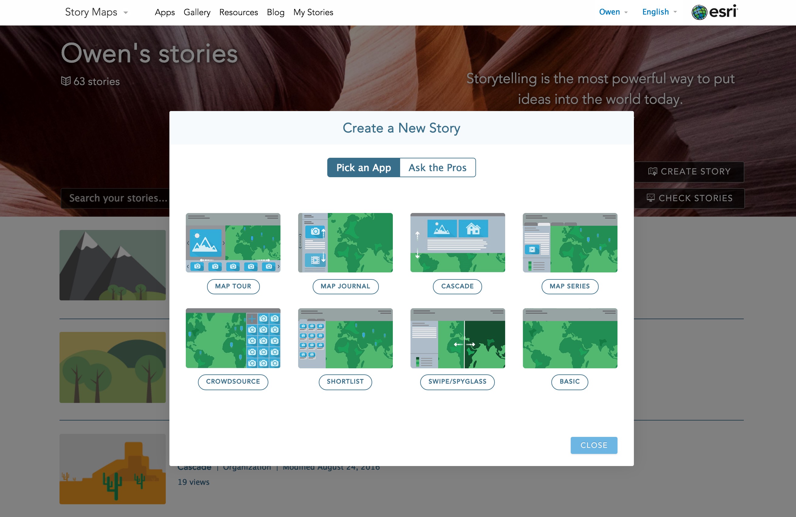

The beta apps have also been added to the Create Story Wizard that can be launched from the My Stories page or from other places on the Story Maps website.
