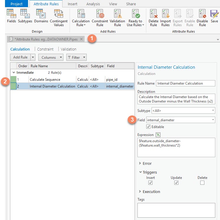

Here is an example of the Attribute Rules view for a Pipes feature class (1) highlighting an immediate calculation rule (2) to automatically populate the Internal Diameter field (3).
Image of the Attribute Rules view, showing all the capabilities.
Instead of using mental math to figure out the internal diameter of a pipe, a formula is pre-built into this dataset using attribute rules. As edits are made, the internal diameter field is automatically populated based on an Arcade script that subtracts double the pipe wall thickness from the outside diameter.

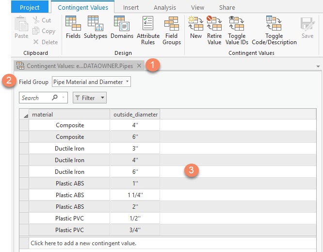

Here is an example of the Contingent Values view for a Pipes feature class (1), in which the field group Pipe Material and Diameter (2) has contingent values assigned (3).

After the pipe material is defined, only the appropriate pipe diameter values associated with that material are available to select from.

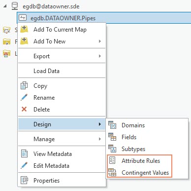

Option 1: Catalog pane
In the Catalog Pane, right click the dataset and select Design.
Image showing how to navigate to the new views from the Catalog pane.

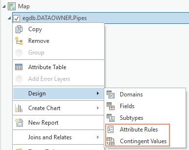

Option 2: Contents pane
If the dataset is in a map, you can right click the layer in the Contents pane and select Design.
Image showing how to navigate to the new views from the Contents pane.

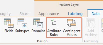

Option 3: Data tab
If the dataset is in a map, highlight the layer in the Contents pane to access the Data tab. The new views are in Design group of the tab.
Image showing how to navigate to the new views from the Data tab's Design group in the ribbon.

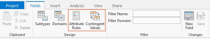

Option 4: Open the views from the ribbon of any other design view. Here is an example of the Fields view, which shows the Subtypes, Domains, Attribute Rules and Contingent Values ribbon buttons to easily access the other views.
Image showing how to navigate to the new views from other design views.
