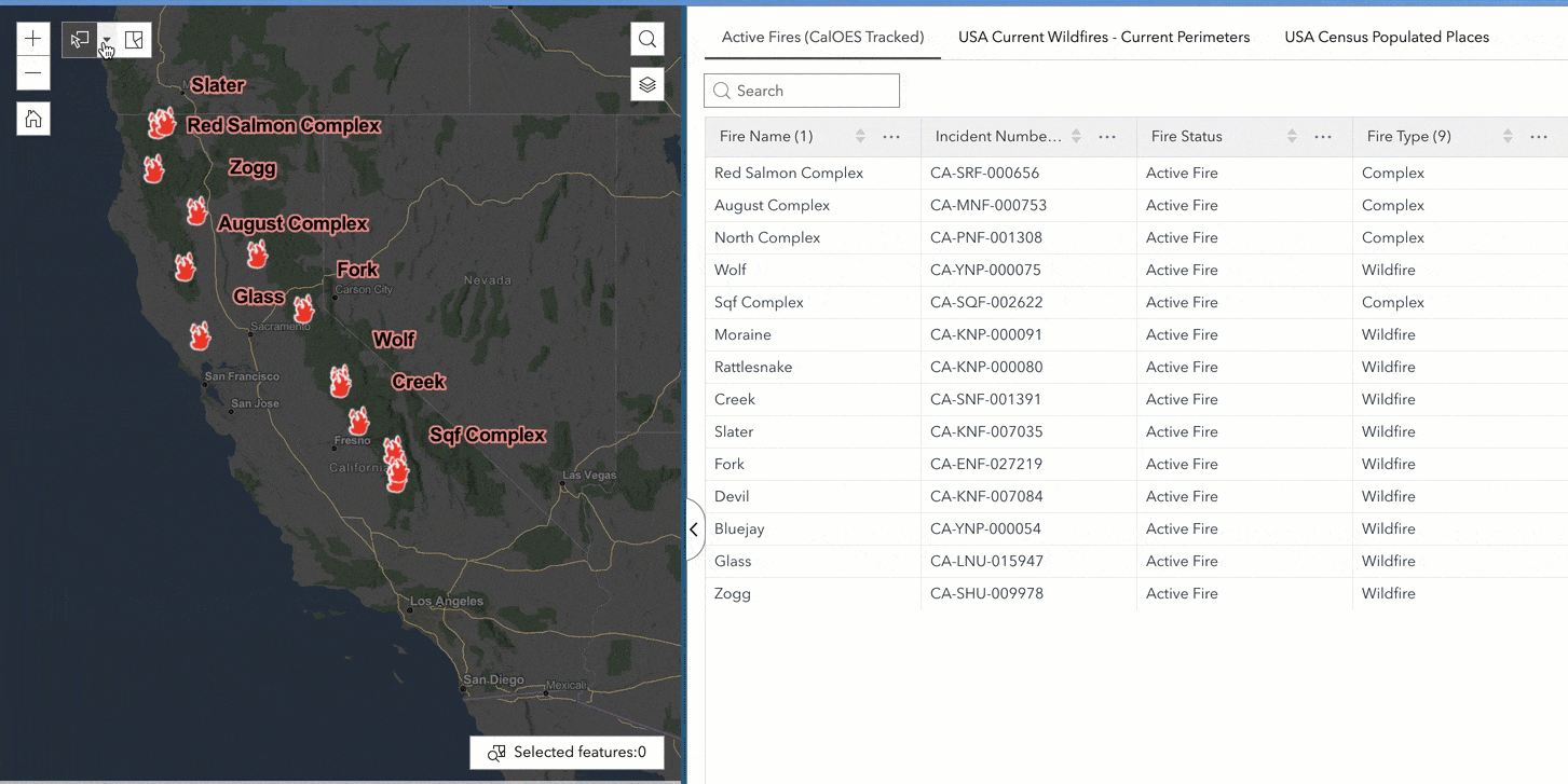

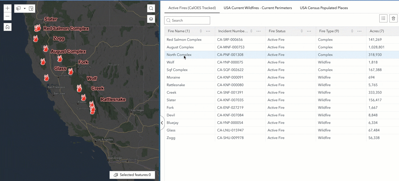

The Table (beta) widget contains one or multiple sheets connected to your data. You can use it as a standalone table or as a table that interacts with the map and other widgets. A common workflow is to filter the table based on selected features in the map as shown below.
Filter table upon feature selection

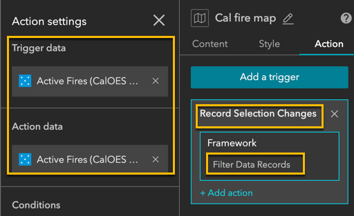

Notice how the table and map work together seamlessly, with no additional clicks after feature selection. To achieve this, set the Record Selection Changes trigger on the map, select the Filter Data Records action under the Framework target, then choose trigger data and action data, which are the same layer in this case.
Actions to filter table
On the other hand, you may want to flash, zoom to, pan to, or even filter a feature in the map based on a selected row on the table.
Flash a feature upon a row selection
This can be done by setting the Record Selection Changes trigger on the table and selecting the Flash action on the map.
Set a trigger on table

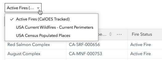

You can also search the table and show a selection of records. When there are multiple sheets in the table, you may use the dropdown list instead of tabs.
Tab or dropdown arrangement
Unlike in the new Map Viewer, editing attributes in the table is not yet available in Experience Builder. You also cannot export selected records to CSV like  you might do using the Attribute table widget in Web AppBuilder. We are aware of these popular requests and plan to add them to Experience Builder in the near future.

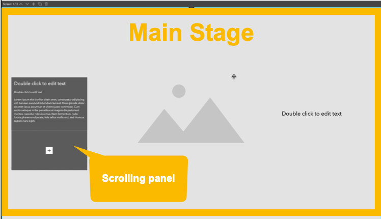

Each screen in the Screen group consists of two parts—Main stage and Scrolling panel. The latter floats on the top of the former or docks alongside. The relationship of screens with Screen group is similar to that of views with Section. You can configure each screen with your choice of widgets, and add or duplicate a screen.
A screen

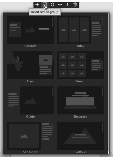

Keep in mind that Screen group only works on the scrolling page. As a block, you must insert it on the canvas through the block toolbar or the end of the page. Eight Screen group templates are provided with various scrolling styles. Preview and choose a template that suits you, and modify screens accordingly. To get started with the Screen group, try the new Parallax default template.

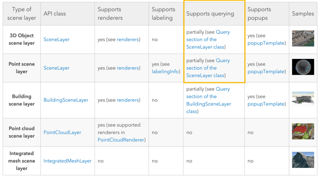

Previously, while you could display a web scene on the map in Experience Builder, the Filter and List widgets did not work with scene layers. In this release, we are happy to announce that 3D object and point scene layers with query capabilities are now supported, as highlighted below. For details, see What are scene layers?
Supported scene layers

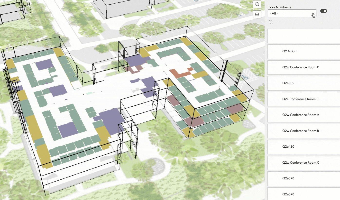

Like feature layers, supported scene layers are listed on the Data tab, and you can create a data view from a scene layer. You may ask what we can do with the scene layer. In the example below, we use the Filter and List widgets to explore the interior space of the Esri headquarters building, then locate a space from a list on the map.
Filter and list a scene layer

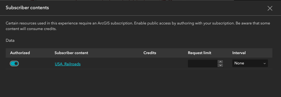

When adding data, you can now directly browse content from ArcGIS Living Atlas of the World. Although much of the content in Living Atlas is publicly available, the subscriber content, which is a collection of layers, requires an organizational subscription account to access. The subscriber content in Experience Builder, similar to Living Atlas, is marked with icons when present in the map, scene, or layers.
Subscriber content marked with icons
When you publish an experience with widgets that use subscriber content, you’ll be prompted to authorize access from your account, so end users are not asked to sign in. Note that the web experience template currently does not support subscriber content. As a result, when you publish a template with subscriber content, the window below will not show.
Subscriber content window

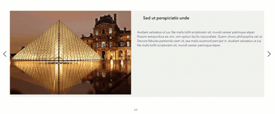

Autoplay views
One of the most popular requests we have received is to autoplay views. With built-in navigation tools and the Autoplay option in Section, you can now create carousel views.
Carousel views

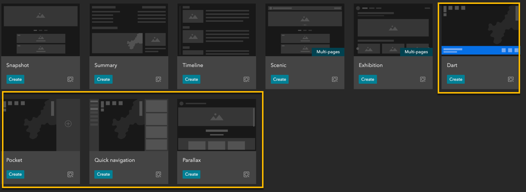

More templates
Four more default templates have been added: Dart, Pocket, Quick navigation, and Parallax. For those familiar with Web AppBuilder, you’ll find that the Dart and Pocket templates bear a striking resemblance to the Dart and Pocket themes. As mentioned earlier, Parallax uses the Screen group. And Quick navigation can be used to explore a map from multiple views and bookmarks.
New default templates
