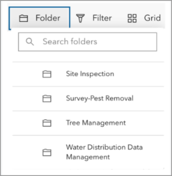

View maps by folder
Folders are the drawers in your map cabinet. They’re used to organize maps and group related content in your ArcGIS organization.
Within Field Maps Designer, the Maps page provides a list of all available maps you can configure. Now you can view those maps by the folder you placed them in.
View maps by folder
View maps by folder

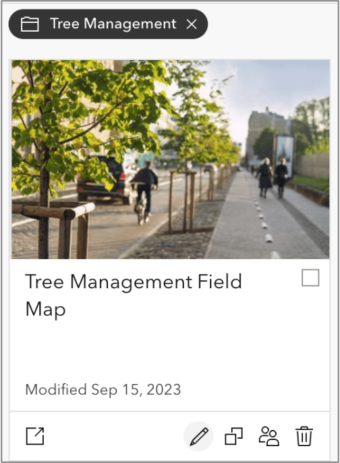

When a folder is chosen, an ornament will appear indicating that the list of maps has been filtered by folder. Clicking the x will remove the filter and return the author to their My maps list.
Map card ornament indicates folder

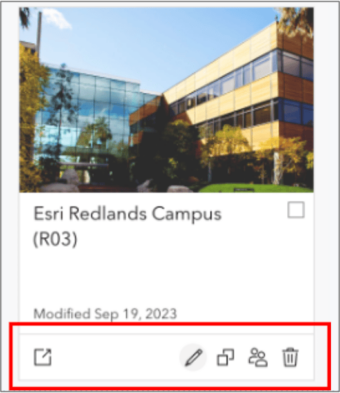

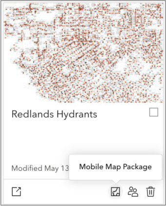

Map card indicators
From the Maps page, each map is displayed as a card in grid view or a row in table view and there are a set of actions and capabilities shown:
  • Actions include: Configure, Duplicate, Edit Sharing, and Delete.
  • At a glance, indicators represent the map’s capabilities (Editing or Read-only, Mobile Map Packages).
Indicators represent capabilities of a map
You can use these new indicators to quickly discover the capabilities of a map.

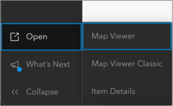

Open Map Viewer
When configuring a map for field use, you may need to open the Map Viewer and make changes beyond what is available within Designer itself. Opening the Map Viewer directly from Designer ensures edits made to a map never get out of sync – a common occurrence if multiple tabs or browser windows are used.
Access to the Map Viewer is now available from the action bar where previously it was only accessible from the Overview page.
Easy access to the Map Viewer
Opening in Map Viewer Classic may be available depending on your organization’s settings. From the Open menu, you can quickly access the map’s Items Details so you can modify additional properties.

Mobile Map Package support
Field Maps Designer now supports viewing as well as limited configuration of mobile map packages.
New support for Mobile Map Packages
On the Overview page, you’ll now see additional details including the size and number of downloads for a mobile map package.
From this page, you can:
  • modify the thumbnail.
  • change the name of the mobile map package item.
  • update the description.
Update Mobile Map Packages
From the Sharing page, you can:
  • modify how the map is shared.
  • generate a link and QR code.
  • exclude from display in the Field Maps mobile app.
Mobile map packages are created using ArcGIS Pro. Map capabilities are contained within the package and most configuration requires re-packaging the map.
