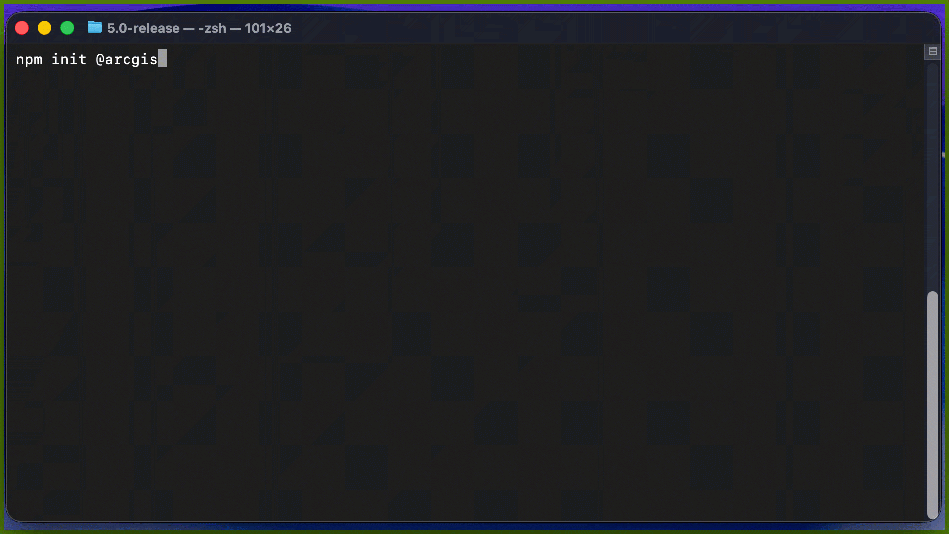

To try the tool right away, run npm init @arcgis or npx @arcgis/create in your terminal (full setup instructions are below).

The CLI tool works with the npm init or npx command. Ensure you have Git installed along with the latest LTS version of Node.js and npm before you begin.
Run npm init @arcgis or npx @arcgis/create to quickly set up a new web mapping application with interactive prompts.
If you’d prefer to skip the interactive prompts, there are also CLI options when using npx to specify your project name and preferred template:
npx @arcgis/create -n my-arcgis-app -t vite
