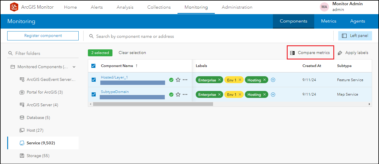

  1. Sign into ArcGIS Monitor, navigate to the Monitoring tab.
  2. Select two or more components of the same type (up to 10) from the component list. Notice that a new button named Compare metrics appears in the upper right corner of the component list.
3. Click the Compare metrics button.

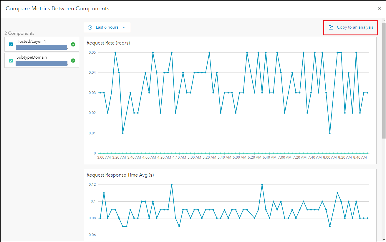

The Compare Metrics Between Components panel displays and lists the selected components on the left, with their respective metrics shown on the right. These are the metrics that are shown in the component type’s overview panel. Each component metric contains data for the selected components. You have the option to remove a component from the list if desired.
4. Click the Copy to an analysis button in the upper right corner, to make a new analysis view of the reported metrics.
5. In the next panel that appears, you have the option to create a new analysis view or add the metrics to an existing analysis view.

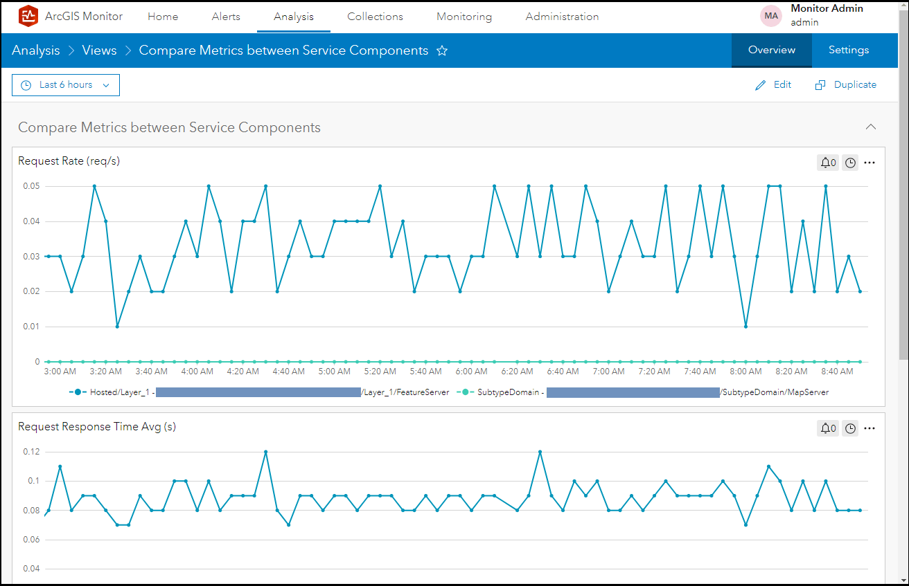

6. Navigate to the Analysis tab, select the analysis view where the new metrics were added.
The elements in the analysis view can be modified and edited like any other element. This compare metric data capability is documented in this ArcGIS Monitor help topic. This new workflow can make it easier for you to easily create new analysis views comparing metrics of similar type components.
