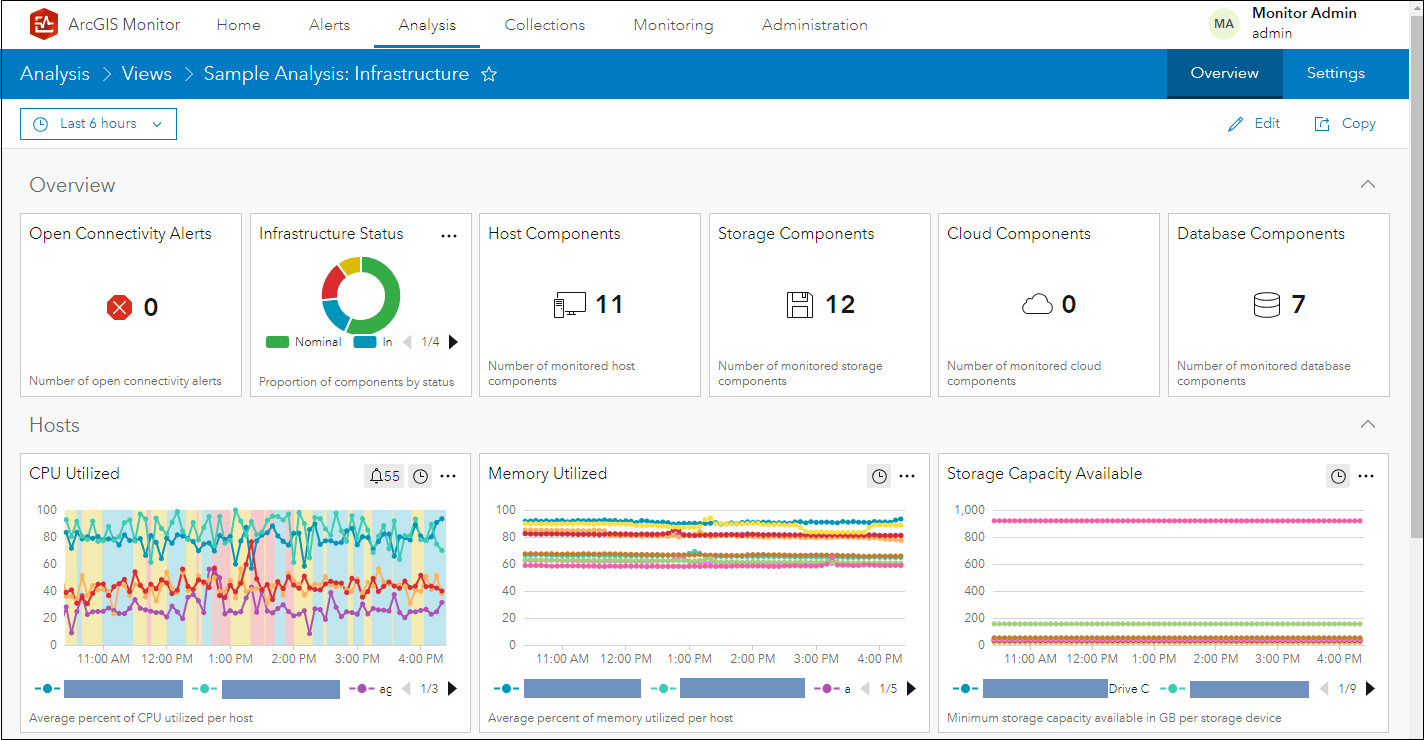

New Analysis view samples
To help new ArcGIS Monitor users get started, two analysis view samples are installed with the Monitor 2024.0 release. The Sample Analysis: ArcGIS analysis view is designed to show key performance indicators (KPIs) for ArcGIS Server and Enterprise portal components. The Sample Analysis: Infrastructure analysis view contains KPIs for host machines that participate in an enterprise GIS deployment. Both analysis views can be customized or admins could duplicate and modify the analysis view copy to meet their organization’s reporting needs.
Figure 8: Sample Analysis: ArcGIS and Sample Analysis: Infrastructure analysis views.
