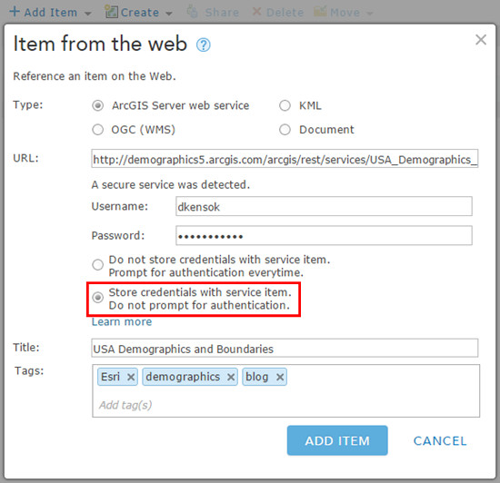

1. Create a map layer with your stored credentials and share with everyone
You will first need to create a new map layer with your stored credentials and share with everyone. Here are the specific steps:
Map Service URL in the Item Description for 2015 Median Household Income Layer
Create Map Image Layer with Stored Credentials
Limit Usage from Authorized Websites to Control Credit Costs
