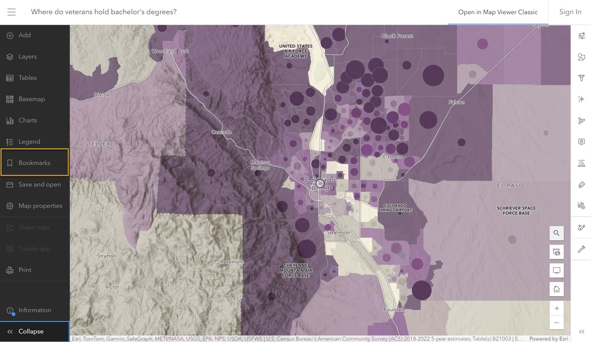

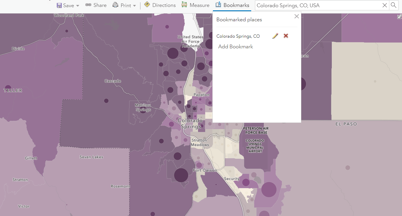

To start, add bookmarks of your desired locations in your web map. For example, here I have a map titled Where do veterans hold bachelor’s degrees? I have five cities that I want to focus on within my story. Using the search bar, I can view the map centered on Colorado Springs, my first focal city. Then I can add a bookmark to save this location by opening up the Bookmarks pane.

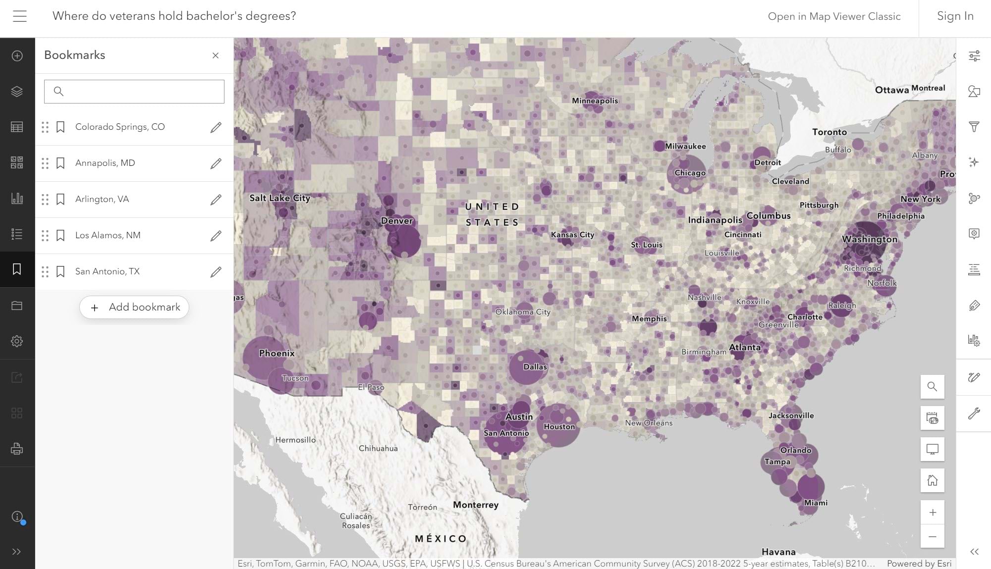

I did the same thing for the other four locations on my list: Annapolis, Arlington, Los Alamos, and San Antonio:
For some of these cities, the result from the search bar is a little too close-up. Placing my map to where I wanted it involved zooming out slightly, and panning over just a bit to get the best placement. Saving this in a bookmark saves this exact extent of the map, allowing me to revisit this without having to make those adjustments again. It also means that anyone viewing this map using the bookmarks will get this map extent as well.

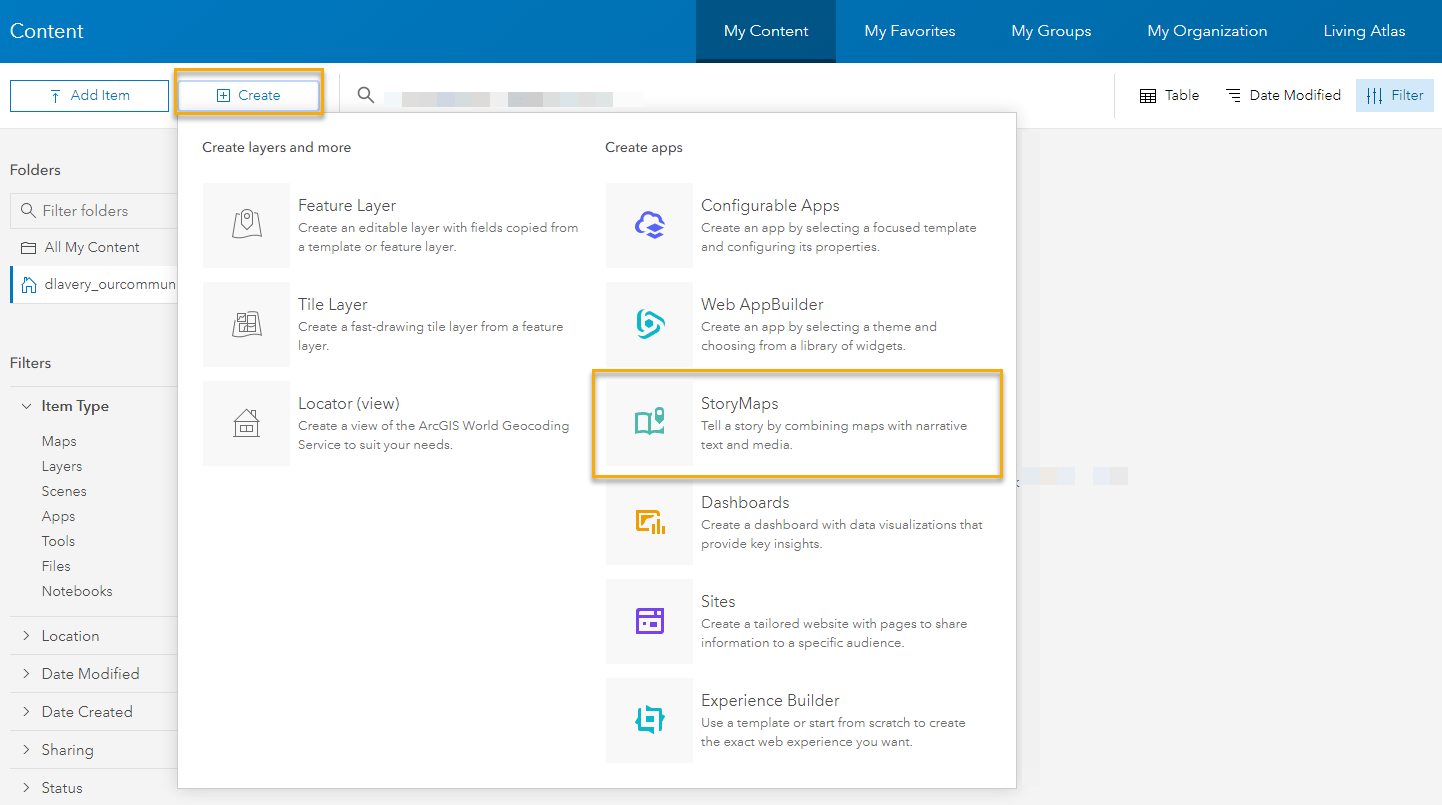

An easy way for me to go from ArcGIS Online to ArcGIS StoryMaps is simply by clicking the Create button from within My Content:
From My Content in ArcGIS Online, Create -> StoryMaps

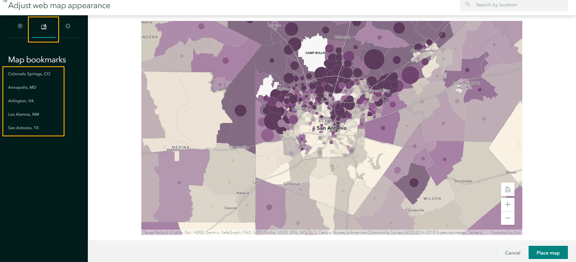

This takes you all your stories within ArcGIS StoryMaps. You can continue working on one of your existing stories, or create a new story. Either option brings you to the ArcGIS StoryMaps builder where you can edit your story. Add a web map and place the map to show your desired location. If you already did this by adding bookmarks when building your web map, ArcGIS Story Maps honors these bookmarks.
Clicking on the bookmarks icon in the middle, I see the same bookmarks that are in my web map. Here, I’ve selected to place my map in San Antonio for this portion of my story. I can take advantage of the bookmark I already placed when building my map.
Working with the map's settings within ArcGIS StoryMaps, bookmarks set on the web map are visible here to help you place your map.

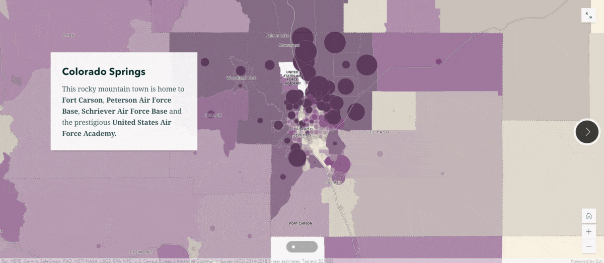

I added this map to my story in-line with the whole cascading narrative, but this also works in sidecar and slideshow blocks within ArcGIS StoryMaps. For example, here’s a slideshow block I created with the same map highlighting three other locations that I had bookmarked: Colorado Springs, Annapolis, and Los Alamos.
A carousel through 3 of my focal locations using the Slideshow feature in ArcGIS StoryMaps.
