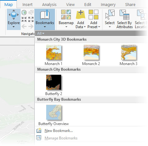

Access bookmarks from the bookmark button on the ribbon.
Use bookmarks to save your favorite or frequently-used map extents. They’re stored with a title and thumbnail in the Bookmarks drop-down menu.

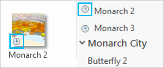

Bookmarks can also be temporal. If you have time-enabled data, you can create bookmarks at specific points in time. For example, if you have data that tracks the migration of monarch butterflies across North America, you can create a bookmark showing the butterflies’ location mid-migration and return to it anytime. Temporal bookmarks display with a clock icon in the thumbnail and next to the bookmark name in a list view.
Temporal bookmark displays with a clock icon.

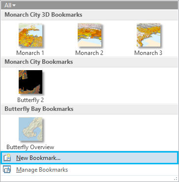

2. On the Map tab, click the Bookmarks drop-down menu, and click New Bookmark.
Click New Bookmark

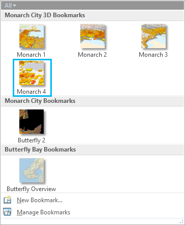

4. Click the Bookmarks button to see your new bookmark and other bookmarks you’ve created in that map or other open maps in the project.
View your new bookmark
5. Click any of the thumbnails in the Bookmarks menu to go to that location.

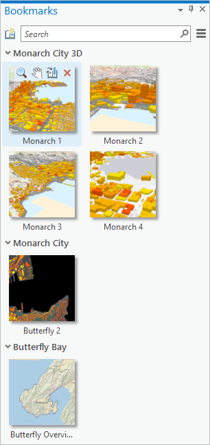

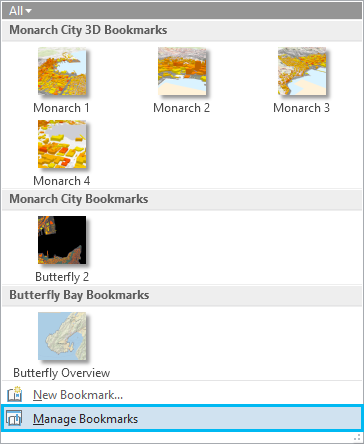

If you want to modify your bookmarks, open the Bookmarks pane. On the Map tab, click the Bookmarks drop-down menu and click Manage Bookmarks.
Click Manage Bookmarks Bookmark Manager
In the Bookmarks pane, you can do any of the following:
  • Reorganize your bookmark list.
  • Update the location of your bookmark with the Update button.
  • Create new bookmarks.
  • Rename or delete bookmarks.
