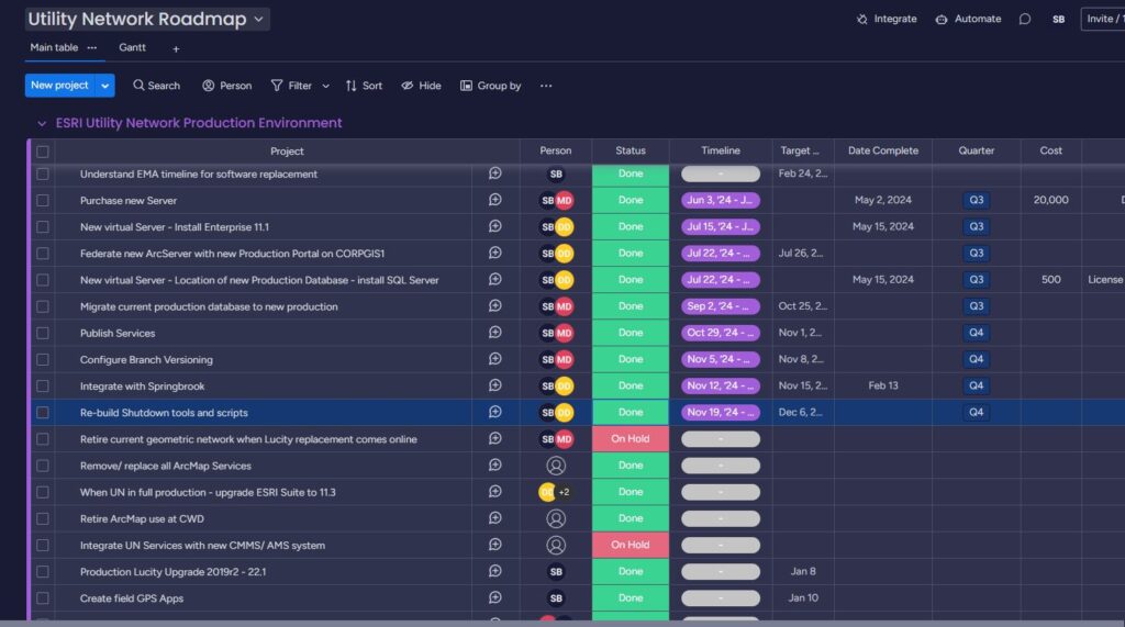

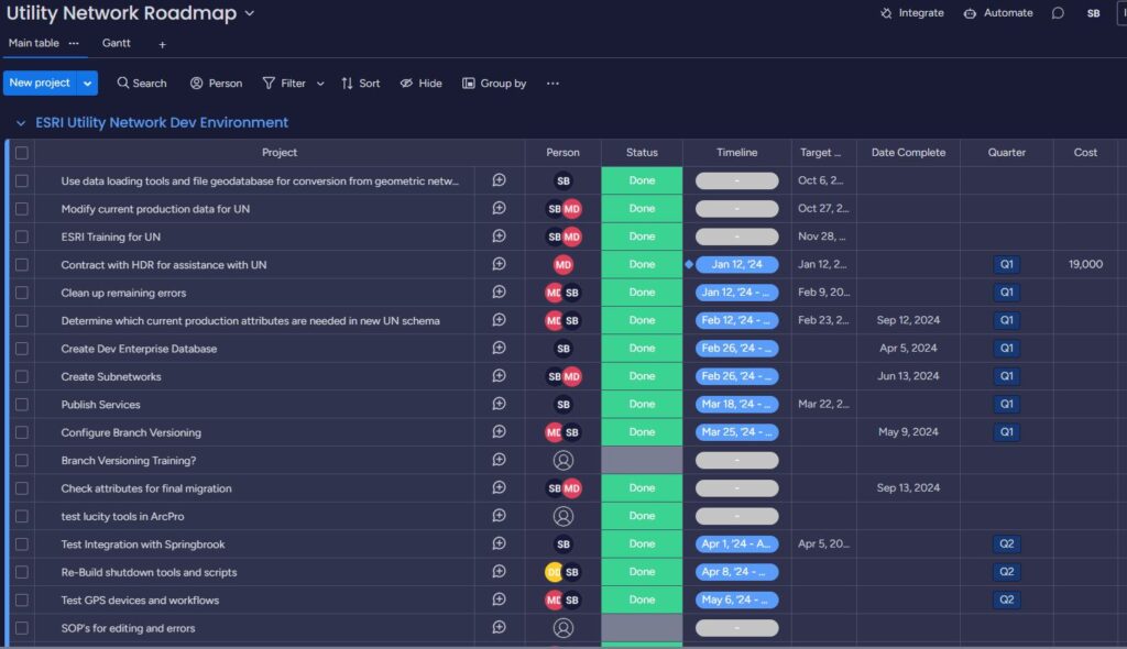

In 2023, the district embarked on implementing ArcGIS Utility Network. GIS professionals deployed ArcGIS Enterprise 11.1 to its DEV environment (today they are using 11.3) and began to research and learn as much as possible about ArcGIS Utility Network. Staff met with other utilities and took Esri training on ArcGIS Utility Network before developing a road map to complete the project.
Road Map of Milestones to Complete ArcGIS Utility Network Implementation Developed by Covington Water GIS Staff

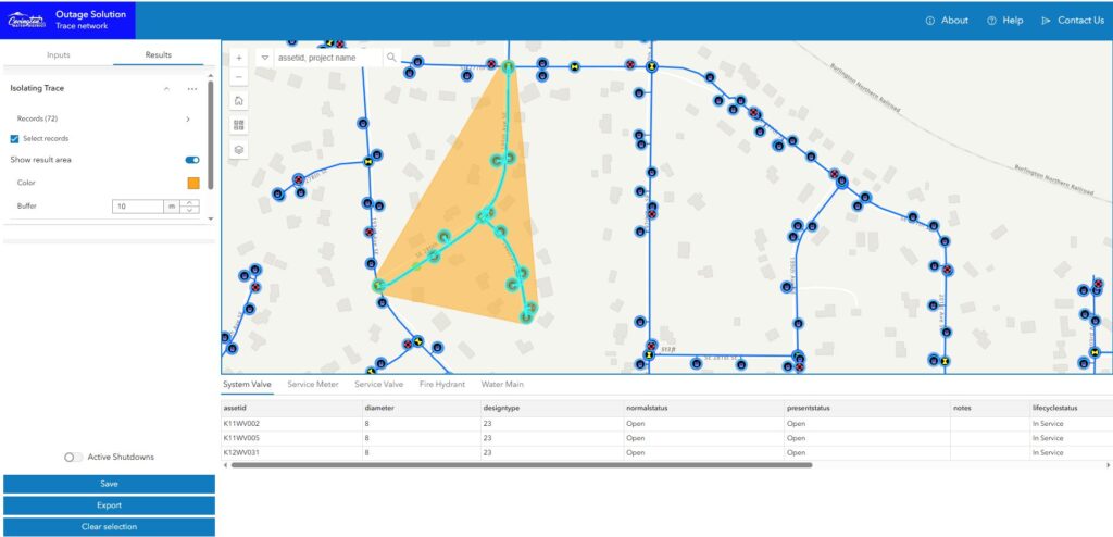

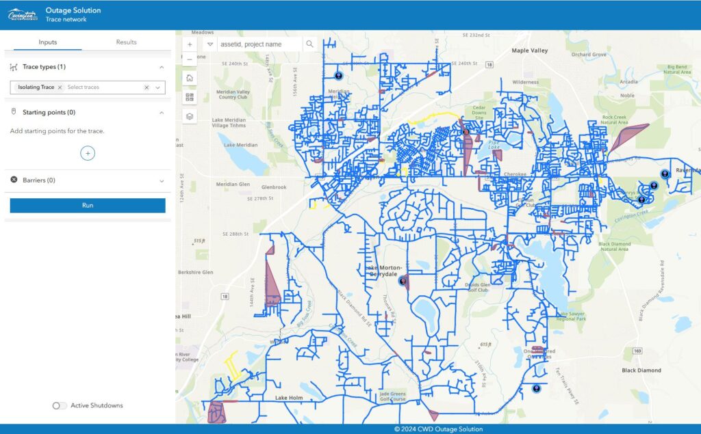

The district employs a part-time software developer, Dan Dulan, to solve some of the most challenging data problems in-house. Previously, the district had relied on the Water Outage solution built by Esri for the geometric network to communicate water outages across the organization. The district had made enhancements to this tool to email notices of outages and create lists for customer notifications. This tool has seen wide adoption across the organization, and abandoning the tool was not an option.
Rebuilding the tool was essential to the Utility Network migration and had to be created from scratch using the ArcGIS API for JavaScript. Over a year was spent developing the solution. The tool now uses the tracing capabilities of Utility Network, bringing enhanced efficiency to communicate to internal and external stakeholders regarding water outages. The district would not have been able to go live with ArcGIS Utility Network without this critical application.
Screenshot of New Outage Solution Tool

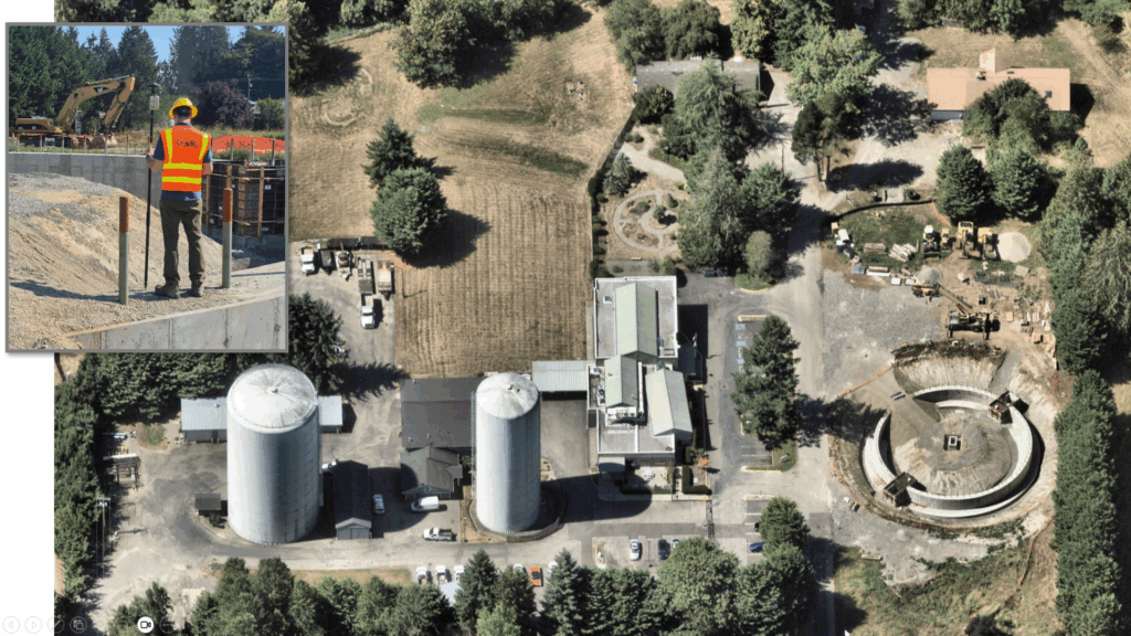

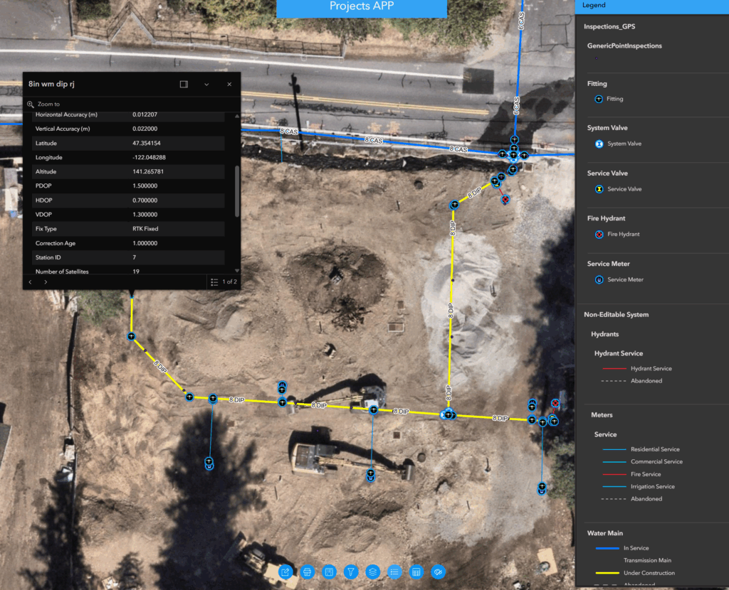

The district uses GPS extensively, managing projects with the satellite-based mapping technology in the field. As Mike Velasco says, “It’s the birth of an asset. It’s how we keep our asset registry current.”  Inspectors and operations staff members collect GPS data on new pipes and other assets as they are installed in the ground. As the data is collected, GIS staff input the new assets into the asset management system and build dashboards to assist the organization with the financial closeout process.  Utilizing GPS in this manner has taken many years to develop but has had many positive effects on interdepartmental communication and collaboration.
Covington Water Projects App Used by Inspectors to Access GPS Points

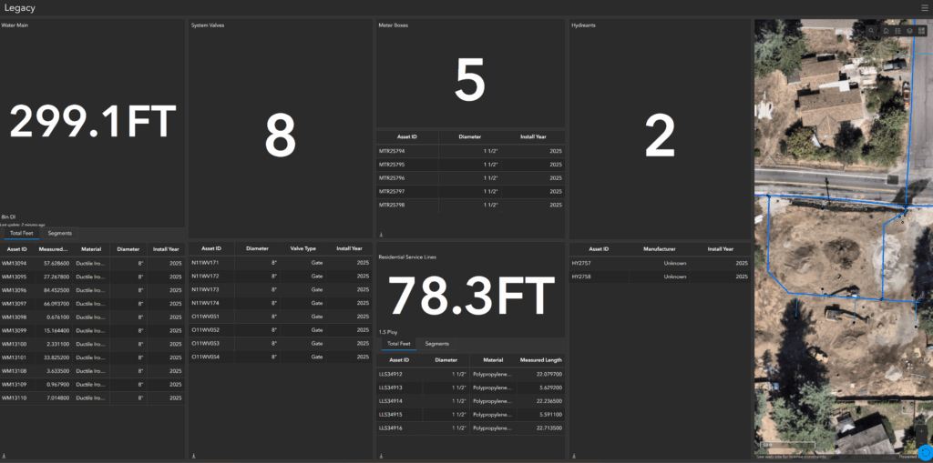

Example Dashboard Created to Manage Projects, Assets, and Closeouts (This image represents the data from the project above.)

A Worker Using a GNSS Receiver Paired with ArcGIS Field Maps to Collect Points on New Tank Construction Project (Image Showing New Tank Construction and District Headquarters)
