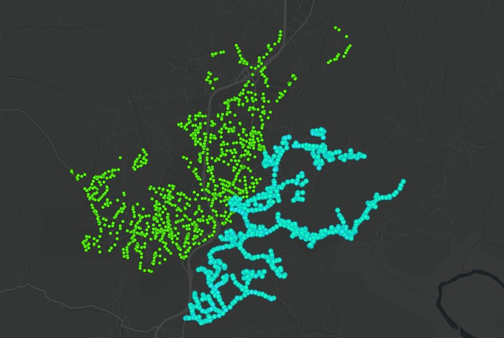

In 2017, the sanitary board acquired the rural Arbuckle sanitary network from a local public service district (PSD). The inherited system, which now represents just under half of the board’s total service area with one-third of the system’s total manholes, is a little different from the urban system. The Arbuckle sewer infrastructure sprawls across steep wooded hills and gravel roads and beneath dense canopy—conditions that make both maintenance and mapping extremely difficult.
The Arbuckle sewer system (represented above by the blue dots) comprises just under half of Oak Hill Sanitary Board’s service area—about 3.71 out of 8.41 square miles. The Arbuckle system contains roughly one-third of the manholes in the system.

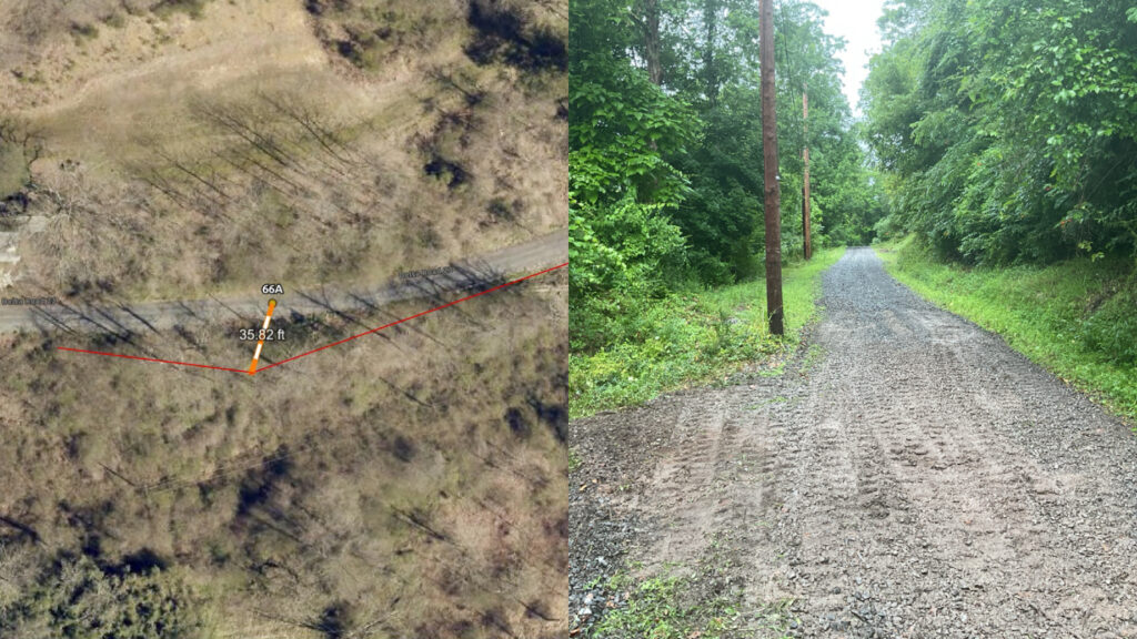

“We’ve spent days looking for manholes,” Oak Hill collections system foreman Kyle Hobbs said. “You could be out there looking in the field, in a briar thicket where you can’t see anything, and meanwhile your truck could be parked right on top of it.”
Sometimes the only solution to find a manhole was to run a camera and locator. While generally effective, this is a time-consuming and inefficient method to locate infrastructure that should be easily accessible, adding unnecessary time and frustration to daily operational tasks.
(Left) This ArcGIS screenshot shows the location of manhole 66A in the Arbuckle system. Legacy records had placed this manhole off the side of the road in vegetation, 35.82 feet away from its true location. In reality, manhole 66A is located in the road and hard to see due to gravel cover. (Right) Manhole 66A is obscured by the gravel road it lies in.

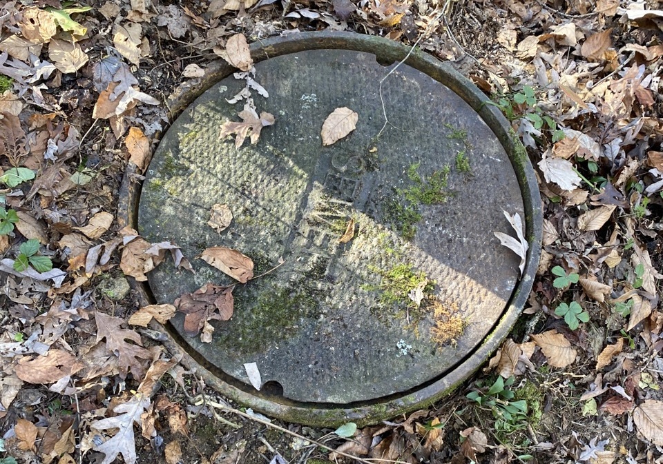

The Arbuckle network was built in the 1980s, when it was standard practice for manholes to have open ventilation. Today, such vents create infiltration and inflow (I&I)—when nonwastewater (e.g., stormwater, creek water, runoff) flows into the system. I&I adds volume, increases treatment costs, stresses the system, and increases the risk of backups.
In the 1980s, it was standard for manholes to have open ventilation. However, vented lids like this one allow nonwastewater from storms, creeks, and other sources into the system. This adds volume, increases treatment costs, stresses the system, and increases the risk of backups.

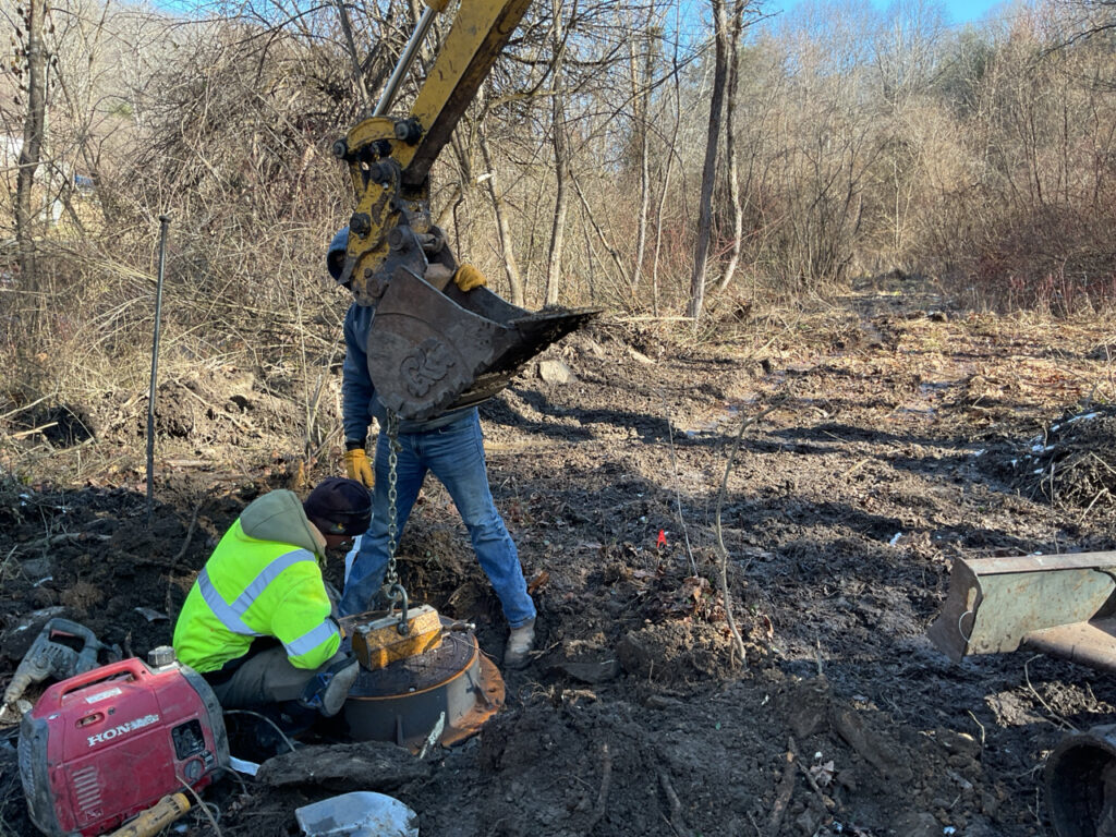

The sanitary board launched the Arbuckle Rehabilitation Project to evaluate and address every manhole’s needs. One treatment that every manhole got was replacing its lid and ring to drastically reduce I&I.
Because contractors and an engineering inspector would already be visiting all of the system’s hundreds of manholes, the city recognized a rare opportunity: to collect a complete, high-accuracy, standardized inventory of the Arbuckle network. This would allow Oak Hill to replace inconsistent legacy GIS data with a single, authoritative dataset, built for long‑term operations.

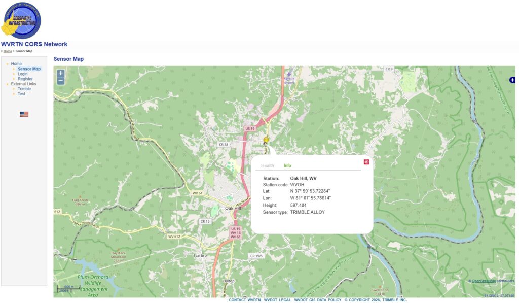

To further enhance the GIS, Bragg has also been using a high-accuracy Arrow Gold Global Navigation Satellite System (GNSS) receiver from Eos Positioning Systems. This helps him improve the location accuracy of certain infrastructure, such as critical sewer lines and underground taps. He connects the Arrow Gold receiver to the free, local West Virginia Continuously Operating Reference Stations (CORS) network for real-time kinematic (RTK) corrections, which deliver sub-inch accuracy in the city. Luckily enough, there’s even a CORS base station located right in town.
“We are lucky and blessed to have not only a state CORS network, but also that in the city of Oak Hill we have a GNSS base station right here in town,” Bragg said.

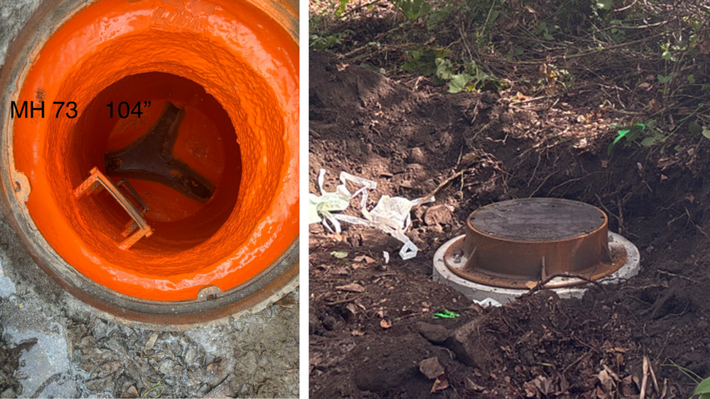

Because of staff’s experience with enhancing the GIS regularly, the city knew what type of data it wanted. For each manhole, staff wanted a high-accuracy GNSS position; at least one photo of the manhole and another of the surrounding area; and standardized attributes such as lid type, depth, number of inverts, and rehabilitation actions. Arbuckle would have the perfect dataset—making both the infrastructure and GIS future-proof.

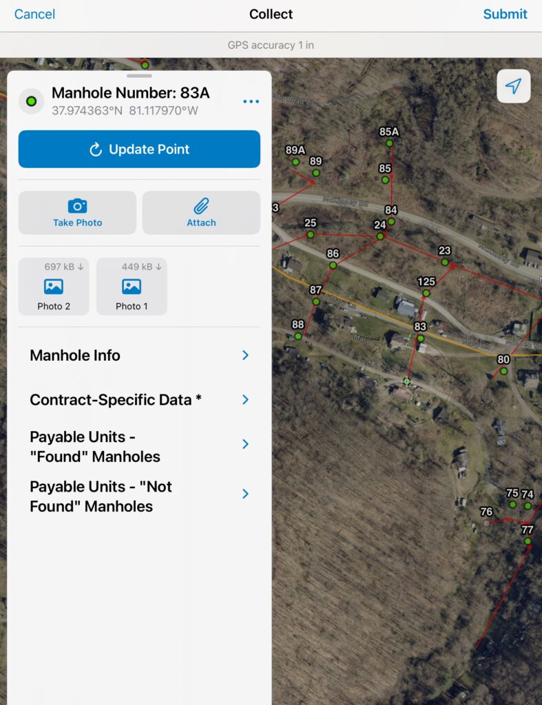

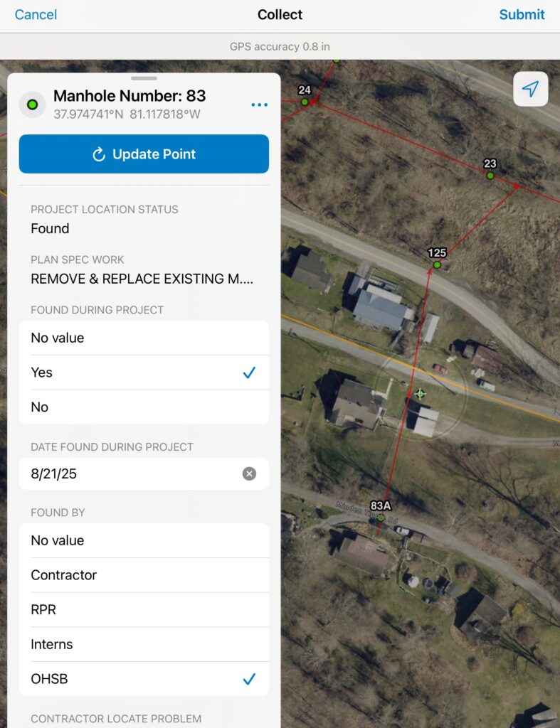

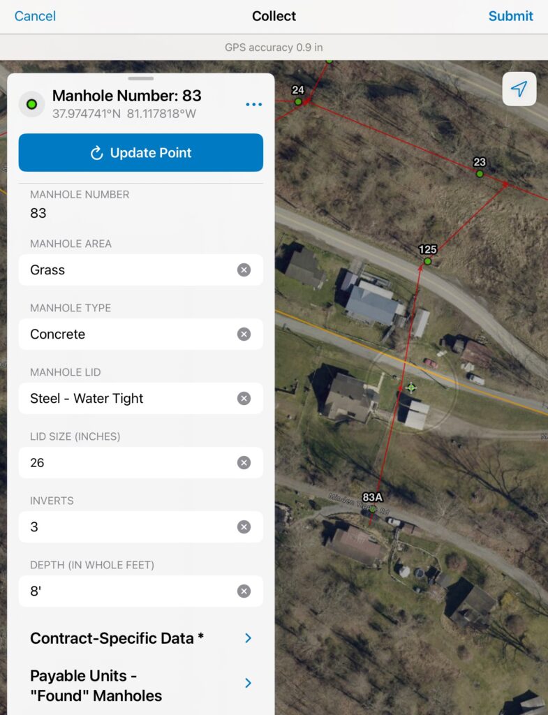

“We determined that the engineering inspector was the one who would do the data collection,” Bragg said. “The inspector would be looking at the completed manhole anyway, so we put a GPS and an iPad in his hand and asked him to take two extra minutes to collect our data.”
Bragg first created a full GIS replica of the legacy Arbuckle data so that the inspector wouldn’t edit the city’s live operational layers. This kept authoritative data protected while allowing new, high‑accuracy updates to be collected in ArcGIS Field Maps.
To streamline data entry, Bragg built a simple, standardized form for ArcGIS Field Maps. Drop‑down menus, radio buttons, photo prompts, and other required inputs meant all incoming data would meet basic city standards.

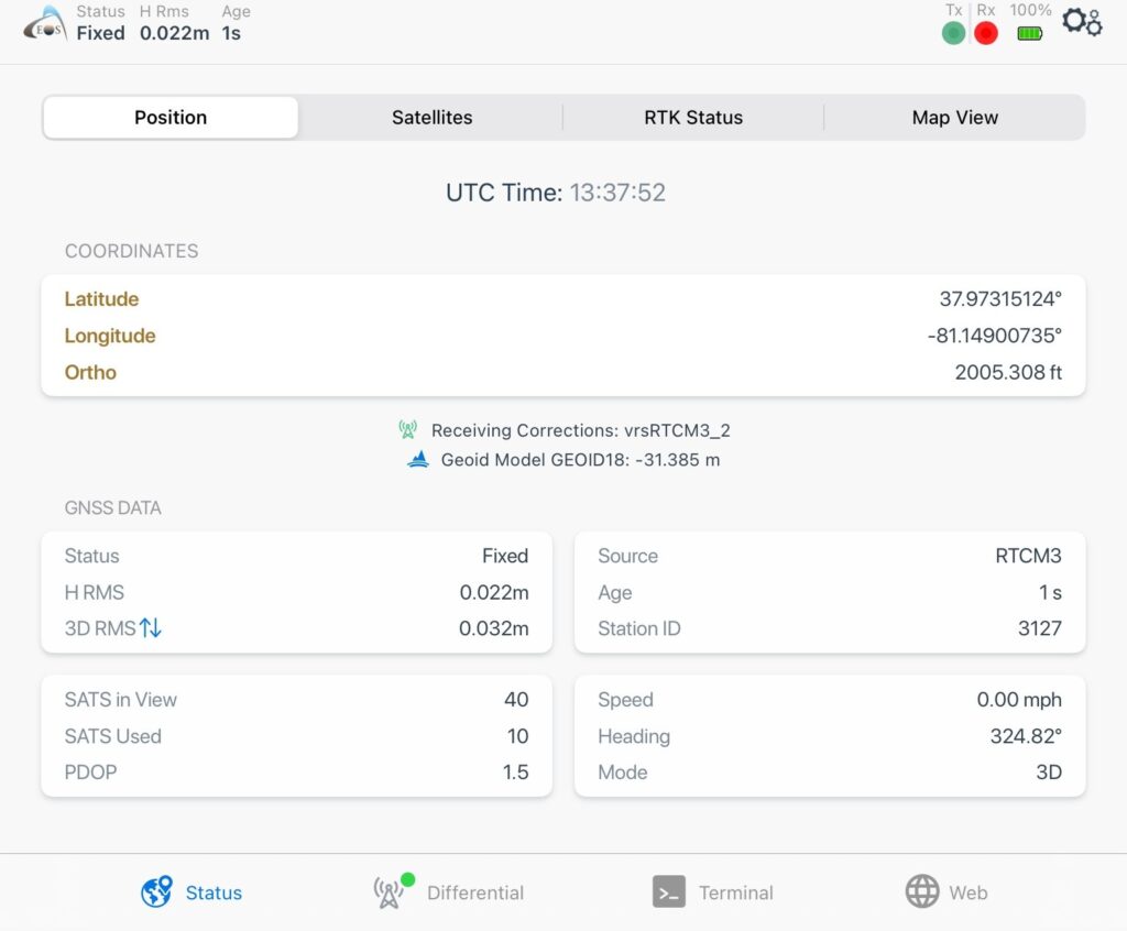

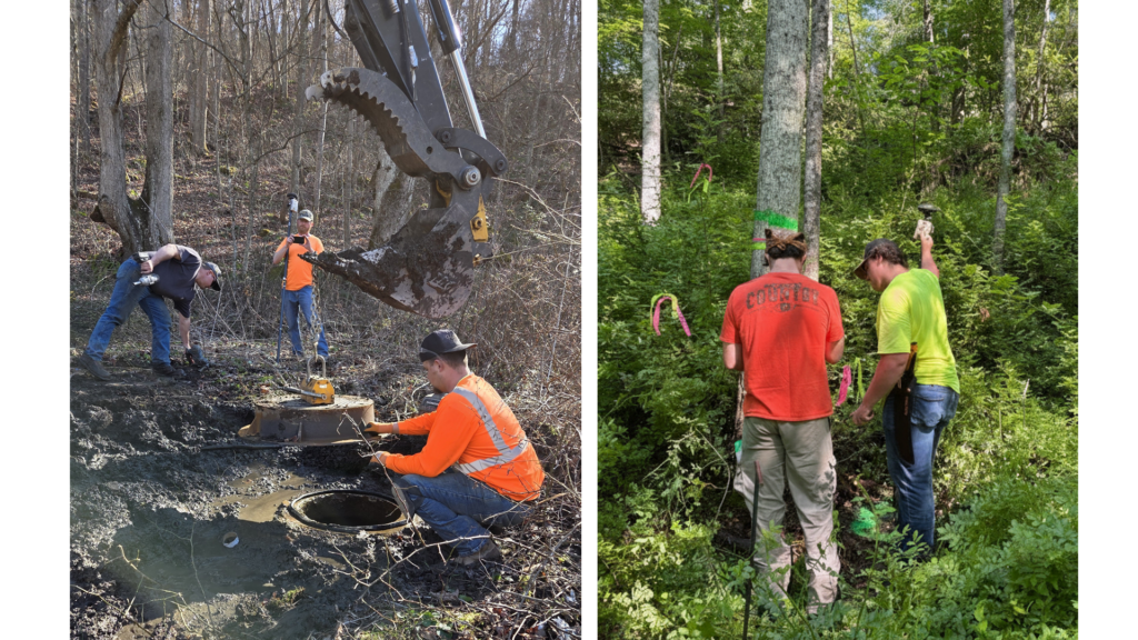

The city purchased a dedicated iPad and an Arrow Gold+ GNSS receiver, both of which would be folded into staff’s daily operations once the project ended. The Arrow Gold+ receiver connected to the West Virginia CORS network, and the proximity to the city’s base station meant no manhole in the Arbuckle system was more than three miles from the antenna. Even under challenging canopy and in deep valleys, this greatly improved the accuracy to just a few feet in the worst areas.
“When you get down into a valley, you lose accuracy pretty quickly,” Bragg said. “But with our proximity to the CORS network, it really did help with maintaining a higher level of accuracy.”
Above left: As a construction crew from Green River Group, LLC, finished rehabilitating a manhole, inspector Billy Smutko from The Thrasher Group captured information about it for the GIS. He used ArcGIS Field Maps for data collection and the Arrow Gold+ GNSS receiver with the West Virginia CORS network for high location accuracy. Above right: During summer 2025, interns Nicholas Kiser (in the orange shirt) and Matthew Buckland (in the yellow shirt) assisted The Thrasher Group with manhole rehabilitation efforts.

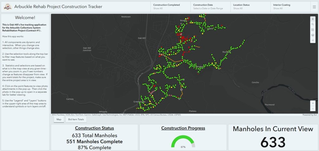

Meanwhile, Bragg used ArcGIS Dashboards to visualize construction status as data came in from the field. “Effectively, we created a live as-built drawing,” Bragg said.

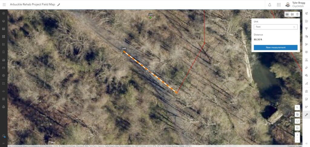

“You can see the difference between what they had in 2013 and what we have now,” Hobbs said. “The Arrow Gold+ really narrowed things in. Nothing from previous records compares.”
As Bragg put it, “Even two‑foot accuracy is better than 80-foot accuracy. If you get within two feet, you can find the manhole.”
Above: The Arbuckle system’s manhole data has undergone a major accuracy upgrade. Manhole 54B is a good example: This ArcGIS screenshot reveals the manhole’s true position in the roadway, correcting an 80.30‑foot discrepancy from the old dataset that had mistakenly placed it as being down the road and in the vegetation.
