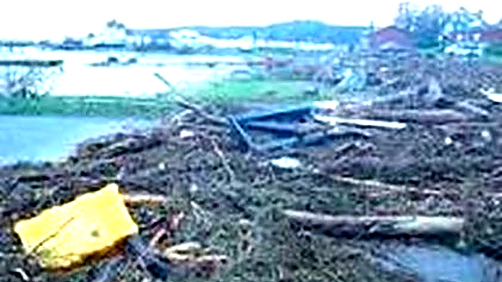

In November of 2023, Denmark experienced one of its most severe storm surges on record. To reduce risk, N1 needed a way to precisely identify which network assets were at risk of inundation and act before the flooding reached critical levels. Traditional monitoring tools alone couldn’t provide the real-time spatial insights needed to proactively manage this threat.
The November 2023 storm surge created havoc along the Jutland coast.

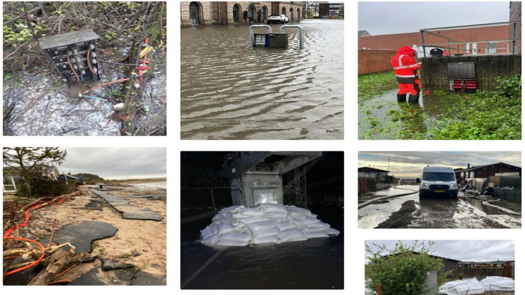

Before and during the storm surge, N1 had many technicians in the area who, before the analysis tool was developed, drove around and physically inspected the installations. This time-consuming process could result in extended customer outage.

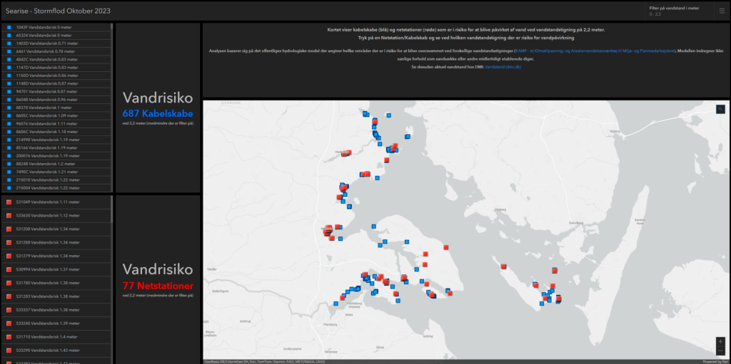

Working with GIS partner and Esri Distributor Geoinfo A/S, N1 developed a data-driven situational awareness and response tool using ArcGIS in less than 24 hours. The solution integrated hydrological flood-risk maps showing potential inundation areas at various water levels (publicly available datasets). The GIS team also leveraged ArcGIS Utility Network and asset data, which contains the locations of all cable cabinets, transformer stations, and grid equipment. Finally, they crafted a custom dashboard and analytics workflow that visualized risk exposure in real time for N1’s control center.
ArcGIS Dashboards was a key tool for analyzing storm-surge-damaged assets.
By combining multiple spatial layers, the tool continuously evaluated how rising water levels would affect specific network assets and displayed the results in an intuitive ArcGIS interface.

The solution indicates which areas are at risk of flooding at different water levels using ArcGIS, which contains location data for N1’s entire network of cables, as well as all cable cabinets and transformer stations. Therefore, N1 could continuously predict which locations and equipment were at risk of flooding and preemptively disconnect the equipment before the water masses reached a critical level. N1 proactively de-energized 410 cable cabinets based on forecasted risk. Only 15 of those shutdowns were due to actual inundation issues, meaning the majority were correctly predicted. Just 3,000 of approximately 800,000 customers experienced power outages, and most had service restored within a day. Financial and reputational risk was dramatically reduced thanks to real-time spatial decision support.
“The new analysis tool has proven invaluable in our preventive efforts, enabling us to strategically deploy technicians for patrols and perform network disconnections during the storm surge. As a result, the number of customers affected by power outages was minimized, and the subsequent restoration work turned out to be far less extensive than anticipated.” – Mads Norsted Sørensen, Senior Manager in N1’s Operations Center.
