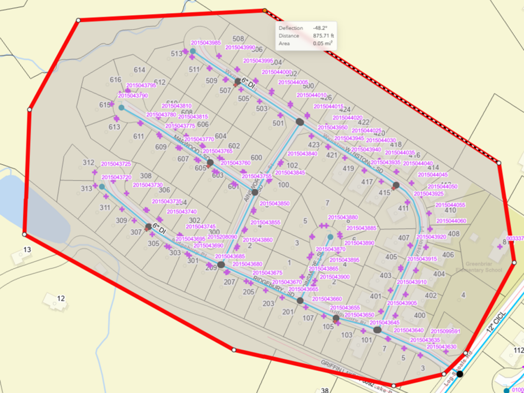

The workflow began in a web GIS application, where staff manually selected the customer accounts they believed would be affected by the planned outage (Figure 1). While this approach worked well for straightforward repairs, accurately identifying affected customers became increasingly difficult as outages grew in both size and complexity. Selecting too many customers resulted in unnecessary notifications, while missing affected customers meant some customers could receive no advance notice of a planned outage. Once the selection was complete, the customer list was exported to Microsoft Excel.

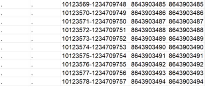

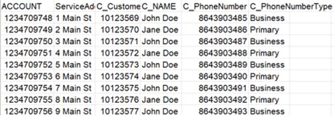

The exported spreadsheet then required extensive manual formatting before it could be imported into the IVR platform. Staff removed unnecessary fields, added required columns, corrected data types, deleted records without phone numbers, and reformatted telephone numbers to meet the platform’s import requirements. These manual steps added unnecessary complexity and were particularly cumbersome when performed on a mobile device during after-hours emergency repairs.

Figure 1: Before implementing Esri’s ArcGIS Utility Network, staff manually selected affected customers in a web GIS application and reformatted the exported data in Microsoft Excel before creating an IVR notification campaign. The process was time-consuming and became increasingly inaccurate for larger or more complex repairs.

Before migrating to ArcGIS Utility Network, staff identified potentially affected customers by drawing a selection polygon around the anticipated outage area. The selected customer account numbers were then used to query the customer information system (CIS) for associated phone numbers. While this workflow was adequate for straightforward repairs, it relied heavily on operator judgment during larger or more complex outages. Selecting too many customers resulted in unnecessary notifications, while selecting too few could leave affected customers without advance notice of a planned outage.

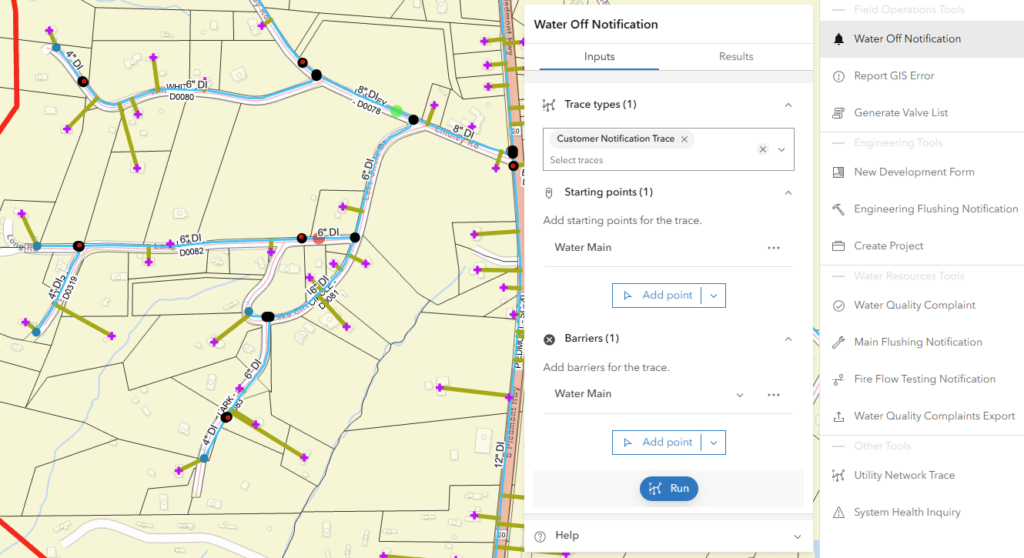

The Water Off tool is accessed directly from the web GIS application’s toolbar and launches the Utility Network Trace Analysis component. To execute a trace, the user provides two inputs: a trace type and at least one starting point. The trace type is automatically populated with the Customer Notification Trace named trace configuration, which is preconfigured to return the customer account and phone number for every customer affected by the outage.
To begin the workflow, the user selects ‘Add Point’ and places a starting point on the water main that will be isolated for repair work. The trace follows network connectivity until the selected main is isolated. If additional control is needed, users can place one or more barrier points to prevent the trace from continuing beyond a specified location. This flexibility allows staff to refine trace results when responding to complex operational scenarios.
In a standard Utility Network Trace Analysis workflow, trace results are displayed for review and analysis. For the Water Off tool, however, that step has been streamlined. Instead of displaying the default results panel, the application automatically opens a custom Water Off form as soon as the trace completes. A separate Trace Analysis tool remains available elsewhere in the application for staff who need to perform detailed network analysis outside of the outage notification workflow.

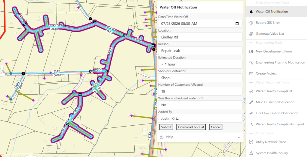

Within the Water Off form, staff enter the information that will be communicated to customers, including the planned outage date and time, the reason for the interruption, and the estimated duration of the work. These values are stored as attributes in the Water Off GIS layer and are incorporated into the automated IVR notification.
The Customer Notification Trace also returns an aggregated geometry representing the complete traced network. This geometry is used to generate a buffer polygon, which becomes the spatial representation of the outage event in the Water Off GIS layer (Figure 3). The resulting feature provides a visual record of the affected area while supporting additional GIS workflows and customer communication. “The workflow is intuitive and easy to use. What used to require multiple programs and several manual steps can now be completed in one application with just a few clicks, making it much faster to create accurate customer notifications,” said Alla Solodiak, field operations planner.
Figure 3: The aggregated geometry returned by the Customer Notification Trace is buffered to create the Water Off GIS feature. The user-defined barrier prevents the trace from continuing beyond the selected location, allowing staff to refine the affected service area.

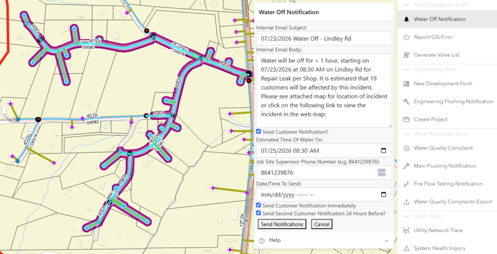

After completing the Water Off form, staff are taken to the Internal Email and IVR Notification form. The first section is dedicated to an automated internal email that is distributed to approximately 100 Greenville Water team members when the workflow is submitted (Figure 4). The email provides advance notice of the planned repair, includes a screenshot of the affected area, and contains a direct link to the Water Off feature in the web GIS application, giving internal staff quick access to the latest outage information.
A checkbox at the bottom of the form enables the Customer Notification section, allowing staff to create an IVR notification without leaving the web GIS application (Figure 4). To generate the notification, staff simply specify the anticipated service restoration time and when the IVR calls should be placed. Notifications can be sent immediately or scheduled for a future date and time.
The application also supports follow-up notifications without requiring staff to create a second campaign. When the Send Second Customer Notification option is selected, the system automatically schedules an additional IVR call to the same affected customers at noon on the day before the planned outage. This streamlined workflow reduces manual effort while ensuring customers receive timely reminders before scheduled repair work.
Figure 4: The Customer Notification section is integrated into the existing Water Off workflow, allowing staff to create and schedule IVR notifications from the same web GIS application without switching between multiple systems.
After clicking Send Notifications, staff are presented with a final preview of the IVR message to verify that all notification details are accurate before the campaign is submitted. Once confirmed, the application queues the notifications through the Twilio API and creates a new polygon feature in the Water Off GIS layer to document the outage event.
