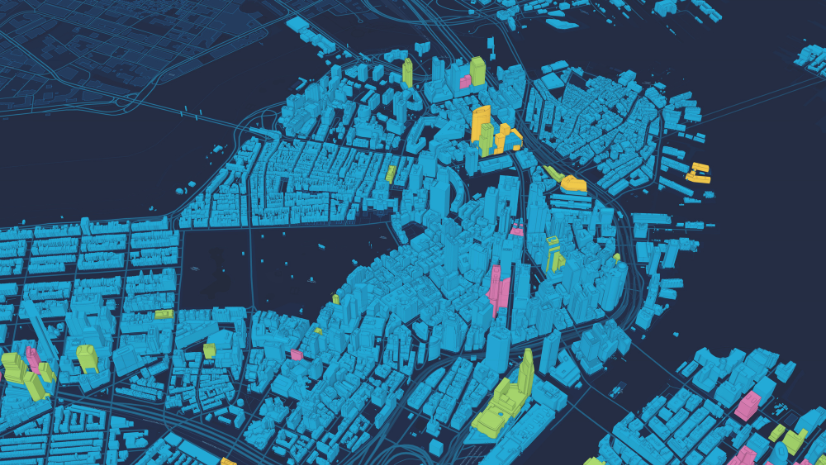

With ArcGIS Urban, I can generate suitability scores for specific parcels based on the parameters I’ve set forth in my metrics.  In this instance, I’m emphasizing the importance of proximity to transit stops by providing it a higher weight (which can be changed with the slider bars).
Once I’ve identified my most suitable locations that meet my criteria, I can automate potential developments by selecting templated building types.  Again, as the planner, I get to customize what types of developments are most important…in this case, it’s mid-rise residential.
After the developments have been put in place, I can see the results of this analysis in terms of space use, additional population, FAR, etc.
From here, I can take a more tactical approach and individually edit some of the automated developments, I can go back and revise my metrics, or I can re-run suitability analysis by changing the weights of my custom metrics.
