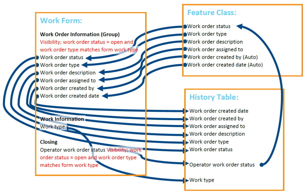

Next, the District developed a work order management system within ArcGIS Enterprise. To avoid requiring two apps in the field (e.g., Field Maps and ArcGIS Workforce), the District opted not to use Workforce, using instead feature class attributes to manage work orders. When a work order is opened on an asset, it is identified on the map with a yellow halo. This limited the system to one work order on an asset at a time. For example, if a sewer main had an open work order for cleaning, the District could not also create an additional work order for an inspection.
The work order management solution implemented by the District.
Using attribute rules and dynamic forms in Field Maps, operators can close work orders directly in the form. The form captures all relevant work order information, notes, creator, and creation date, and writes it to the work history table. Closing a work order removes the halo from the map.

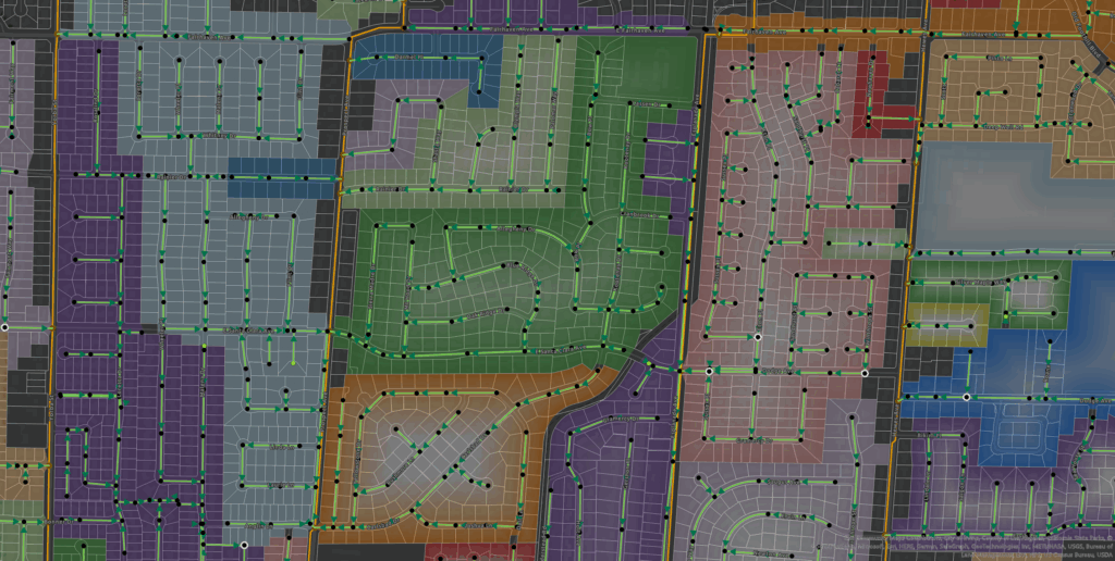

Finally, with 10 years of historical data in the geodatabase, the District had data available to build and test dashboards and reports. With direct access to the back end of the GIS and to the tools necessary to build dashboards and reports in-house, the District was able to deliver these items to supervisors and office staff relatively quickly and without interrupting operations.
The District’s wastewater drainage basins are used to manage annual cleaning.

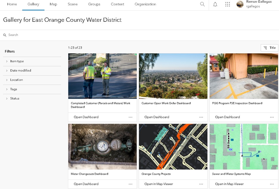

All final products, web maps, and dashboards are accessible to users through the Portal Gallery, a centralized one-stop shop for users. From this gallery, staff can easily access tools and insights to support daily operations and strategic decision-making. Team members can perform key tasks to create work orders on any asset, run reports such as meter changeouts completed in the month, and review water quality sampling results for the week. Staff can monitor metrics such as seeing work completed for the day, seeing the status of open work orders, or finding out how many food-service establishments are currently out of compliance with the Fats, Oils and Grease Management & Control Program. Staff can also reference maps that include neighboring agency information such as the county’s scheduled road work in the District’s service area. Additionally, the District can determine if they are on schedule to meet their sewer cleaning targets and access maps that have population data, soil corrosiveness data, and swimming pools in the District’s service areas.
District’s Portal Gallery: Staff’s one-stop shop for daily operations tools.
