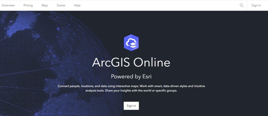

If you don’t already have an account, create your ArcGIS Online (AGOL) setup:
To create a free personal AGOL public account, navigate to arcgis.com, click “Sign In,” and select “Create an account”. Choose “Create a Public Account” (not a trial) to register via email or social login (Google, GitHub, Apple, Facebook), verify via email, and set a username/password to begin mapping.

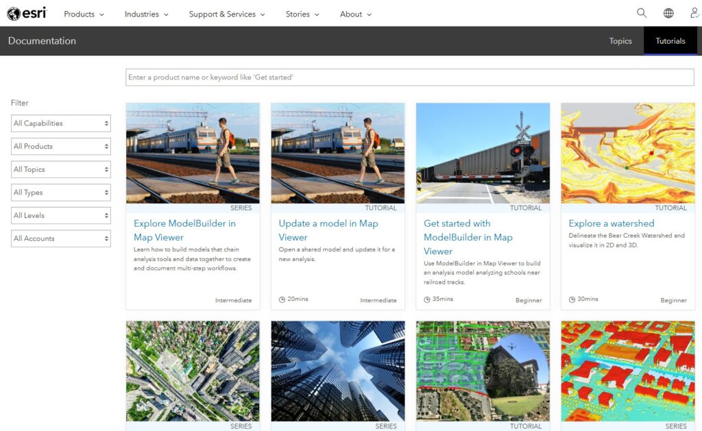

Complete a handful of foundational lessons on Learn.ArcGIS.com.

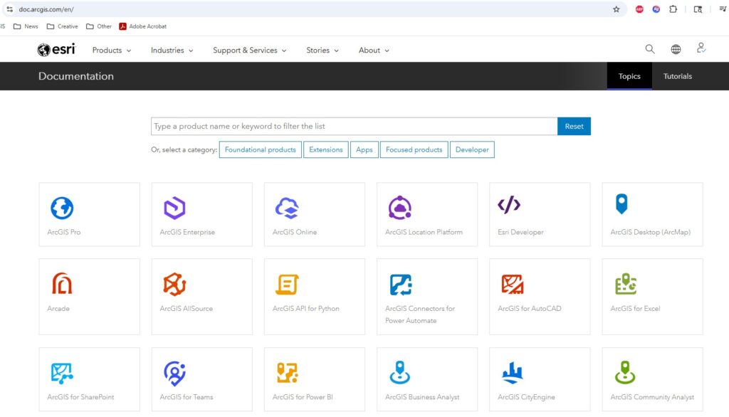

Browse our Documentation Library for subject matter of interest.

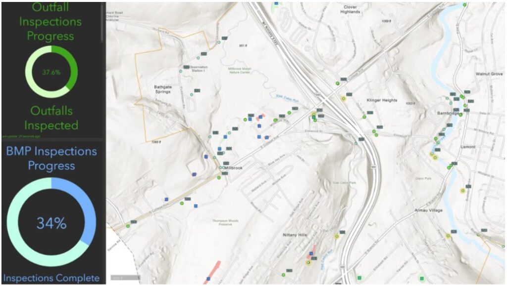

An internal dashboard for managers and supervisors to track stormwater inspection progress. https://www.esri.com/en-us/lg/product/stories/pennsylvania-dep-case-study
Recommended pattern: Use Survey123 for structured forms and Field Maps for location-based editing. Feed results into a dashboard so the office sees progress in real time.

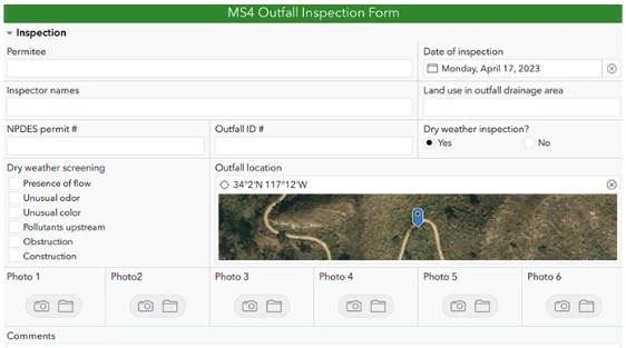

The MS4 outfall inspection form in the Survey123 mobile app. https://www.esri.com/en-us/lg/product/stories/pennsylvania-dep-case-study

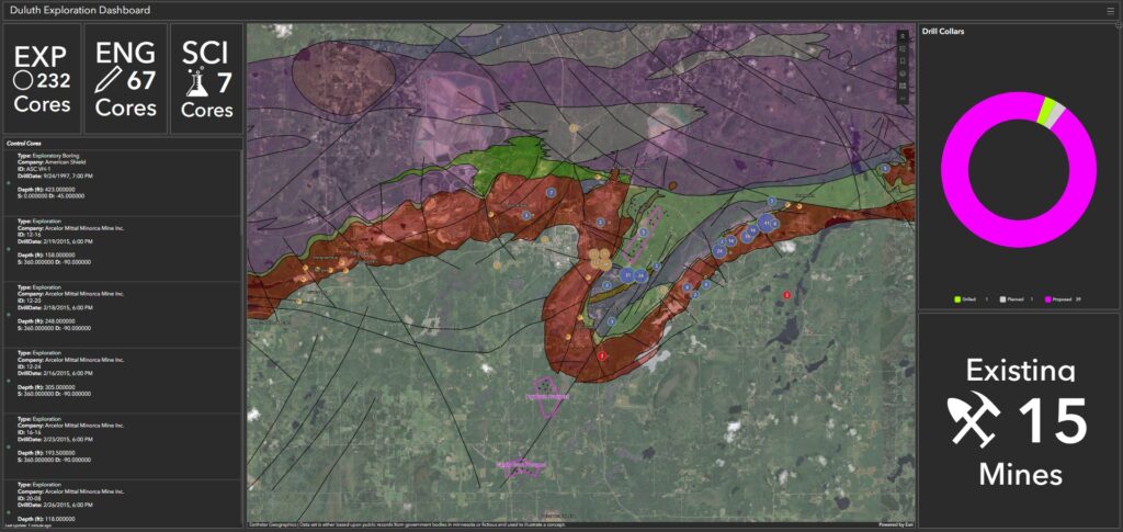

Duluth Exploration Dashboard Example (Esri.com)

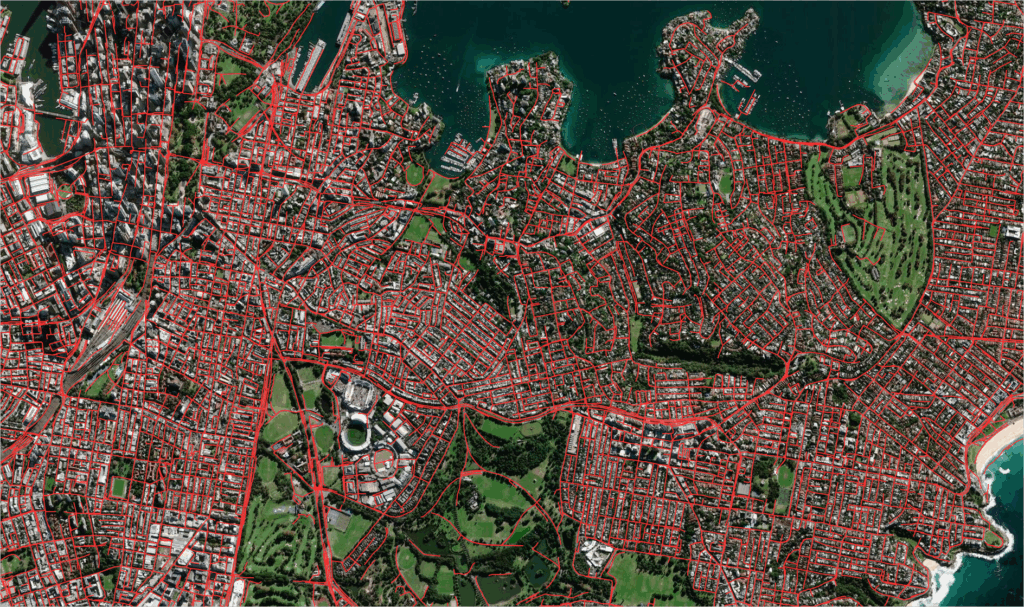

This is the result of a deep learning model that is used to extract roads from high-resolution (1 meter) aerial/satellite imagery.

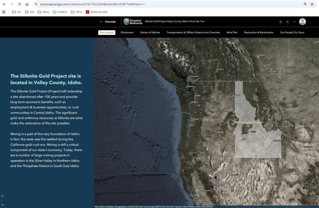

Esri StoryMap by Perpetua Resources Stibnite Gold Project in Valley County, Idaho
