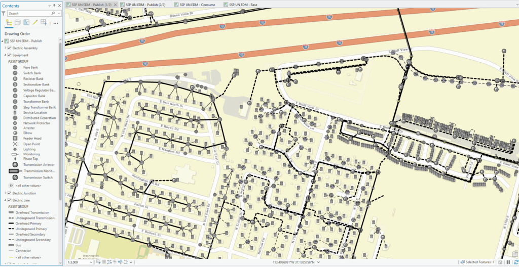

WCP decided to migrate to ArcGIS Utility Network. The goal was to enhance operational workflows, improve data accuracy, and enable integration with SCADA, outage management, and Advanced Metering Infrastructure (AMI) systems. This strategic upgrade aimed to deliver real-time network visibility and streamline utility processes across departments. Migrating to ArcGIS Utility Network enabled accurate topology and connectivity. This migration addressed the major challenges.
The new system increased productivity and improved decision-making for operational staff.
WCP partnered with SSP Innovations to implement ArcGIS Pro along with ArcGIS Utility Network using SSP Accelerate, a packaged migration solution. Starting with a solution that is 80–90% complete, WCP focused on the aspects of the migration that are truly unique to WCP.
The project was completed in under 90 days, leveraging a pre-built model tailored to electric utility best practices. SSP’s automated tools cleaned and migrated legacy GIS data, followed by rigorous QA/QC to ensure connectivity and phasing accuracy. WCP adopted SSP Productivity for asset creation and editing, streamlining workflows with context-sensitive prompts and background processing. This solution provided a scalable, user-friendly platform that reduced the learning curve and positioned WCP for future integration with AMI, SCADA, and outage management systems.
WCP data migrated to ArcGIS Utility Network schema to power the topology.
Rather than implementing the complete ArcGIS Utility Network model with over 600 fields, WCP worked with SSP Innovations to implement a streamlined version built on electric utility best practices. SSP’s automated tools were used to clean up and migrate WCP’s legacy GIS data to its new ArcGIS Utility Network solution. Further QA/QC was performed on the migrated data within ArcGIS Utility Network. WCP used the new network functionality to confirm connectivity and phasing and make necessary corrections.

WCP is experiencing dramatic improvements in switching, outage response, and data quality. Just weeks after implementing, WCP was already enjoying rapid switching procedures with enhanced validation. Before implementing ArcGIS Utility Network, WCP’s switching procedure was a manual process that involved drawing the configuration on paper, signing off on the plan, and then manually updating the GIS after implementation. There was no way to test the plan before it was implemented, and there was a lag in updating the GIS with the final configuration.
“The migration process went smoother than I anticipated. We finished earlier than expected and got to do a few more things that weren’t on the original list.” – Rick Hansen, Washington City Power Director.
With ArcGIS Utility Network, crews can model the switching plan in a new version, test the changes for unexpected de-energization, and immediately post the updates once the switching procedure is complete. What previously took several days to update in GIS can now be completed within a few minutes. Other benefits include:
